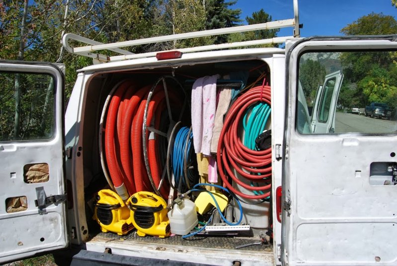

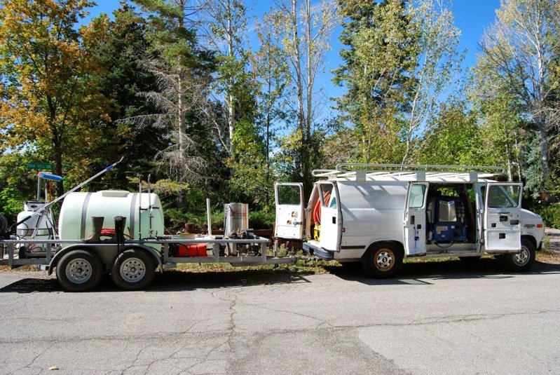

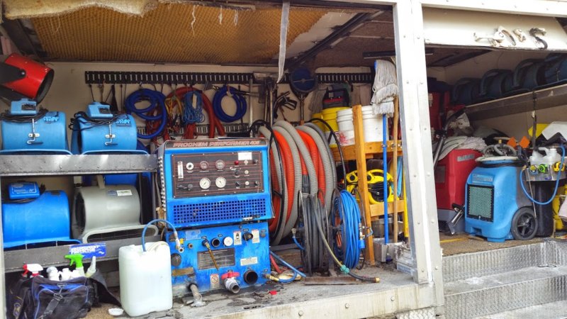

I run two wands on my truckmounts all the time, I can clean 30,000 sq. ft of carpet running my two truckmounts with two wands on each truck with two hose pullers in 8 hours. I just park one truck at one of the building and another truck at the other end. If the traffic areas look a little dingy when I am done I quickly go over it with an encap with a bonnet
