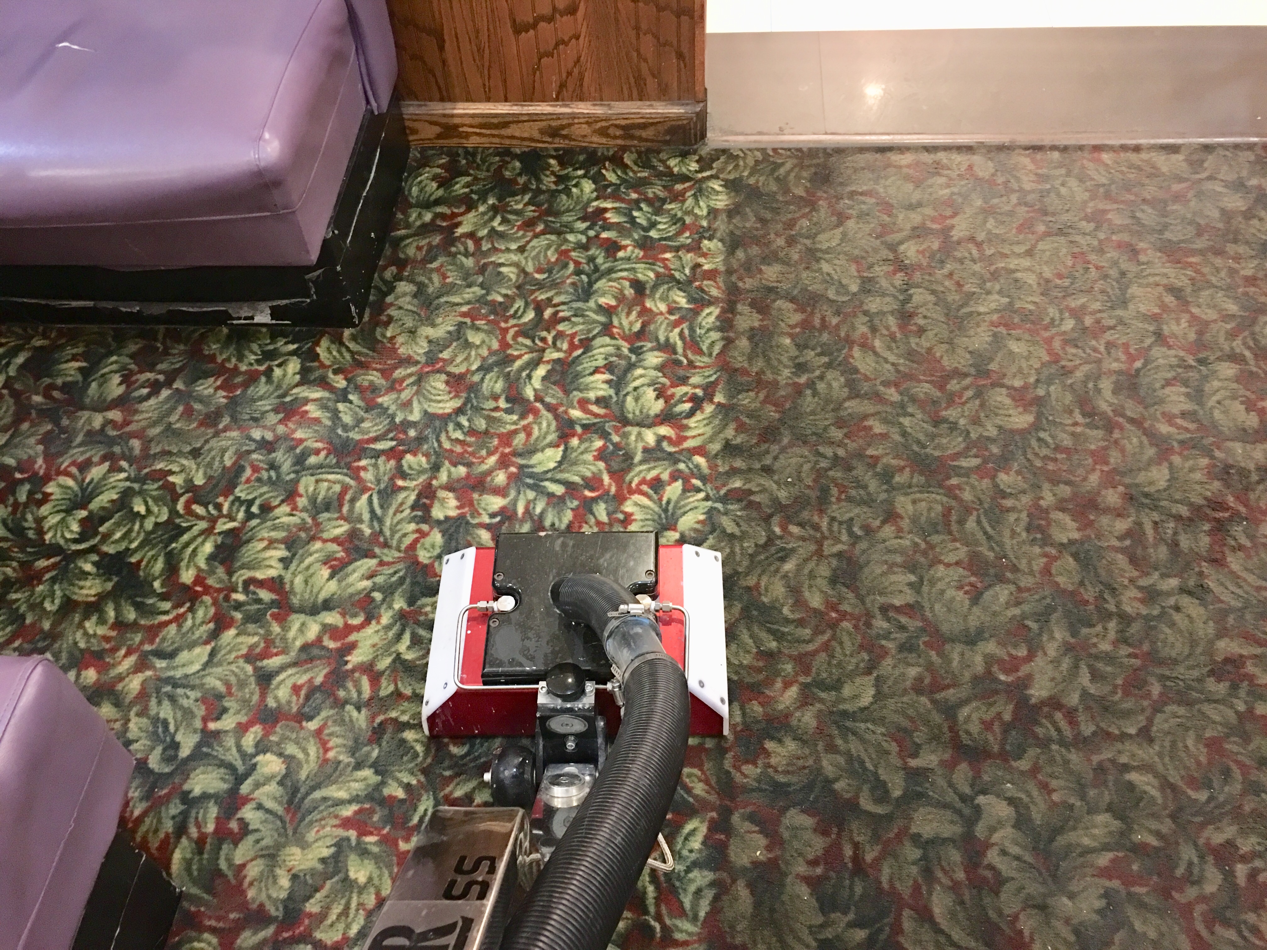

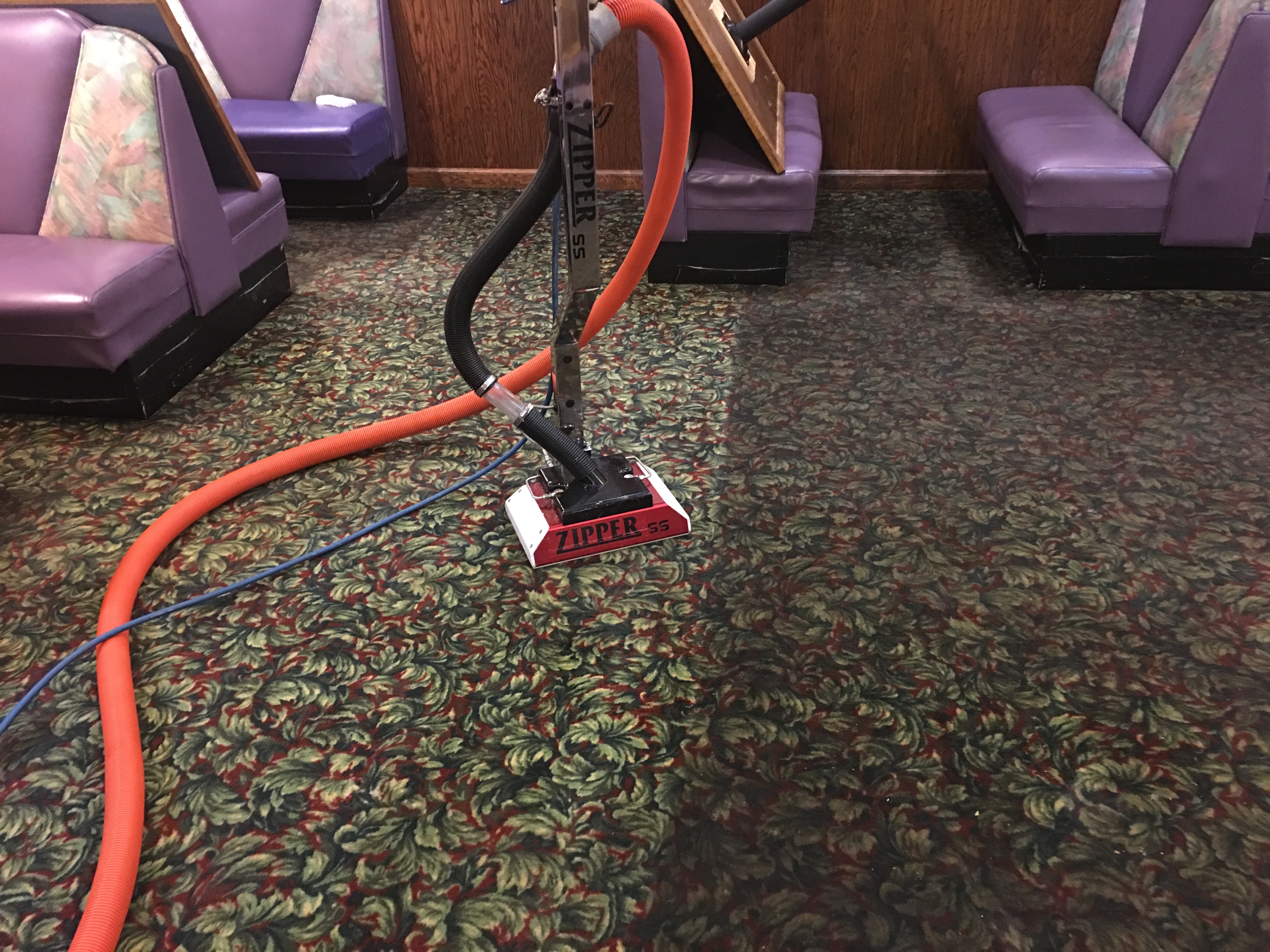

Last night we got to stretch the legs of the 870. We cleaned an extremely greasy Asian Buffet. A big thanks to my friend @TConway and his son for the assistance last night. We cleaned this carpet with Saiger Code Red mixed at 3oz per gallon and rinsed with an acid rinse. I'm amazed at how nice the place came out. Everything went pretty smooth.
The place was so greasy it killed my APO. I think the float is gummed up. You should have seen the water coming out. It was like tar.

Awesome job! Did you spray, dwell, and go or do some scrubbing. I was trying to figure out your zipper technique. Were you running 1000 psi?
24,126
Redding
Running at 1000psi. It was a little overload for Tom's wand but I needed the psi on my end. Tom made it work. If you want a confession, here it is. I didn't prescub. Saiger Code Red ate right through that gunk. We were amazed. I arrived fully prepared with CRB and 175/red pads, but we didn't need them. We got done at about 1:45am.

I have done that also with the SS - Spray, Dwell and Go others I have had to scrubb. For next time on the wand just crack the valve on the end of the hose to your desired pressure. Are you using stock jetting on the SS?
24,126
Redding
Yes. I think. Not sure

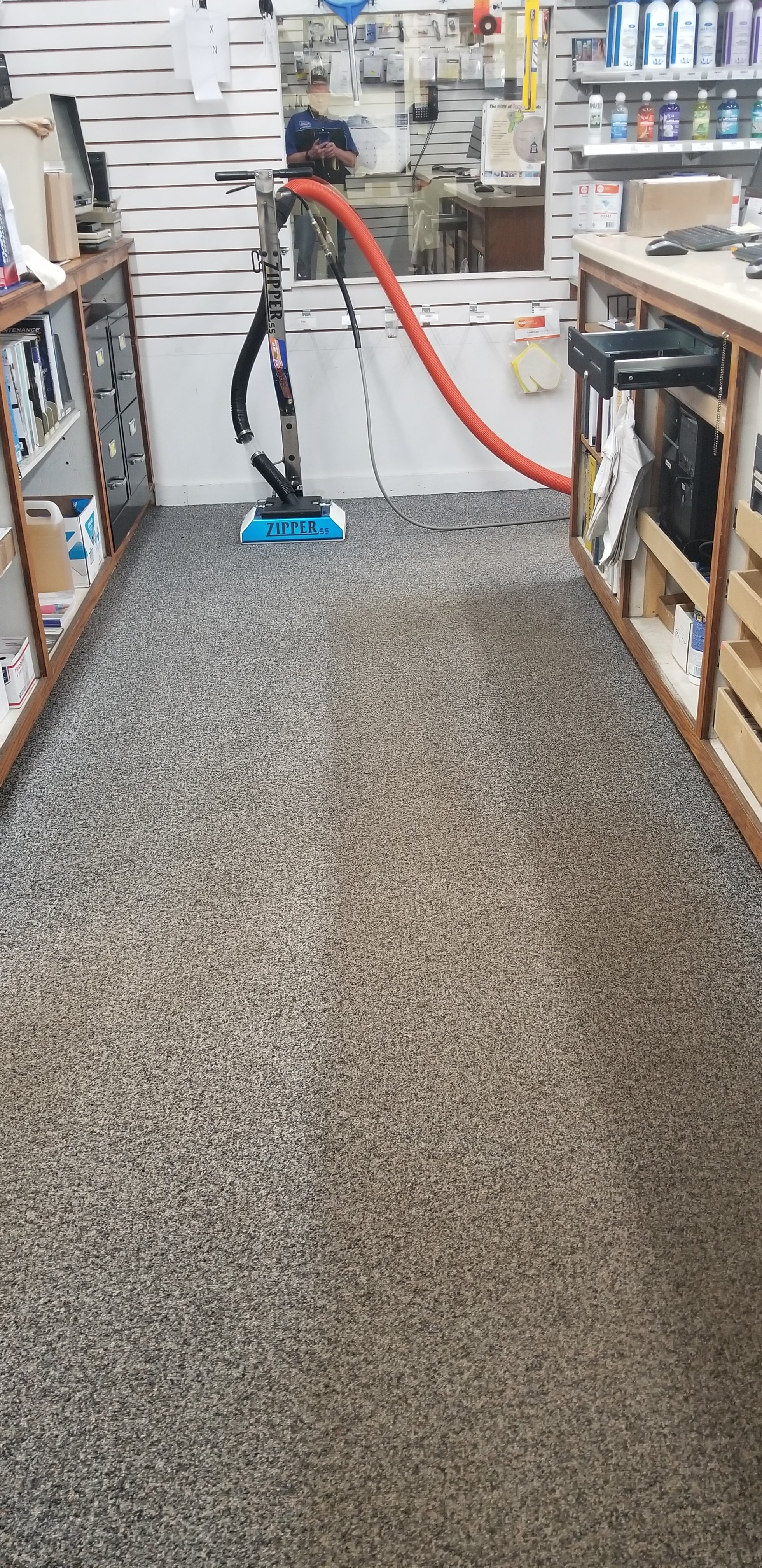

Did 2100 Sq feet cleaned once a year old marine dealership. This was at the repair facility check out counter.
I have used rotaries even in past on this area.... She's pretty beat but it responds best to the Zipper SS Super Spinner.
(Code Red with splash of GForce Booster to see if could speed up mechanics oil type soil removal)
