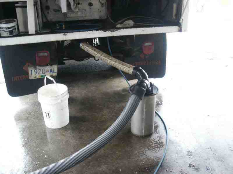

Duel Pool Filters. I got this idea from, who else, Greenie.
I works great, doesn't restrict air flow. On big jobs you have twice the filter for gunk to be collected.
This is my first time trying to post a picture, here it goes.

I am surprised Greenie said to do this..I think it was him that kept saying it restricted the flow..but 2 filters on a single line........???
shorten the hose from filters to TM for a bit more flow.
Use 2.5" from filters to TM too.
Is that a Powermatic it's hooked too?
If so, just pull the reducer off the stock vac port and you have a 2.5 vac port.
Maybe you are using 2.5 behind the filters?
I can't tell
Greenie has a Y with two 2" ports to one 2.5
edit, never mind, I see that's a Bulter.
still think you'll get a tad more if you shorten the hose from filters to TM

Its a Butler. Two Filters on one line because the pool filter's inlets are so small they restrict to much air flow. Two filter on one line opens up the airflow and spreads the debris to two filters again increasing air flow.

Are those filters pictured installed backwards or is that something new I don't know about? Seriously.
Devin Munroe
Dec 8, 2006
36
Yes they are installed backwards. The debris collects around the outside towards the back like a donut. It allows more debris with less CFM restrictions.

Why is it that everone makes things so hard....a SS filter that slides down on an inlet on the waste tank..simply pull off to spray it off...this crap ain't rocket science guys....
I'm hip to that, Devin.
I have a dual filter set up too.
Ron Werner
8,726
Ron Werner
The parallel leaf traps work, just a bugger to have to clean2 of them! Had my truck rigged with them , 3 yrs ago? some where around then.
Made a filter pail that has no restrictions and you can make it fit whatever hose you want. Just needs Greenie's expertice to tidley it up.
FastEddie
Oct 19, 2006
435
Devin, is that 2.5" hose? I also run dual filters but, you should have two hoses coming off the waste tank to each filter. The biggest restriction is at the waste tank.
