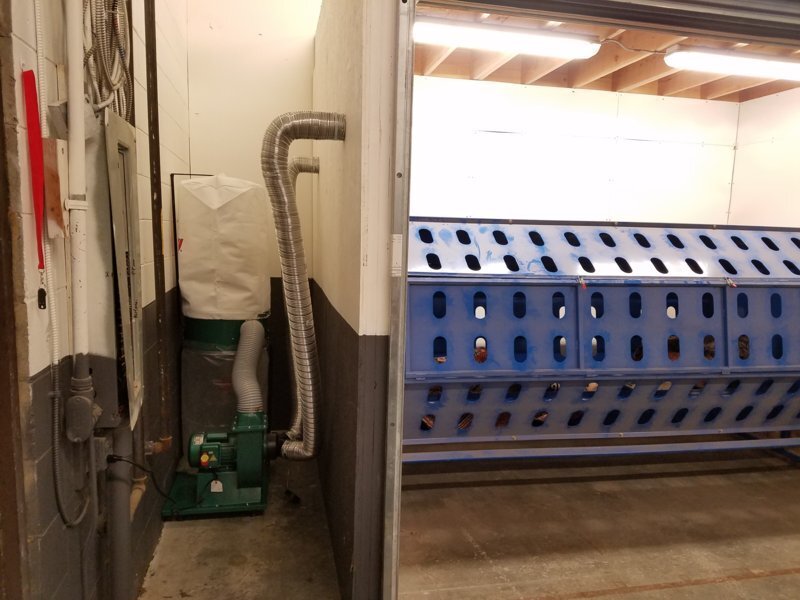

We have our's on a timer. The vac makes more noise than the tumbler. When the vac goes off, it alerts the guys the dusting is finished. I believe I posted construction of our tumbler room and vac set up in an earlier post. Do a search.
Good luck!
