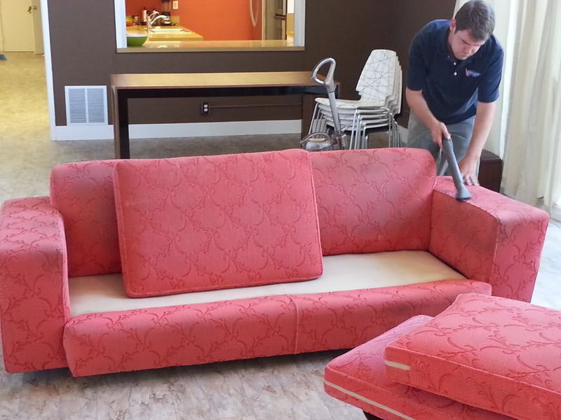

Low and behold this 1940's beauty!

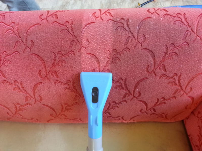

pre vac..
going deep..
protect the floor..
mix up the juice..

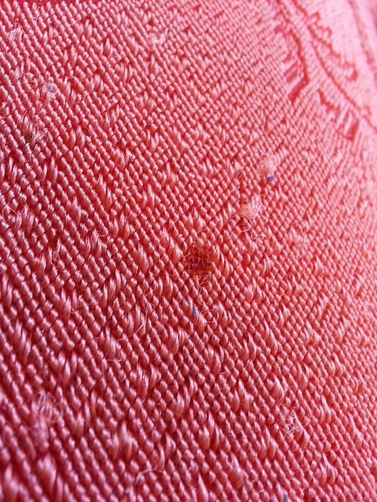

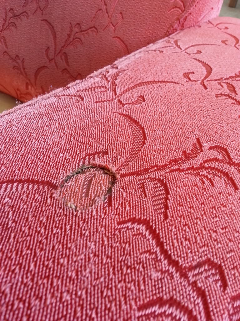

point out the flaws (see the goofy patch?)

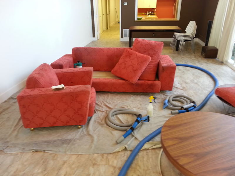

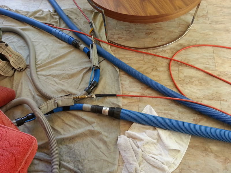

is Dualing with an AT and 2.5 hose straight to the SS uph tool overkill?

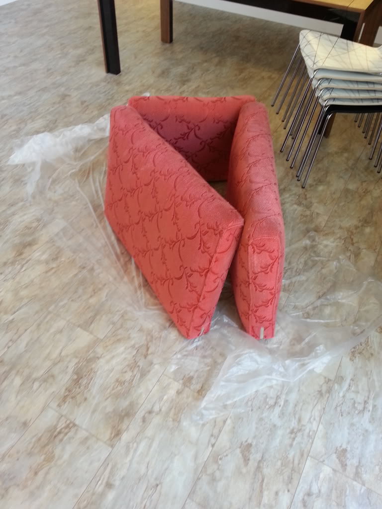

lay out visqueen for drying..
No idea what it was made of, "smelled" like a linen/nylon/poly blend.

Sweet Mikey, I see a few of those each year. I price them as restoration cleaning due to the time required. I see you must have had the same issues with that wimpy end hose on the SS hand-pieces. I replace the flopd.ck end hose due to it collapsing. Has anyone have an explanation why SS would use sturdy hose and extra pliable on the same tool. Maybe someone from SS could explain their reasoning why we need to modify / correct a brand new $600.00 tool.

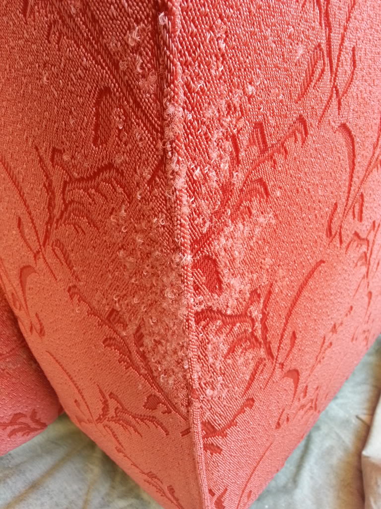

Still see a few around here. Big problem with older furniture like that.....dry rot. You can be wizzing along cleaning, and the vac can can grab the weaker parts and tear 'em wide open. Ask me how I know?? I warned custy before we started.

I am in cottage country. Tons of this stuff finds its way here thru auctons, hand-me downs etc. Any comments on that hand-piece.
117,071
Nothing is perfect nut the SS uph tool is my favorite. Love the light weight and control of the water.
The foam core has petrified in the cushion, each must have weighed 40 pounds
Smell like dyes when you hit it with the heat? I seem to remember it having a strong dye odor.
117,071
not sure what dyes smell like but every linen or linen blend has the same musty odor once it's been wetted down.

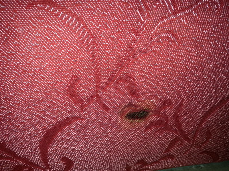

Wish you would have done a burn test. I am wondering why you think the fabric would have included linen.

just "that" smell..
the other burn tests done over the years ain't good enough?

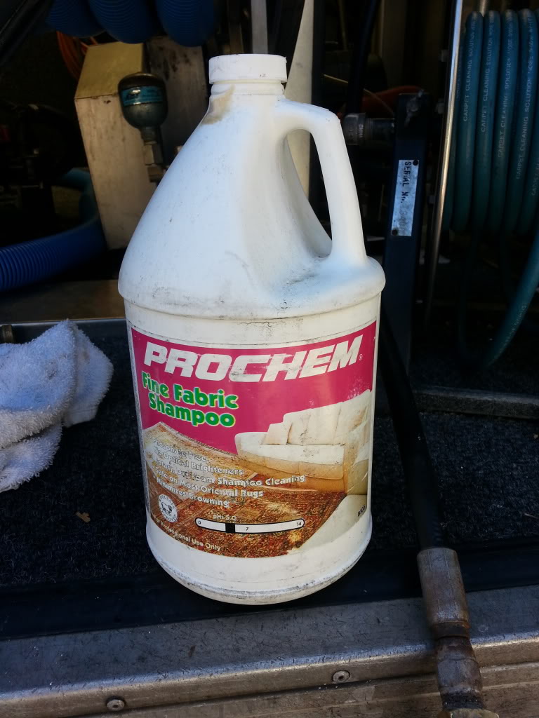

The one burn definitely shows synthetic. The shampoo surprises me since they are almost impossible to rinse out.
I never thought about carrying plastic to stack on but we do carry an 800' roll of 3' wide paper for that use. We first clean and stack on paniters drop cloths then tranfer to the paper. It also doubles for leave behinds at doorways

Th Prochem shampoo rinses out just fine. Along with some Snake Oil for the tough spots, it's great for finer uph fabrics.
This lady was real sceptical about us cleaning it at all due to age and she had done enough research to know not to use anything alkaline on it. She wanted to see the jug as well.

On a serious note, Fine Fabric Shampoo is a vastly under appreciated product. Here's some cleaning industry historical trivia:
Its name in the 70's was Commercial Carpet Shampoo.
Really, no alkaline?
