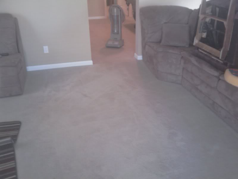

I get listening to the guys that say not to prevac, or not to worry about it as much and they almost get me believing it.
Its funny how shortly afterward I get into a job where I prevac and I get a LOT more than I expected.
This place as an example. Looked pretty clean, really couldn't see anything worth vacuuming. 3 small areas (traffic area only) and 15 stairs.
But there was lots of dust and fibres came off the carpet. Someone said that the truck mount would get all this.
If you don't prevac, you must be emptying your filter every 20 minutes!
