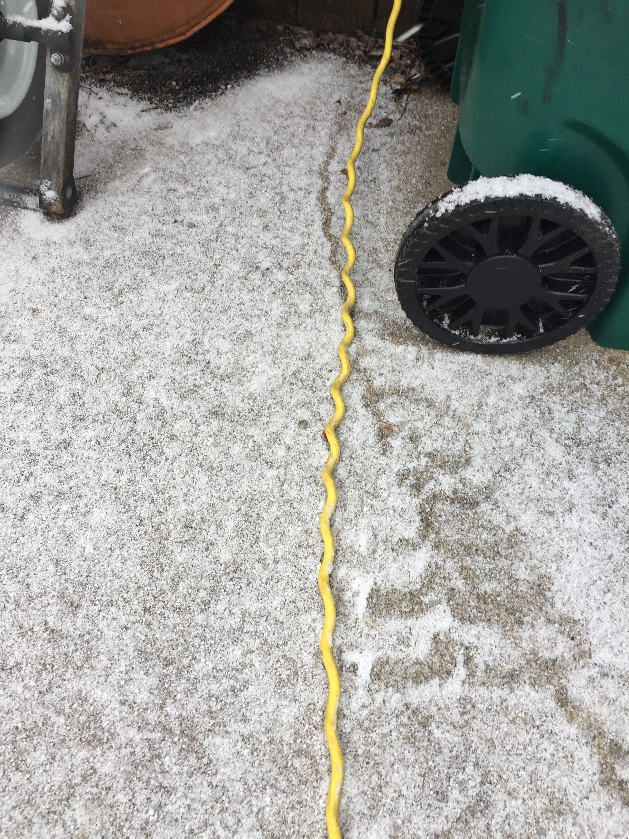

Ended up spiraling over time
you mean twisted/curled like a pigs tail?
similar to this
only worse??
That's almost always caused by repeatedly unplugging at wall and hand coiling on the way back to machine, sprayer or vac
Unplug at wall and hand coil at the machine/sprayer/vac pulling the cord to you...twisted cords will be a thing of the past

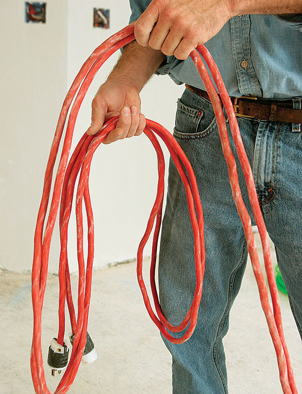

I doubt the cords are curling because of heat....99% of the time it is the way people roll them back up......I use 12/3...25 foot cords for everything I use....mine is well over a year old and looks brand new....when I had a full-time employee...his always twisted and all screwed up in less than a month....it all in how you roll them back up....they have a memory and once you change it then they twist in the sheathing....lay them out...put one end in your hand and as you roll it up...twist it in your fingers and let it roll the direction it wants to and it will solve the twisting problem.....or at least reduce it...the type of sheathing also makes a differance...you want a softer type...

Out of habit, I always start at the machine and lay it up clockwise. That harks back to line (rope, Marty) and how it is twisted.
Drop cords I start at the male end and lay right (clockwise).
Anyhow, the Chinese send them left laid and right laid. Study the casing a bit and lay it up with however it came. Just make sure you do it the same way every time.
