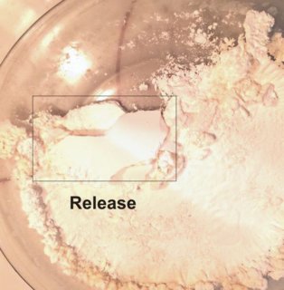

A previous photo of our powder Encap product tested to the specs of a CleanFax article on residue from Encaps:

You know over the years "Experts" have come and go. Formulators of products I don't trust because they are out to SELL. They can make up any kind of BS just because they have that "Title". Doesn't mean their stuff is any good.
I'm part of the real world of carpet cleaning. I ain't NO shill and I know what I like. Has Tom corrected that O2 so it doesn't rot on the shelf? Film formers make no sense to me regardless of what the "Experts" think.
There it is...............WHITE residue..............
Lets see who makes that YELLOW residue...guess who?
