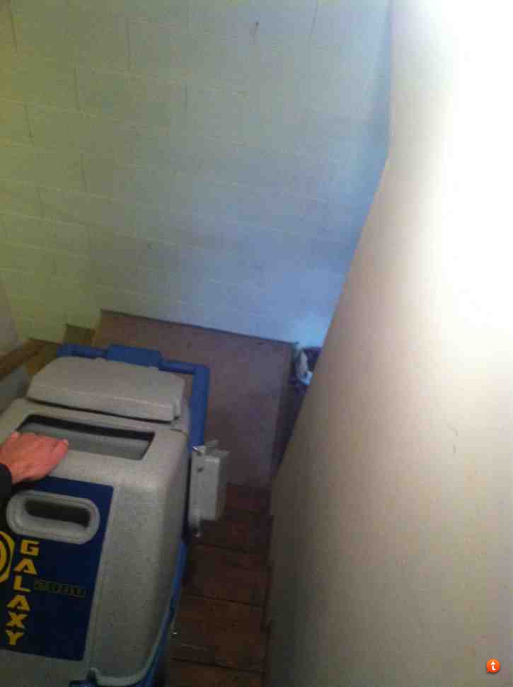

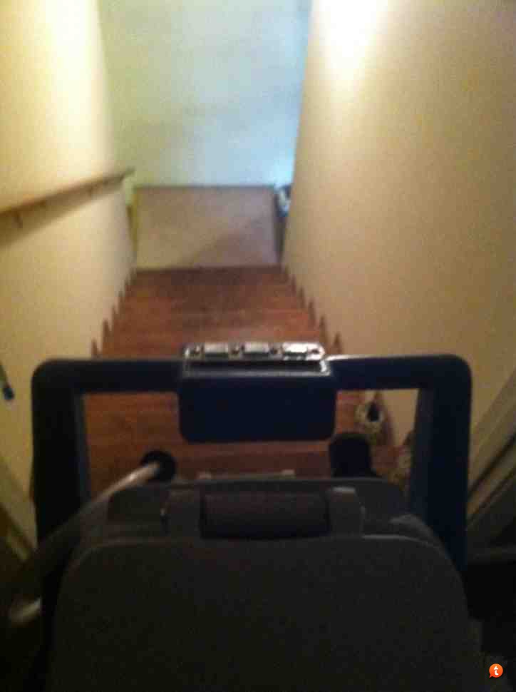

Just too far into this 100+ Million dollar home to reach with the 350' we had on the AT.
With 25ft of hose and a 802 wand it keep up the heat (04) and had just enough suck to do the job well on this very nice nylon loop. 500 psi is too much for lightly soiled carpet. Goes through it too quick
Lost prime once when we ran the fresh empty but a cool little lever built into the unit flushes that real quick.
Very solid, easy to use, easy to fit in the back of the VATs
I need a longer 1 &1/2 wand if this becomes a monthly use item.
Just ideal for upholstery.
I would have taken video but...
