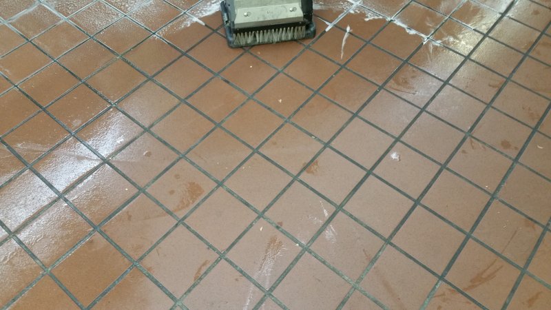

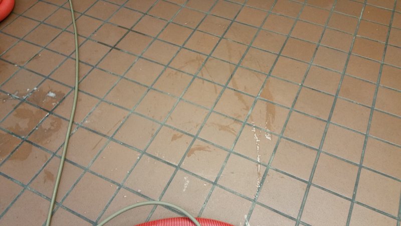

Finally kicked some Grimy Tile and Grout Butt tonight
11,199
Grand Rapids, MN

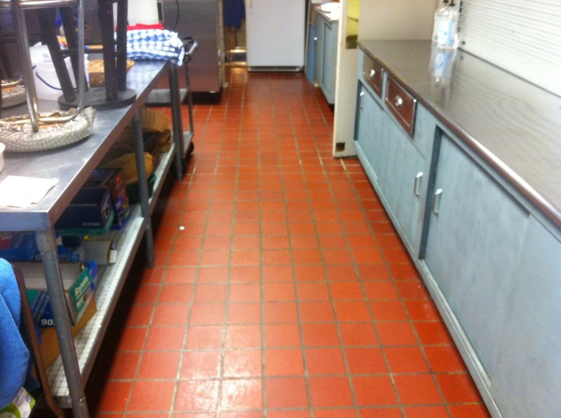

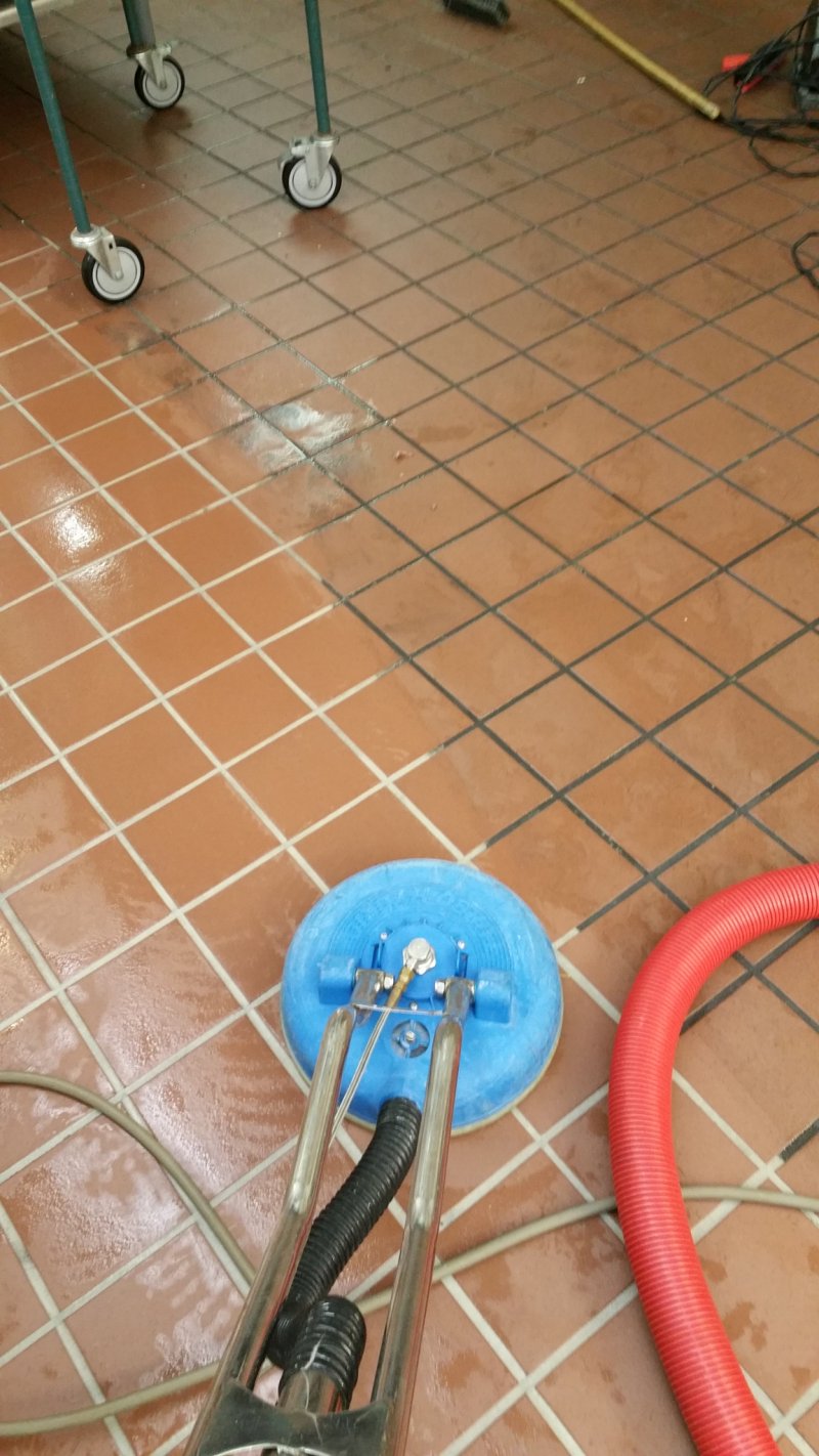

Been liking the new Harvard Chemical Powdered Citra Zol as a booster to our Saiger Special Sauce Blend we have been using....
Has enzymes in it too...
20 year old grimy, Greasy Tile and Grout, never professionally cleaned....
Expected the worst....
Dang....went well.

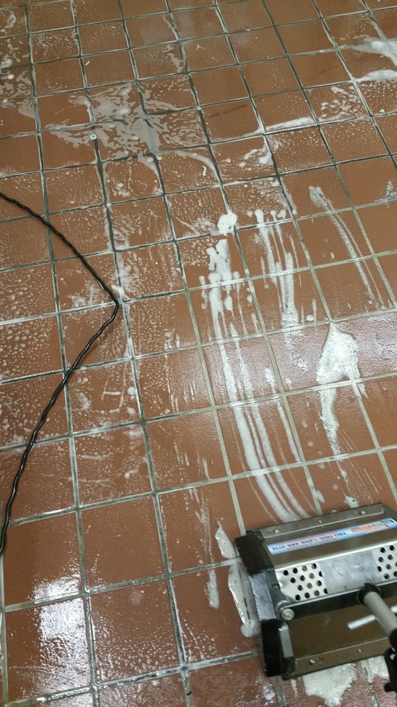

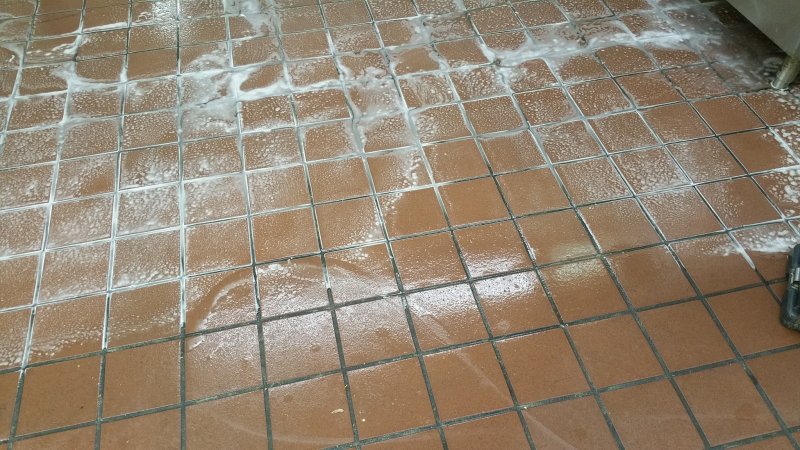

I did do some CRB and an occasionally scrub with the new stainless grout brush from Interlink Supply...
Grease floated out...
We did 1000 psi tonight just because....
But happy with the results! :)

Mark, if you do much tile work you may want to get the SX-15. Wider swath and 2" hose all the way to the floor for much faster water recovery.

Not sure how well the 15 inch sx works with 1000 psi... The 15 inch turbo...demands more pressure to run normal speed.

The larger the diameter spinner the slower it will go at the same psi. I wouldn't expect it to hurt performance at the speed it's turning. I've been thinking about getting another spinner. Definitely a 15 unless they make a bigger one.

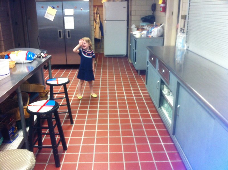

Using the Daimer (superheated steam) and wax stripper. It hadn't been properly cleaned in 15 years.
My granddaughter there serves as Quality Control Inspector. She approved the job.
