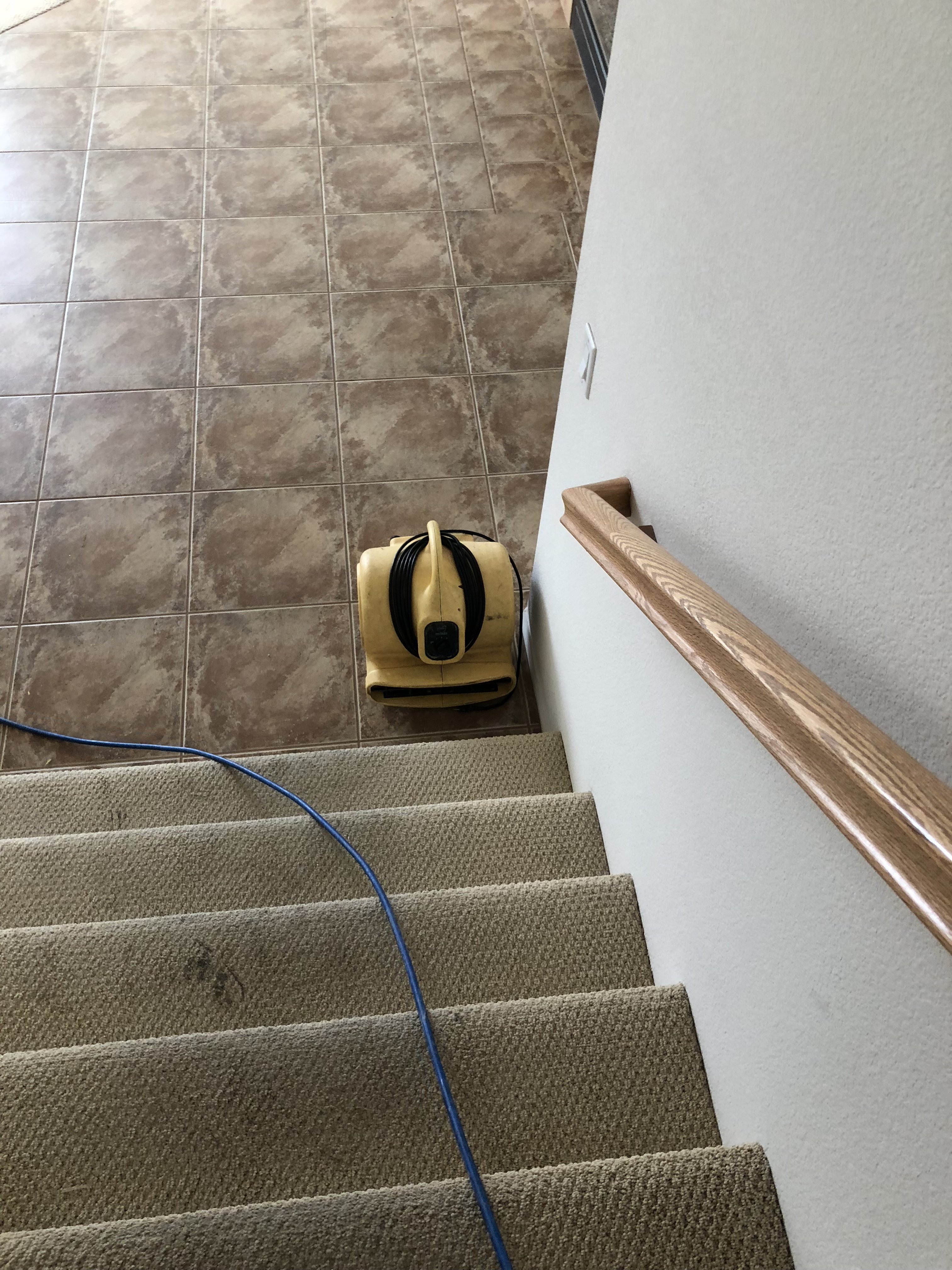

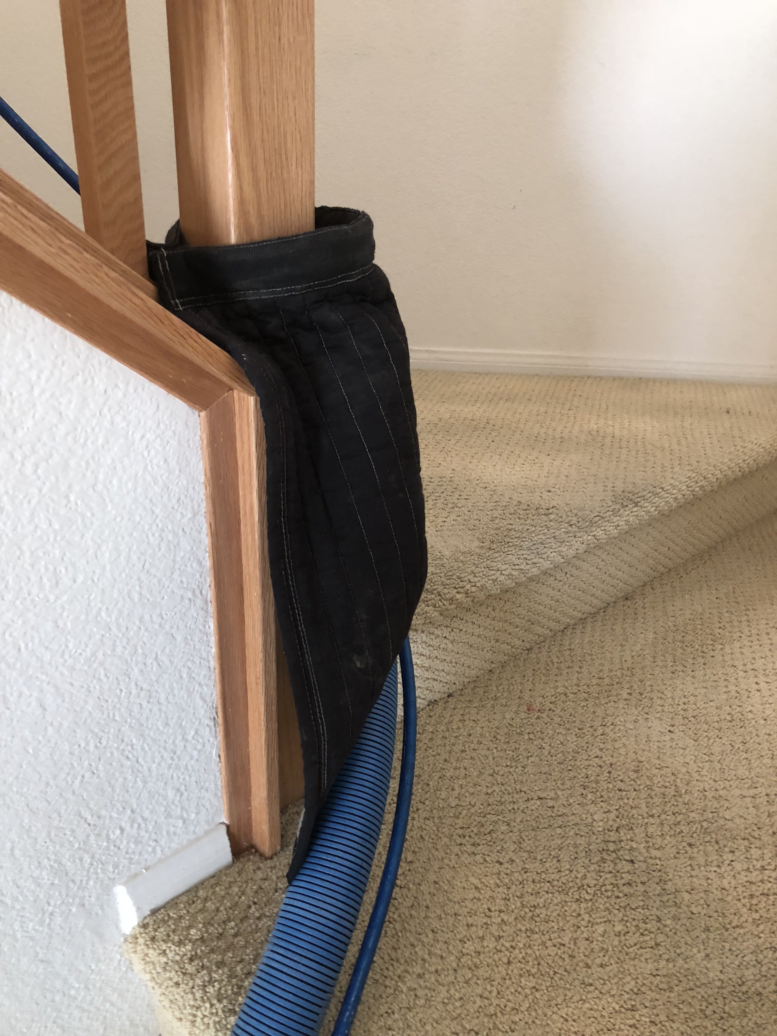

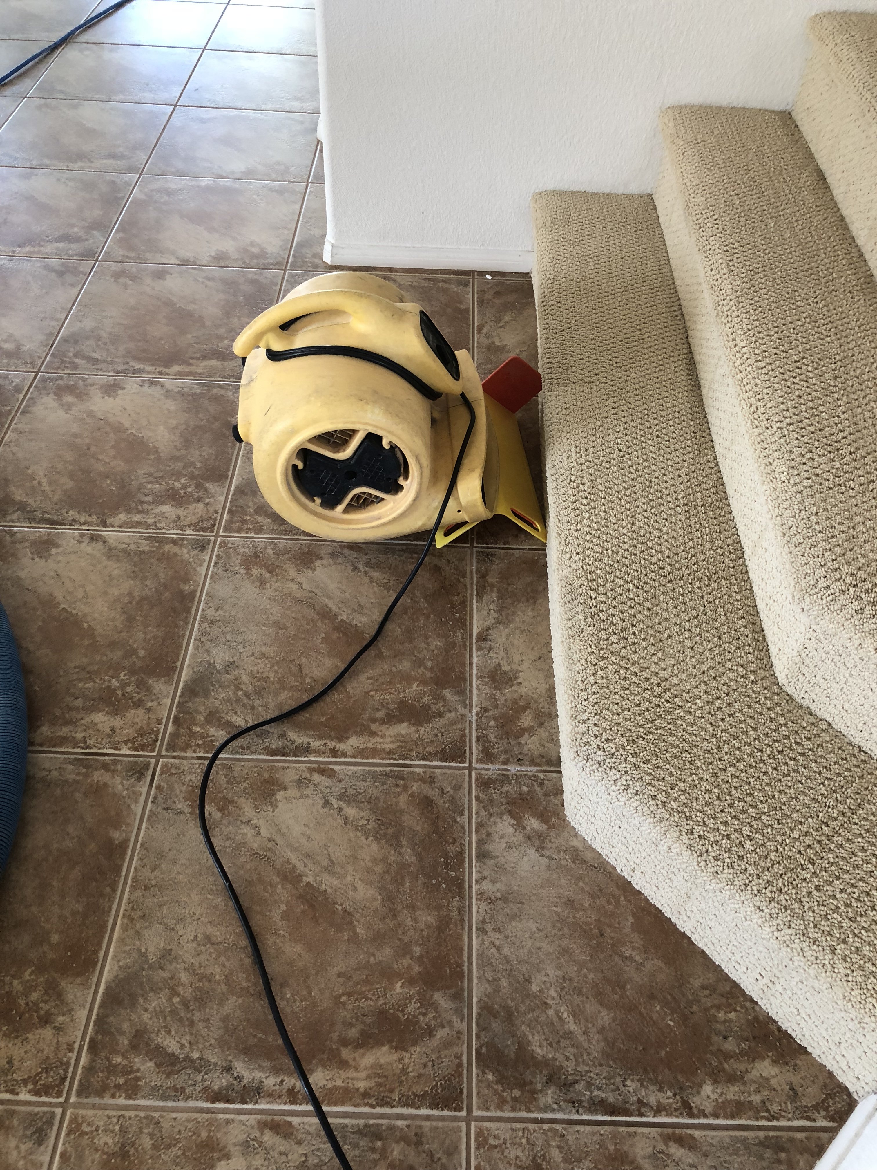

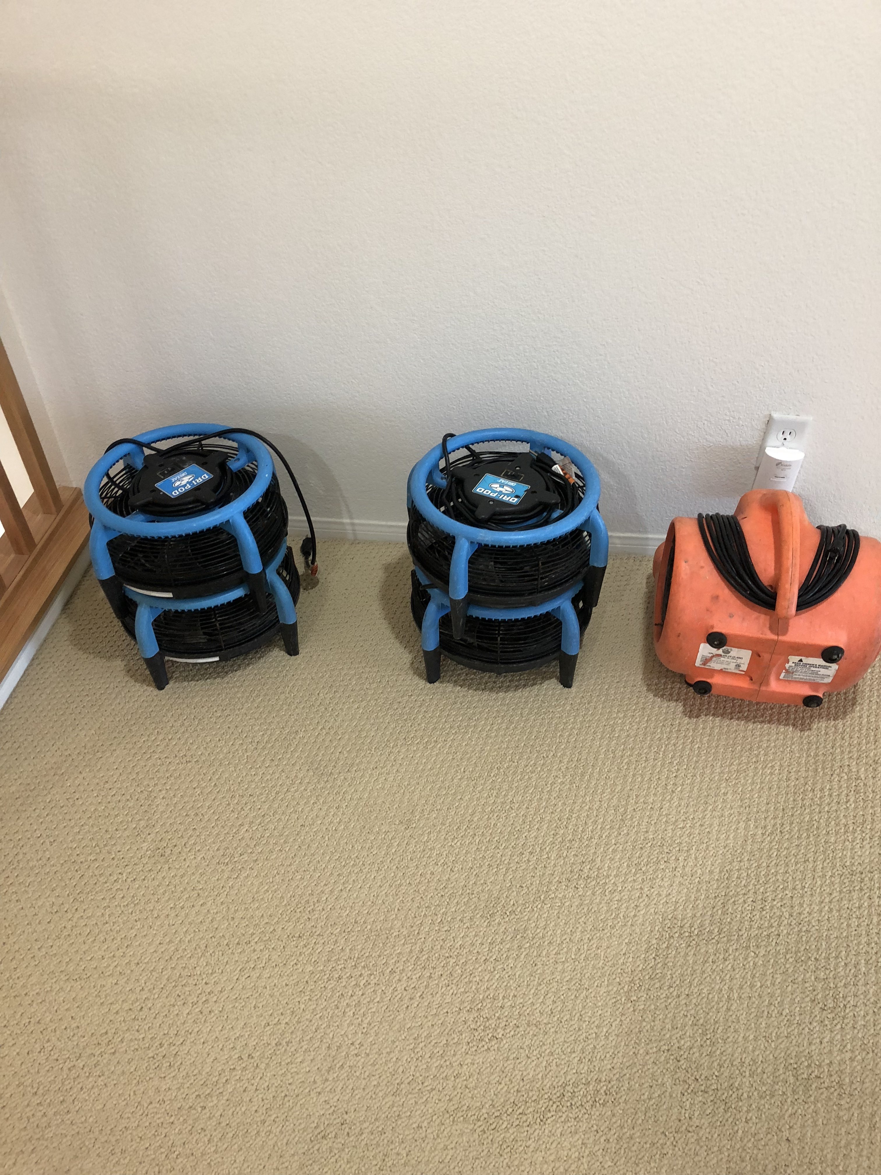

Large house this morning staged the job with fans and wall guards!
While my helper Carlos vacuumed the house.

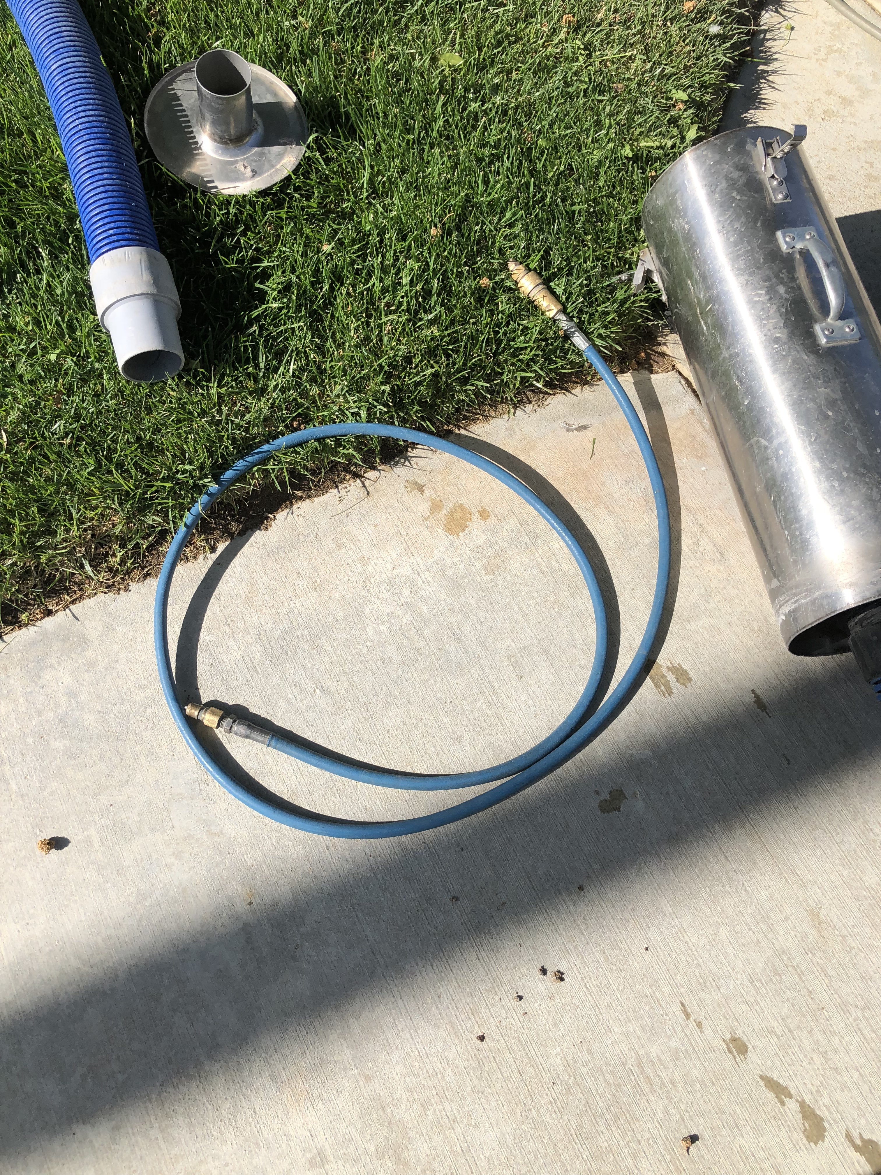

Used my wanders yard sticks to keep the grass from getting burned.

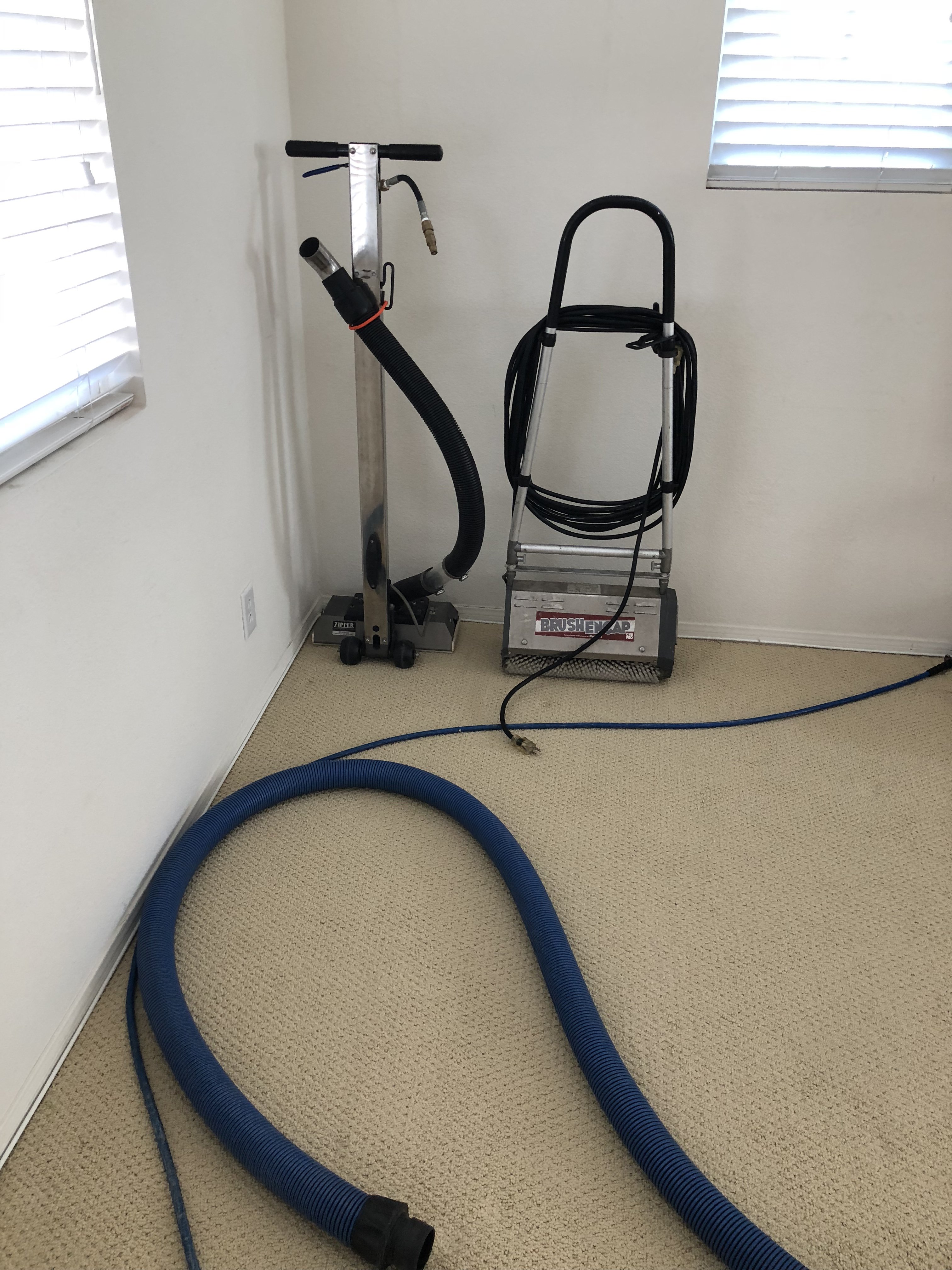

Had my convience hose with dust downer ready to clean my filter before I start.
Lastly used my 15 crb and 15 inch 12 flow Zipper on most of the carpet.
ps my filter has 7 ft 2.5 hose from the truck, another 45 ft of 2.5 inch into the house.
Then I usually use a 50 ft of 2 inch, but this was a little longer runs so 75 ft of 2 inch to the Zipper!
