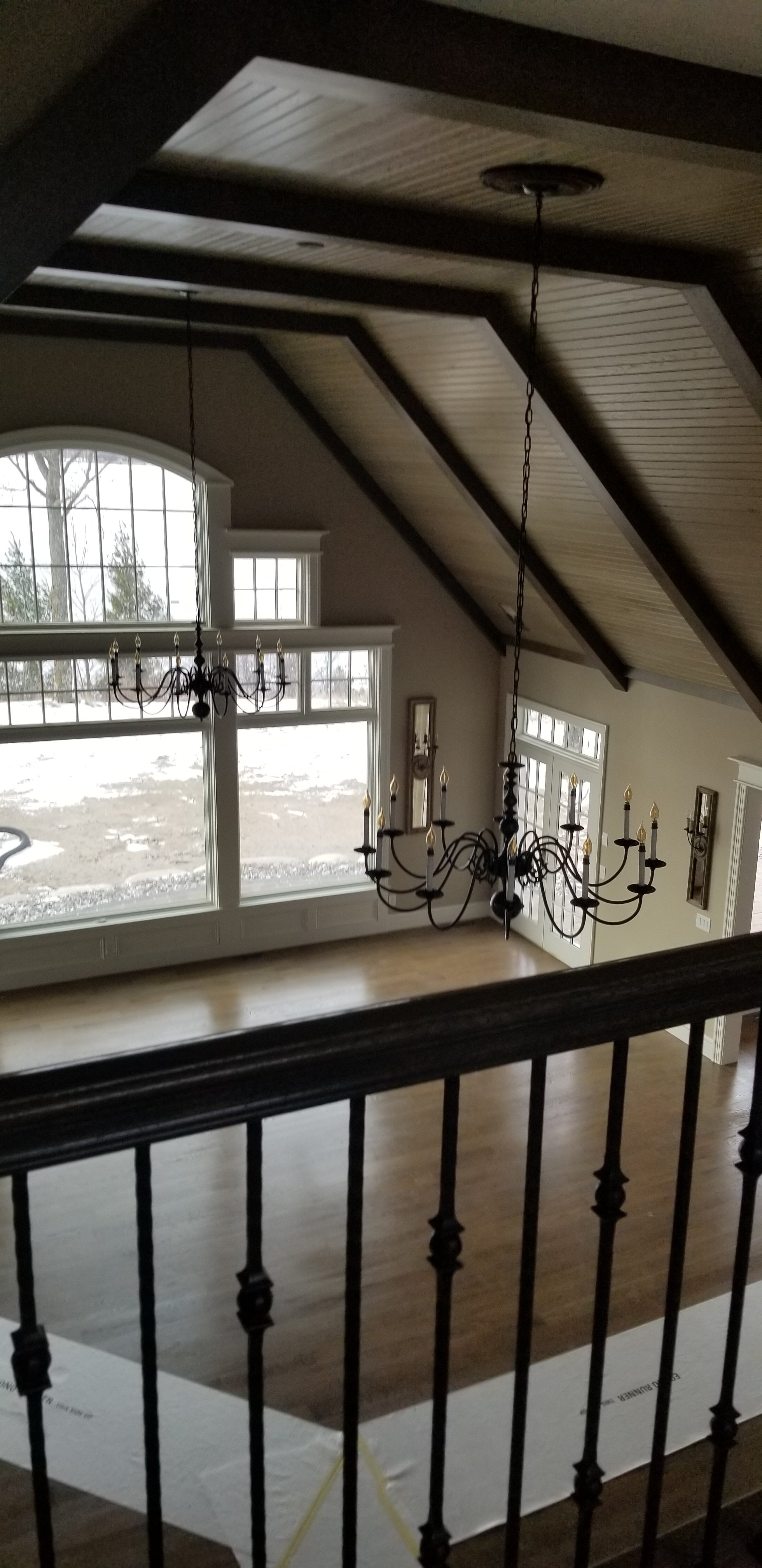

Got the call....
Just installed that day...
High end Shaw nylon that special ordered...came form California Shaw Factory...
Everything a bit late arriving and when seamed together, it would fluff up at seams, but not the rest of the carpet....
And color was not correct.
Carpet was giving off lots of Tufts...and not the correct color from the sample chosen (which can vary) but was way different.
Got panic call on Friday to see if we could fix.

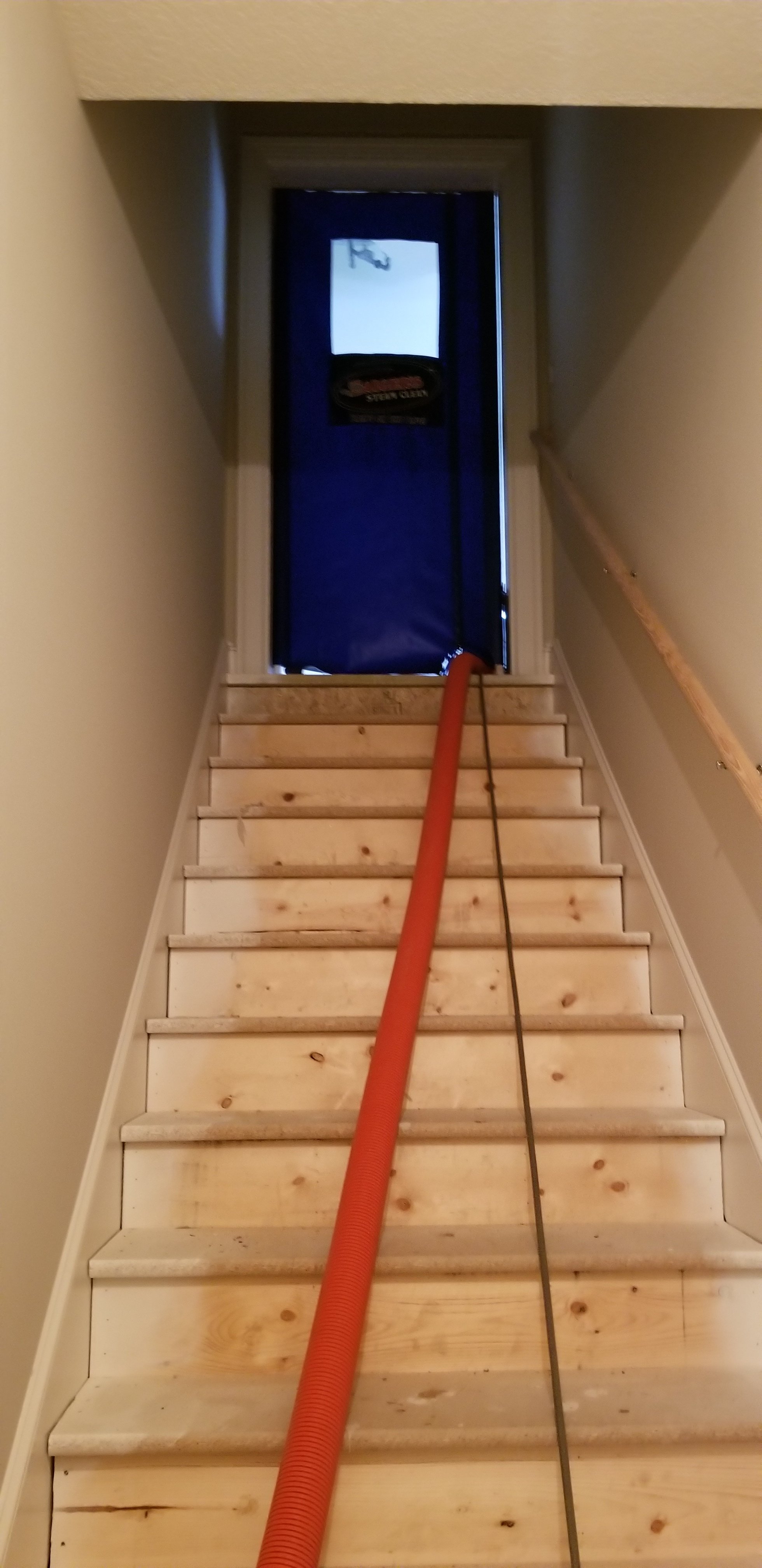

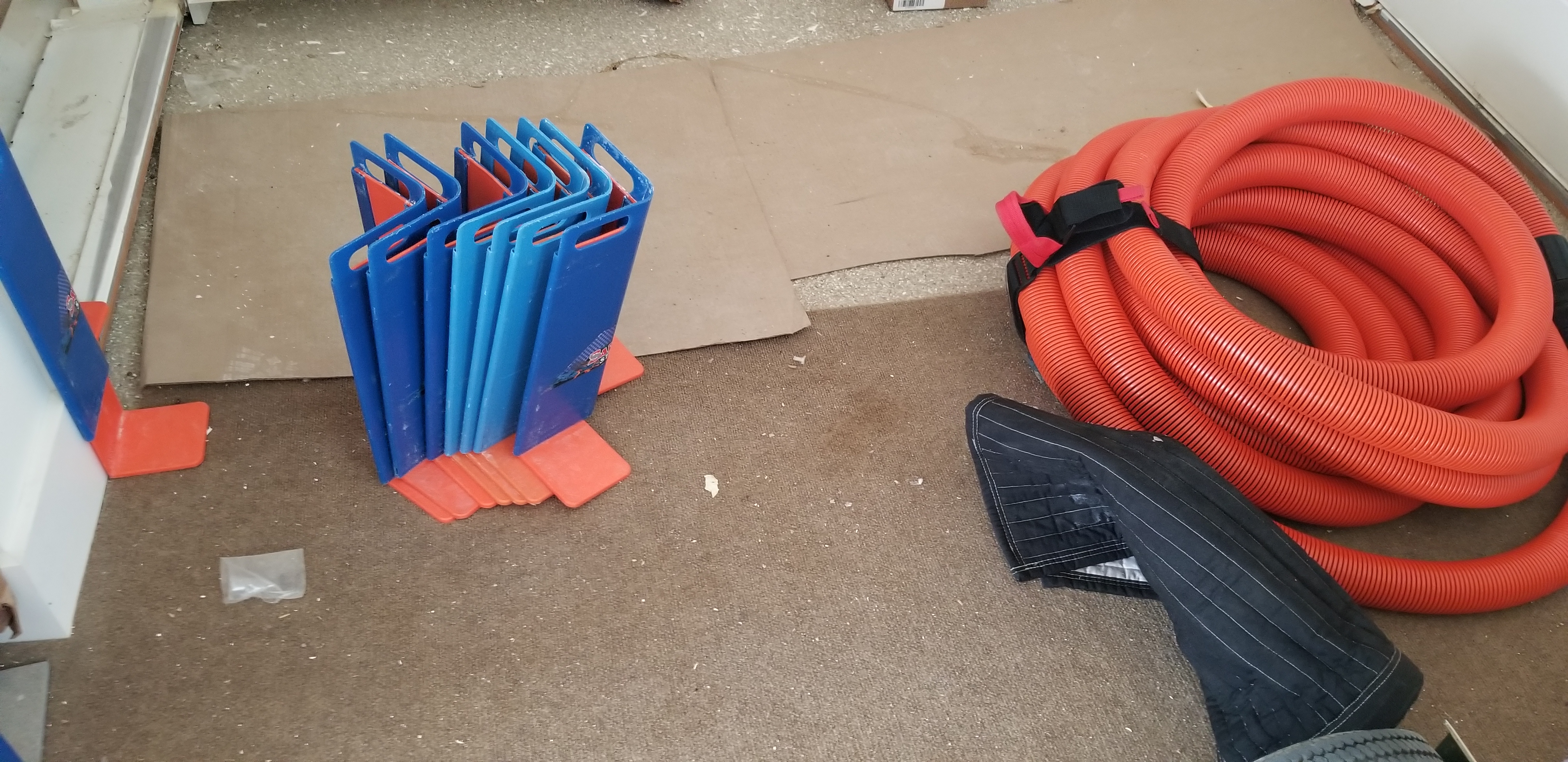

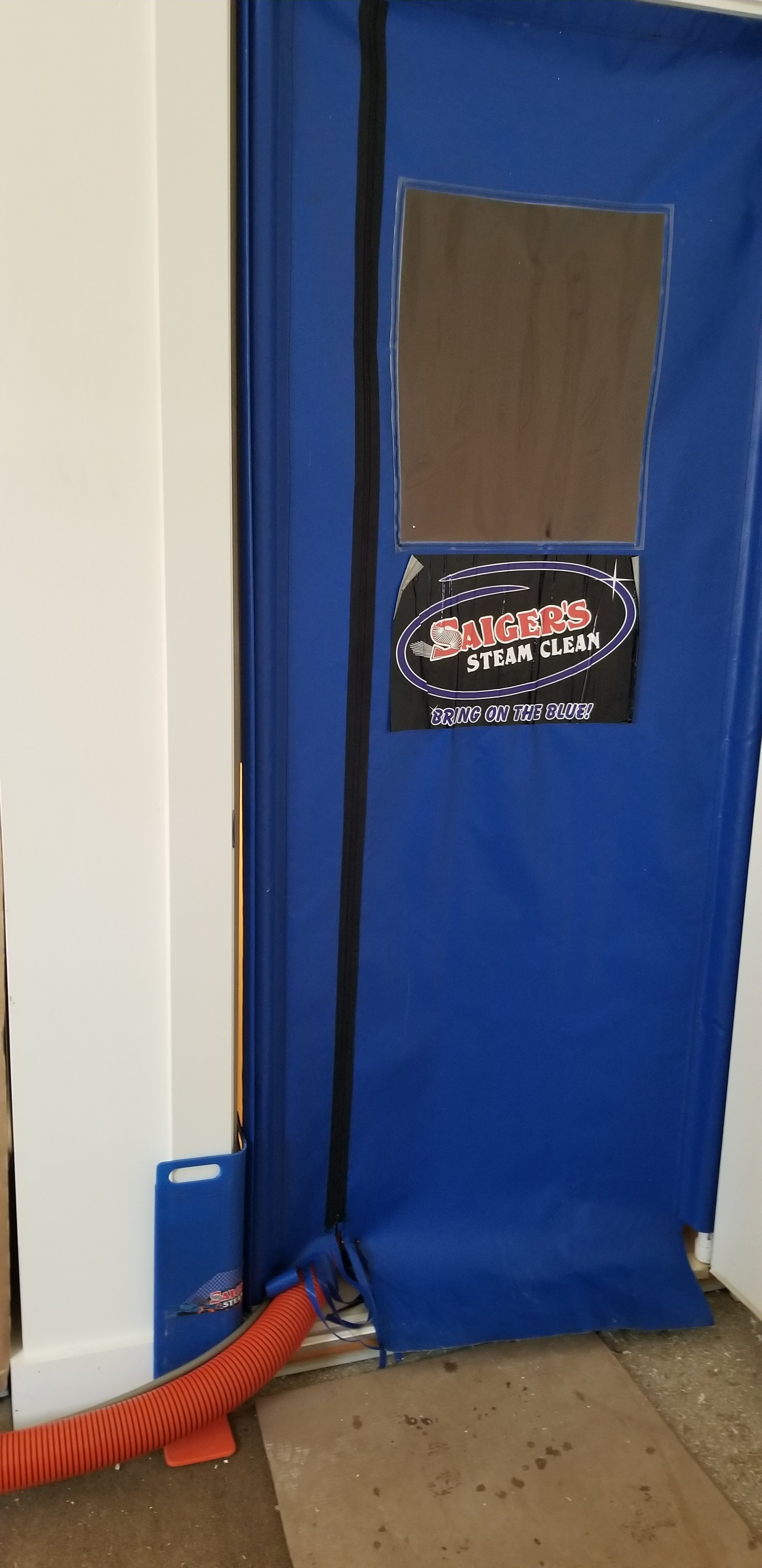

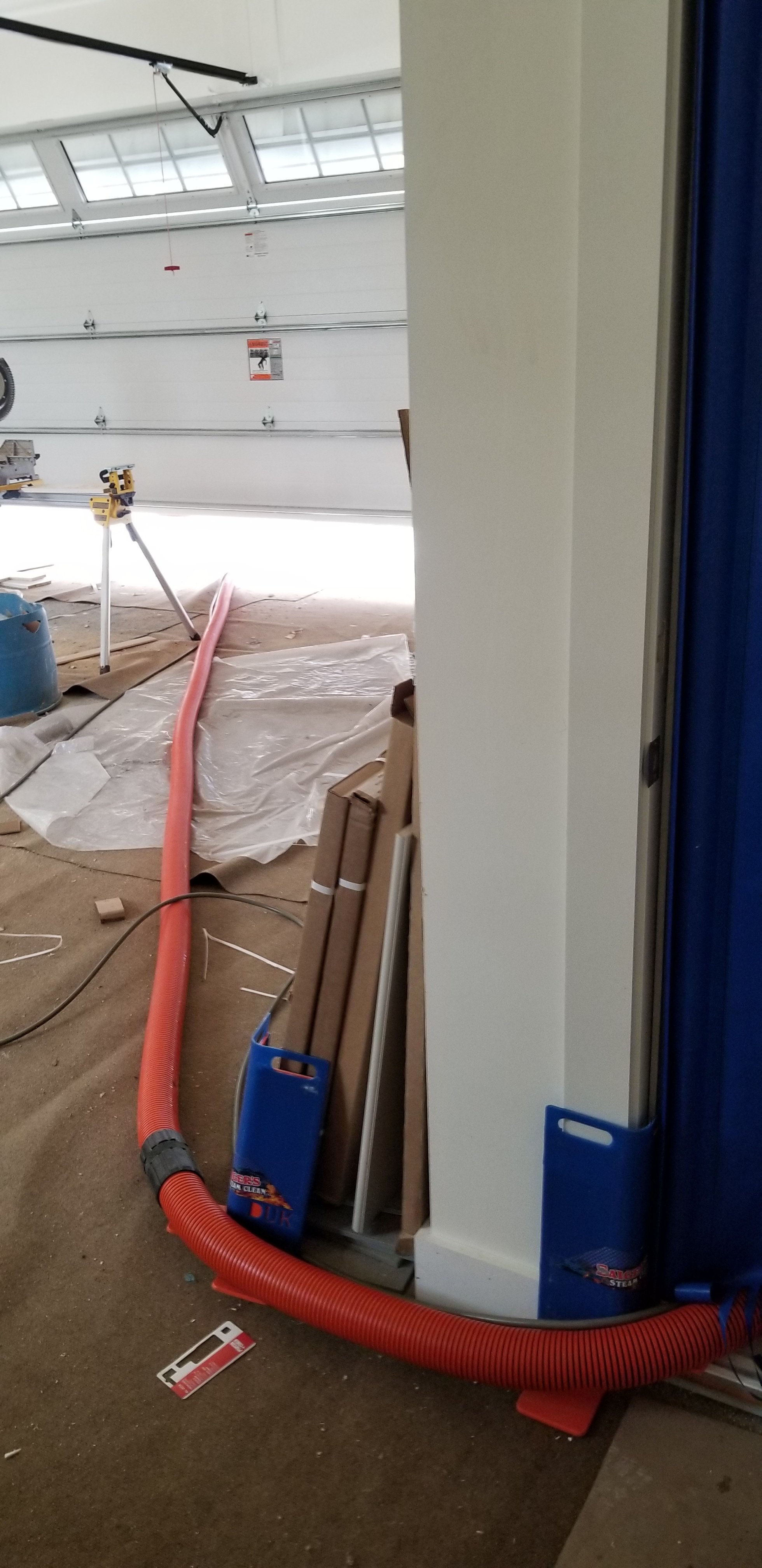

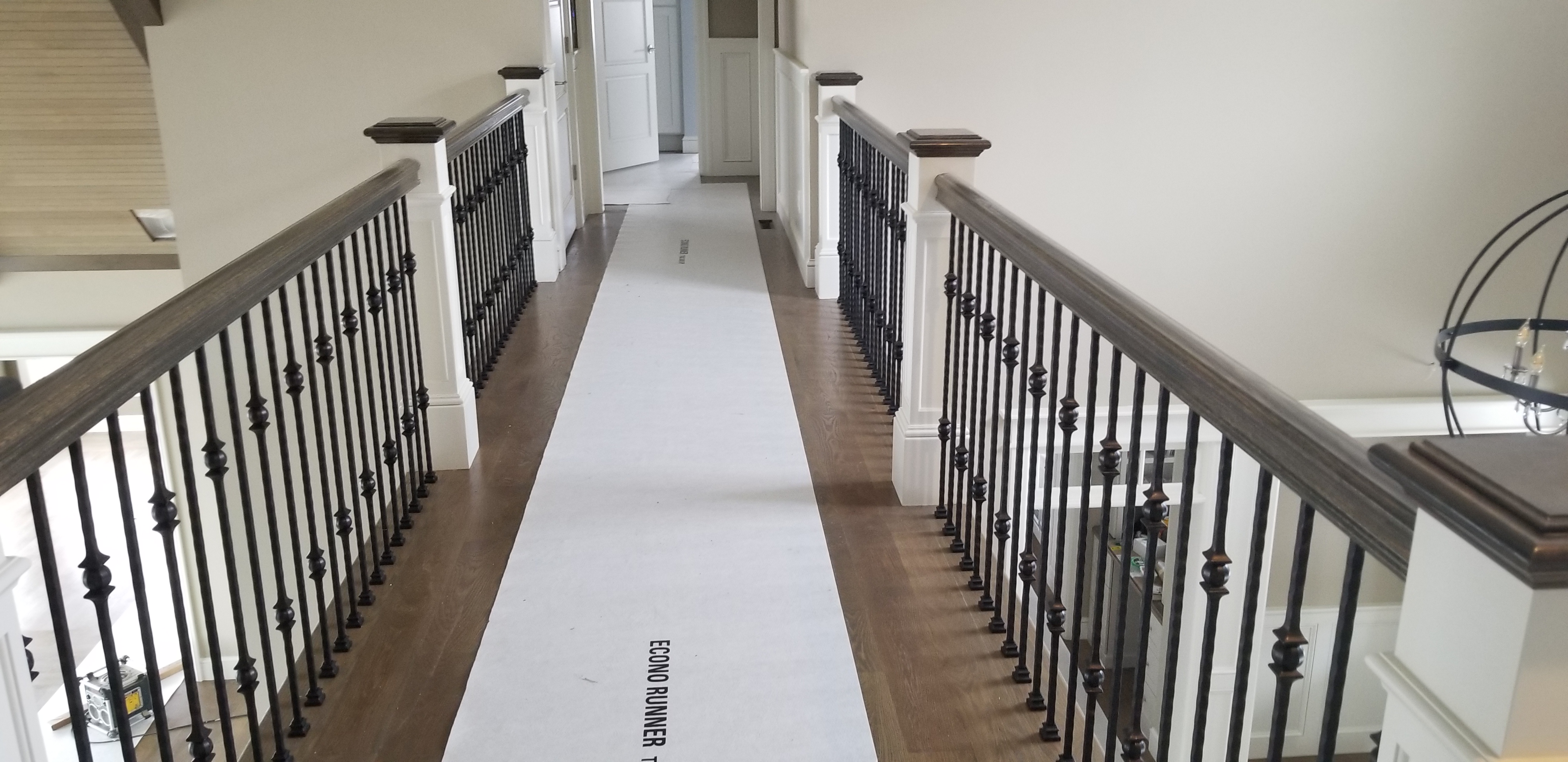

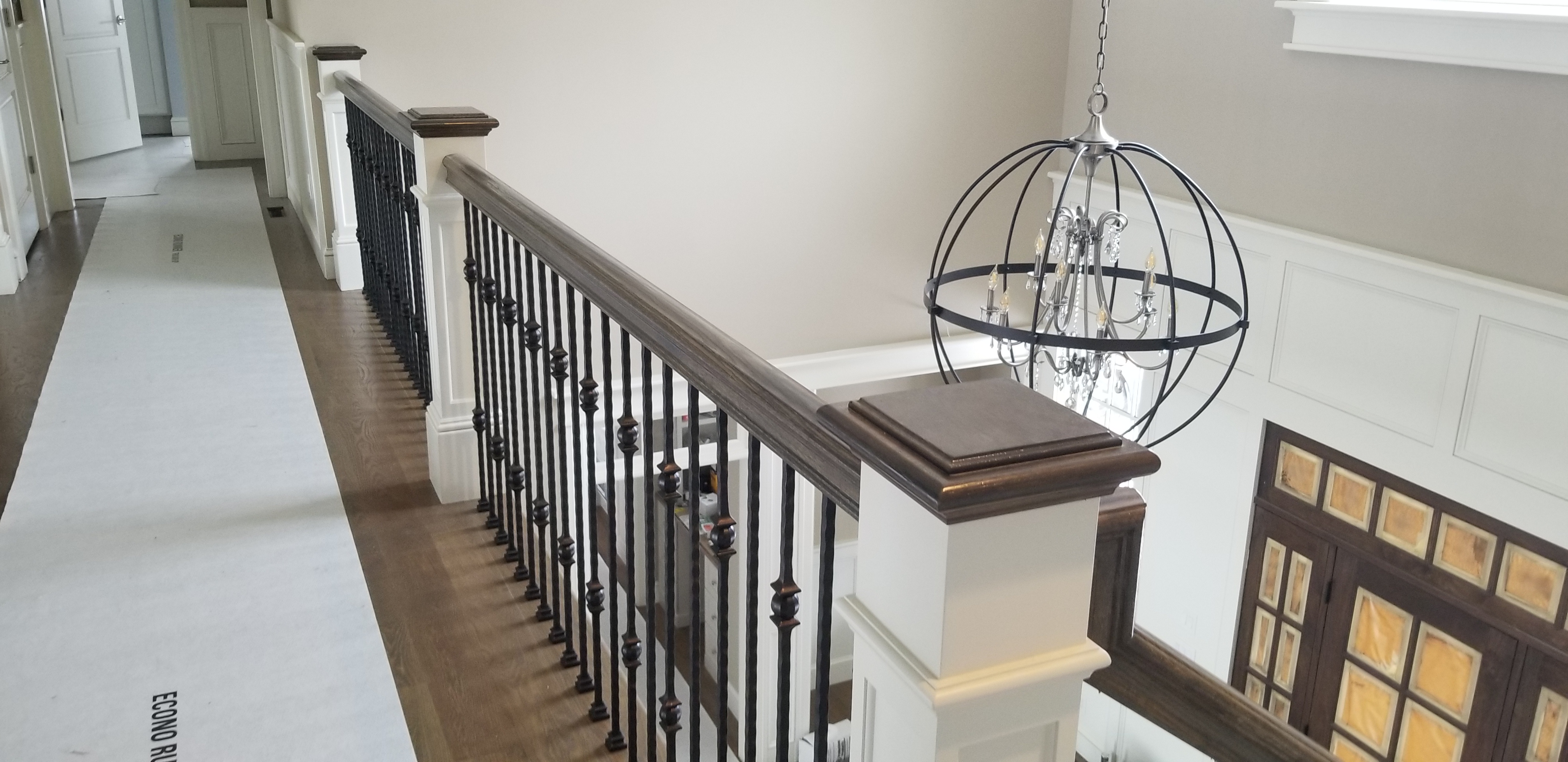

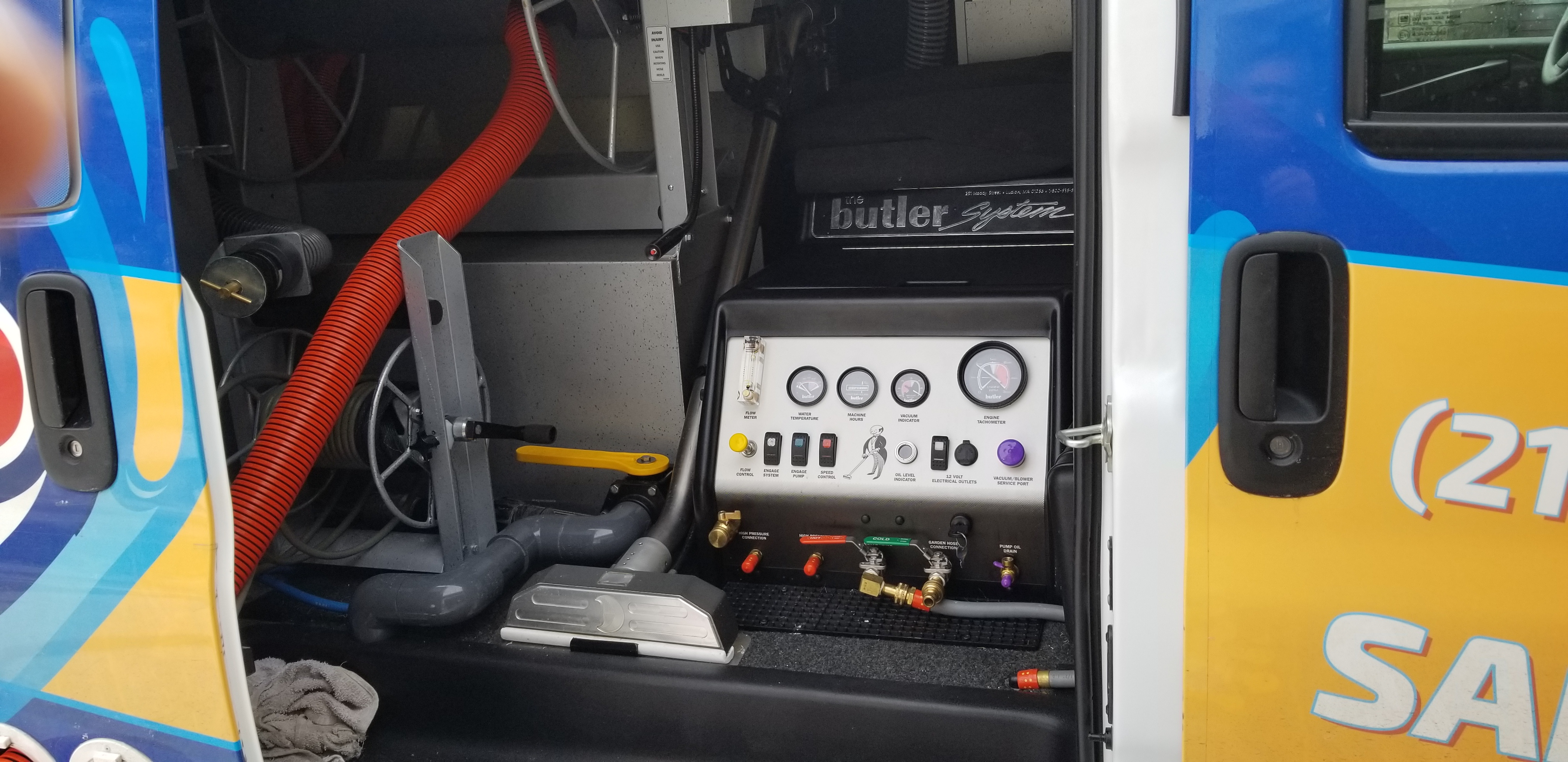

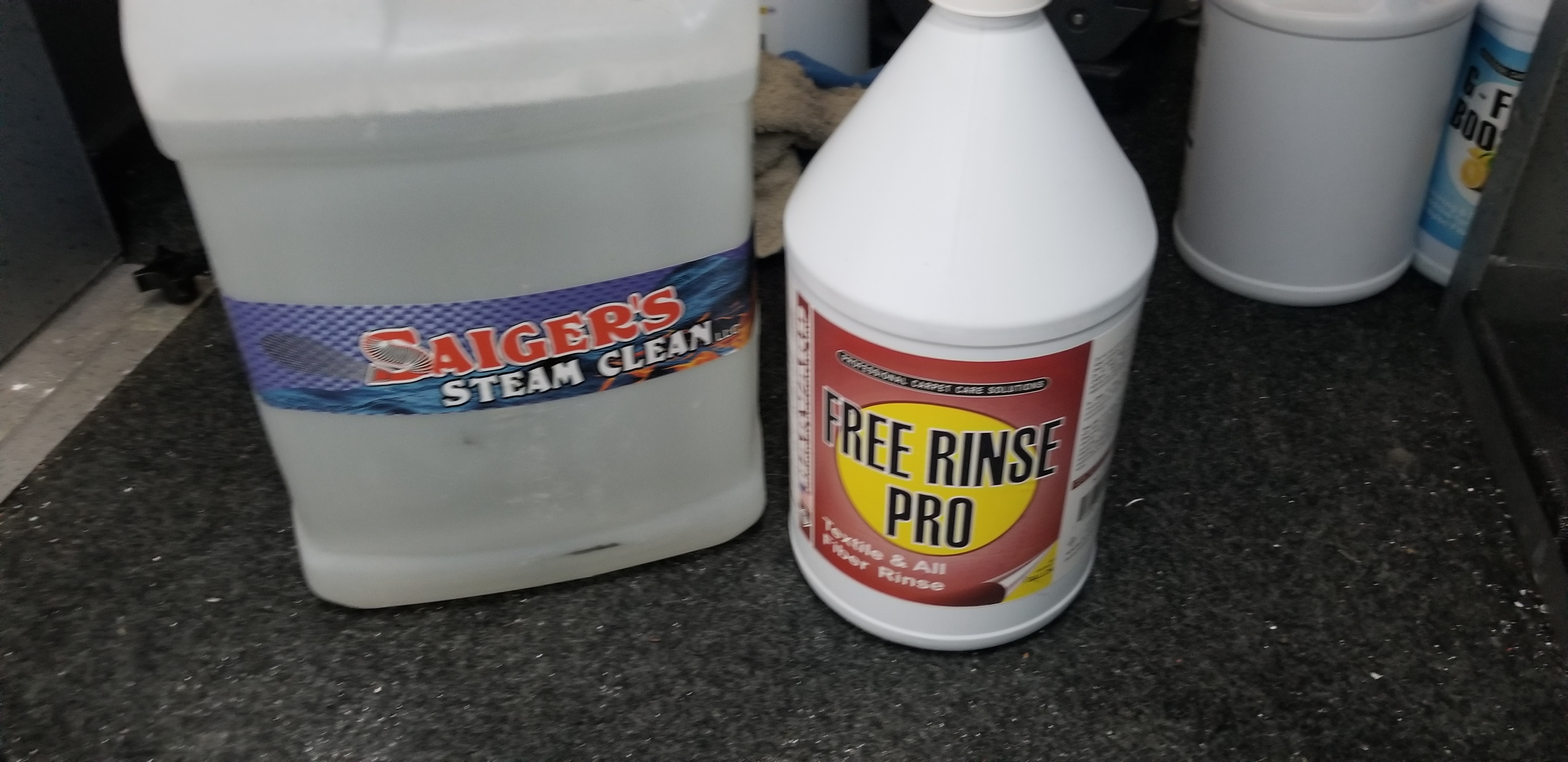

Did acid Rinse only...protected and documented the heck out of the place also.

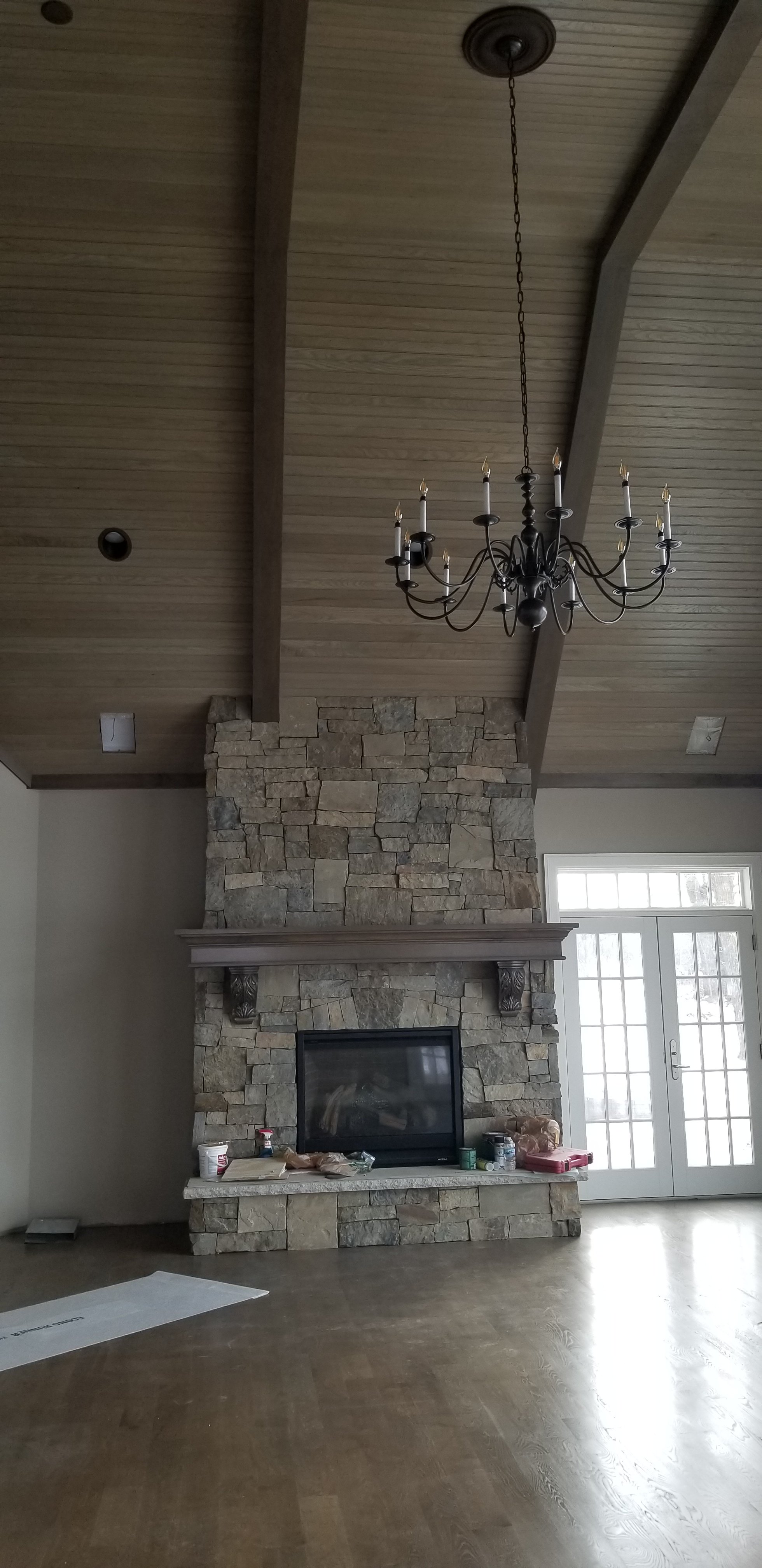

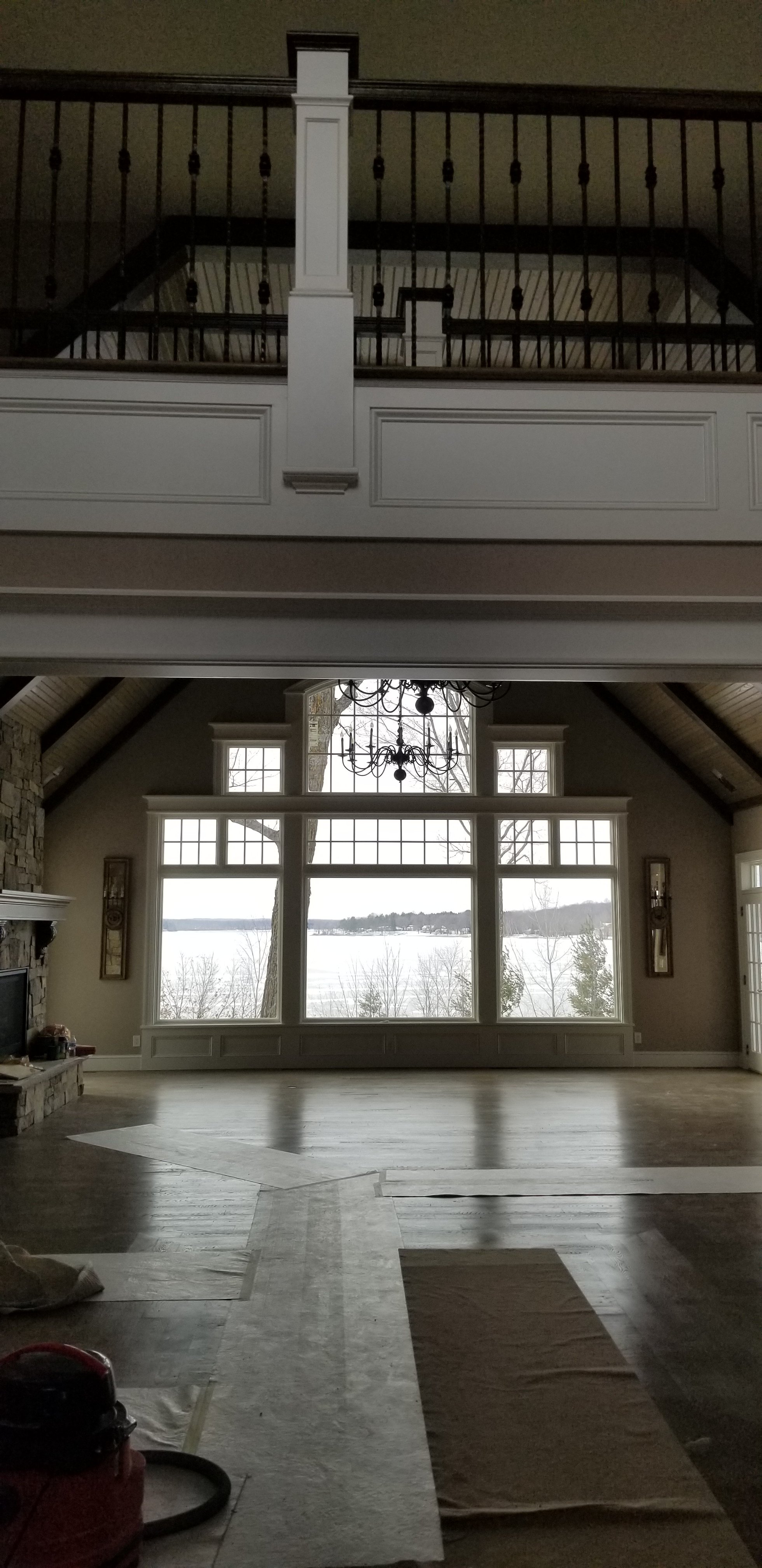

Some of the finest craftsmanship in the home I have ever seen in a home (well especially up here)
Got the call, the carpet matches the sample chosen from...is soft and fluffy again...
Everyone happy...including me to get out of there without owning something having a Damon moment @Nomad74

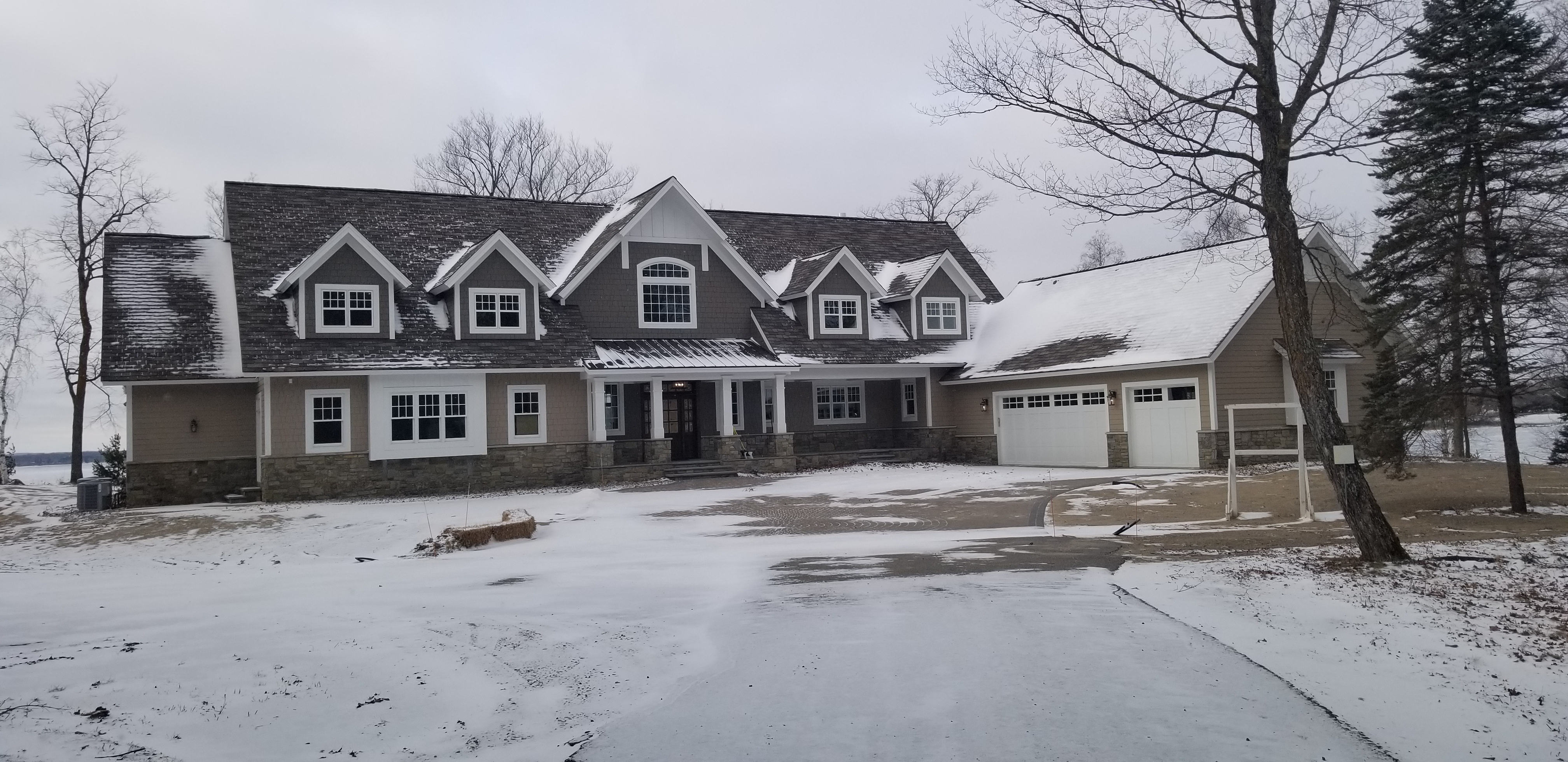

This is one of 2 of their lake homes...one next door similar...just half the size...

Mark I am impressed by all the corner guards and care. Explain what the issue was and why the acid rinse corrected it. I haven’t run into this situation.

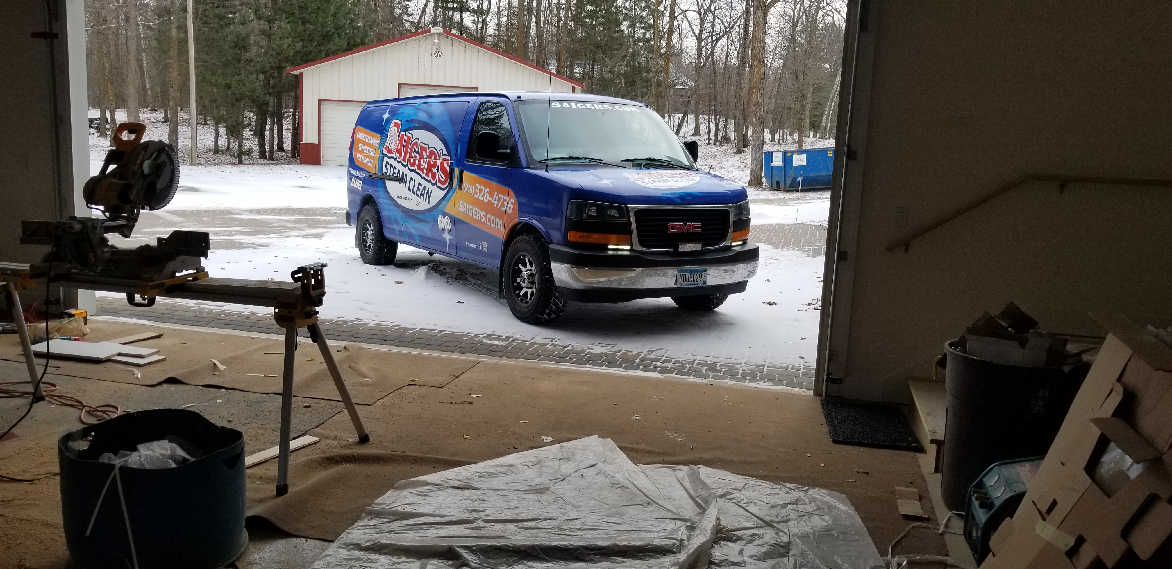

Very nice. Except for the snow. Move immediately. I send a daily text message to Tom and Ivan alerting them to what the temps are going to be. This mornig it's 29°here but the high is going to be 71°. We are having some nutty temperature swings. Anyway, I think i'm annoying the guys with my temp alerts. I just don't want them to go through what I went through when my pre-exchanger cracked.

looks like you will be having some area rugs to clean as well in the future! All those wood floors. Oh and the wood floor upkeep tooo!!!

Don't know exactly what caused it but main problem and complaint... Really prickly and crusty feel
Color did not match close at all to the original color sample chosen from (which usually can be other issues)
And with the crusty feel also, the carpet would not open up or fluff up.
Took chance on just an acid rinse and HWE after good prevac to see what we would get.

Ya know, if you had a bane you could pull into the garage And close the door all the way.
