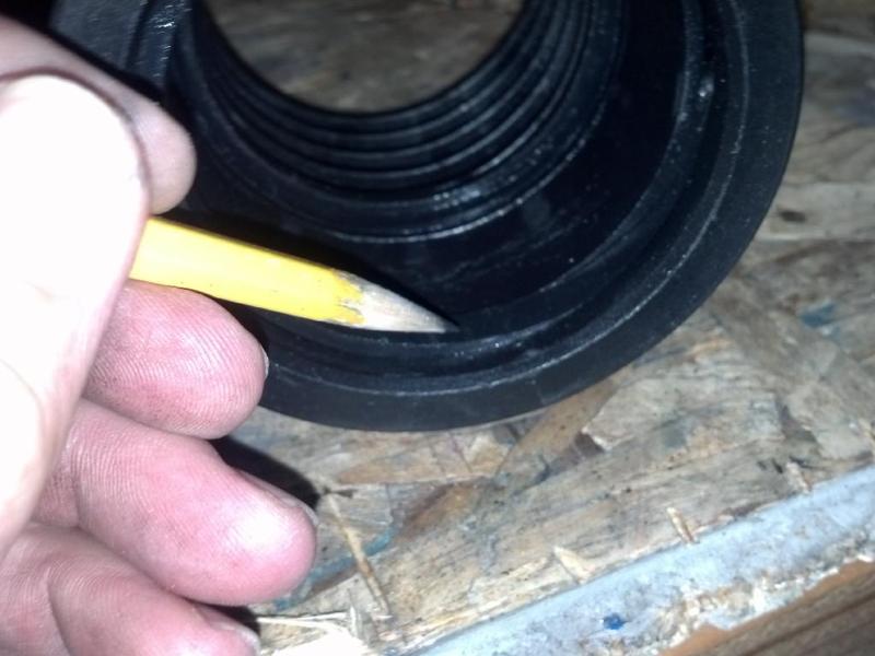

I wanted to post this as it may help with your Flash Cuffs to help them come apart. I just bought some from a local supplier and they are more than likely to older models but this may also help if you have some that are a little hard to get apart.
Take the Female cuff and place it on a bench or something you can support it with...press the release button so you can see the locking ring go into unlock position...what you want to do is take a razor blade and cut away any part of the ring that is NOT FLUSH.
On mine it was on the sides. These cuffs are very tight and any part of the ring that is not flush in unlock position will keep the male from sliding out. Very simple fix. It is just a very small amount...Only cut or shave when you are pressing the button you want it to be as smooth as possible in the UNLOCK position
