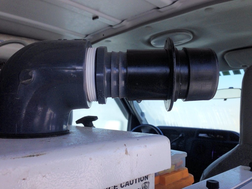

Anyone have a better solution than this stupidity?
Do I just take the barb out?

Have been using a regular cuff to my Devastator but it's COLD and the D freezes up and restricts airflow.

I imagine it's because many TM's have a plain tube for the vac connection - so the slip-on adaptor would be used. A lot of portys have or are modified to accept threaded barbs....
