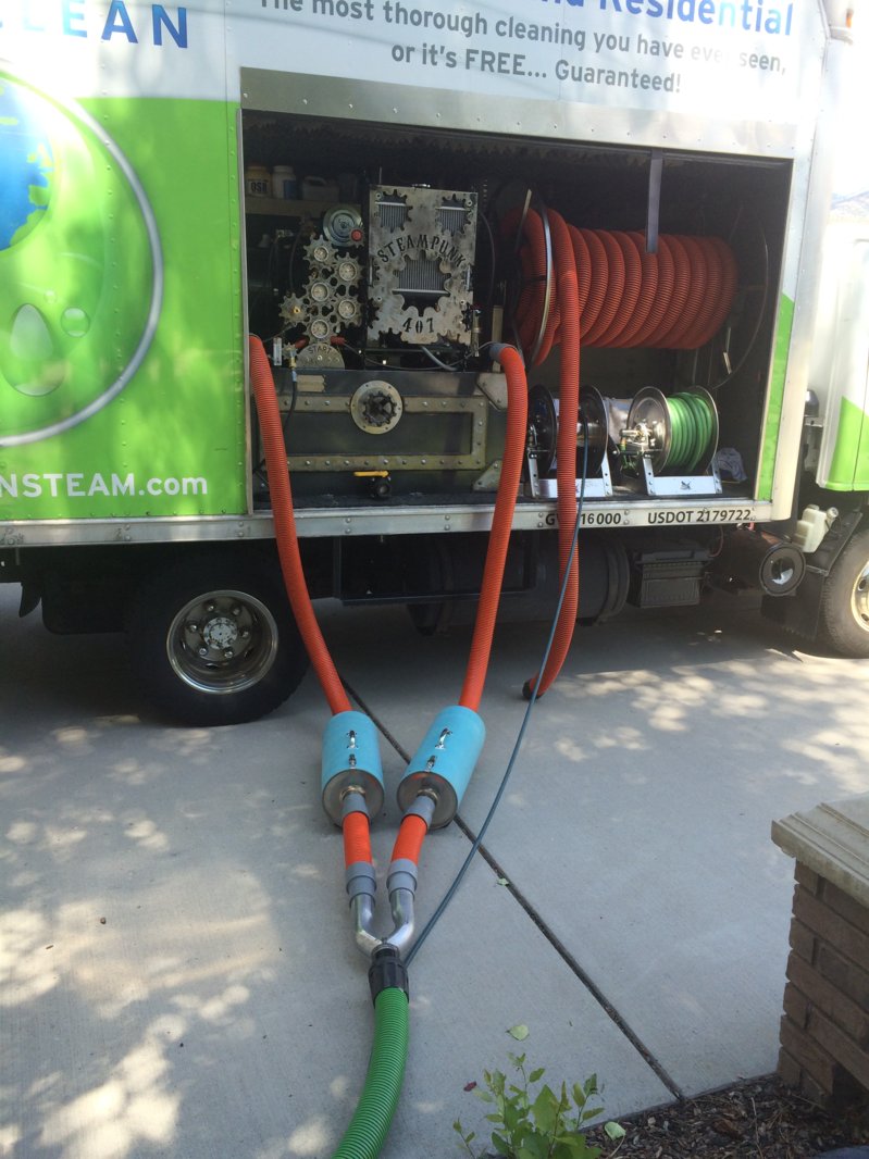

I think I'd rather do 2 short 2" hoses off the TM to a Y that goes out to a 2.5" cuff. If I didn't have a 2.5 inch inlet, of course.

We have about 5 large partment complexes that we clean in 4 days each august. We run the HOSS and go through over 300 gallons of water each day.:eekk: In those sitaution we were running 2 filters with a Y so we didnt have to stop as much to change them out. Event that is a PIA, the rest of the year we run 1 filter which is plenty of suck, especially with Tom's newest filter design.

love the looks of that machine.

you should back light the grill and around the gears with green LED's so at night it looks like a face. :)
