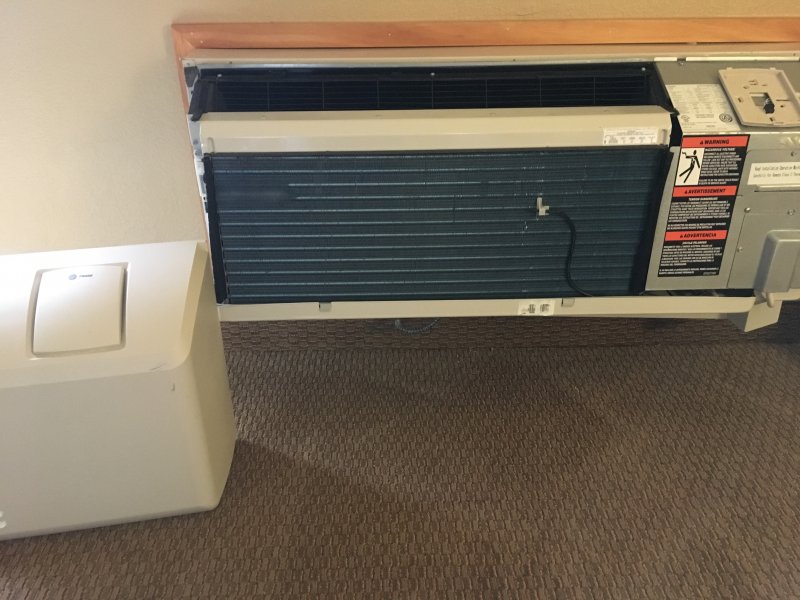

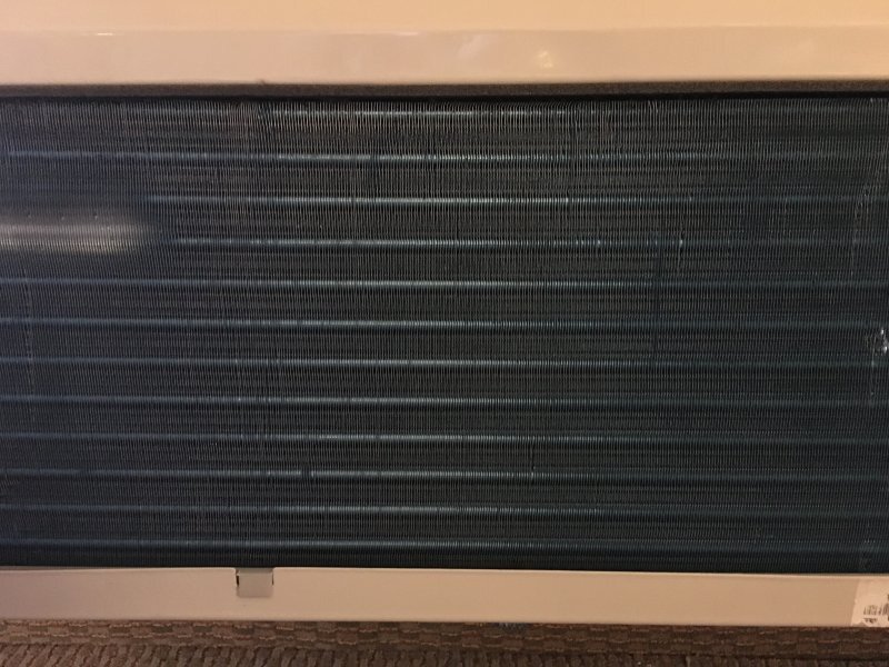

I like how mine looks in the resort we checked in today. I'm gonna bet on sleeping good tonight

It's really just neglected coils with mold. But I'll check in when I wake up tomorrow
