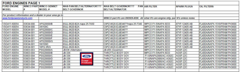

Turns out your VSG-413 is used in lots of industrial equipment from mowers to welders. Interestingly, none of them use the filter you mentioned. All the ones I found use the same filters. Here is a sample listing for Winco generators, they (like all the others I found) specify Motorcraft FL-400A, Napa 1516, or Fram PH3600:
This would correspond to a Purolator L20195, not your L10183.

The filter you have been using has no relief valve. All the ones I suggested do, except the L10183.
According to a Ford bulletin I found, very early versions of your engine had a relief built in to the oil pump, and used a non-relief filter. Later models deleted the oil pump relief, and they changed to a filter that had the relief, however Ford says it's OK to use the relief filter even if the engine has an oil pump relief, so the filters listed in the Winco table will work on any VSG-413, but the filter you have been using should only be used on an early motor that has an oil-pump relief.
The bulletin also mentioned that if the oil pump has been replaced on an early engine, the replacement pump will not have a relief, and must switch to the relief-type filter.
If you use a non-relief filter on a non-relief motor, you run the chance of bursting the filter if the filter gets plugged up, not to mention starving the engine of oil - probably not an issue for you if you change filters every 50 hours.
