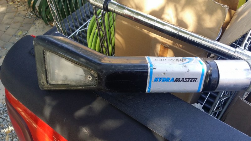

I have an old DriMaster and I love it. Thanks for the Tip Mike about being careful of the heat. I find it just destroys dirty ones. Eats them for breakfast.
I was surprised to rewd Mike that its no good an Microfibre. This is most of my upholstery work now and I have been finding it great to use and generally succsessful. These tools must be quite old now? I wasn't doing all this when they were made.
What can you tell me about them. I will be stuck with it a while and want to get the best from the tool. At hig flow is seems to dribble but was of the understanding that this means the block is worn?
Thanks
Grant.au

I bought this one second hand and it's spitting at high flow. Dribbles at times if used on it's side. Just wondering if the jet's had it?
Just wondering based on these comments if what it's doing is actually quite normal?
I have a new porty now which is why I am using this tool. The Bissell did well but is a backup tool now.
Grant

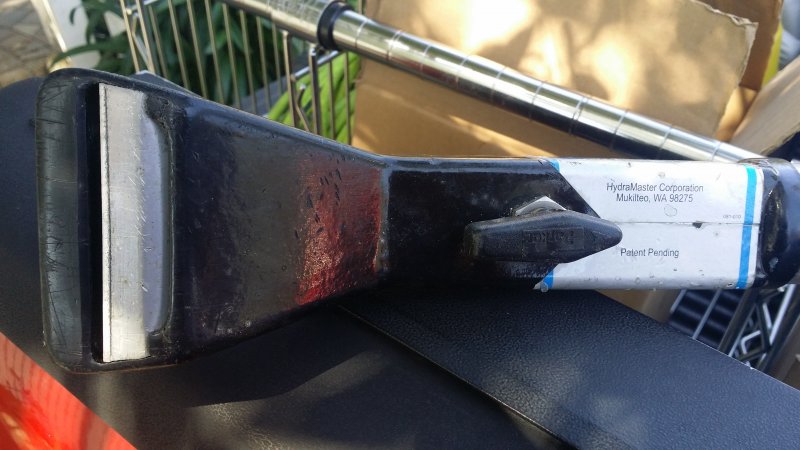

I agree and was supplied feeler guages with the unit. But it works better when it gets a bit full of junk and this leads me to think that the bar may be worn now and too large. Upsetting water flow characteristics which HM would have tuned the unit for.
Or is it justn normal for them to dribble, particularly toward the edges of the tool?
Thanks guys, so may questions....
Yous blokes are tops mayte..... Yous uh welcum in Straya anytyme nah probs mayte,

With a super sucker like the vortex the vac ports get so locked down that the water can't get in... ends up going all over the place..
minimounts and portys may not have the issue.
Ahhh.......
This issue has come up with my dual motor portable when running both vacuum motors. I found there were a few things I could do to mitigate this a bit.
1. Turn flow down so there isn't quite the torrent of water trying to gash into the tool. To date it seems better to have slightly less flow and more vacuum on upholstery. Well on microfibre and car interiors anyway.
2. Just use the tool in the reverse direction.
3. Dry lift chemical treatments and pre-spray moisture from the fabric with a dry pass before a wet pass. You get a second hit from nice strong chems so you need less water to rinse. And you make the fabric drier so the lockdown once you turn the water on is less severe.
Actually Mike and co-contributors, I always dry pass before rinse pass on any upholstery or carpet. It makes the job easier to risne and dry and I get better chenical enconomy.
But.... In being completely honest with you, it's obviously more useful for small operators like me with more concern about chemical waste and less capactiy for recoery. So like you say, portables.
Love my portable guys. Took me a bit to get one, but it makes life simpler for sure.
Toys like old DriMasters are new to me..... It's a bit of fun.
Thanks.
