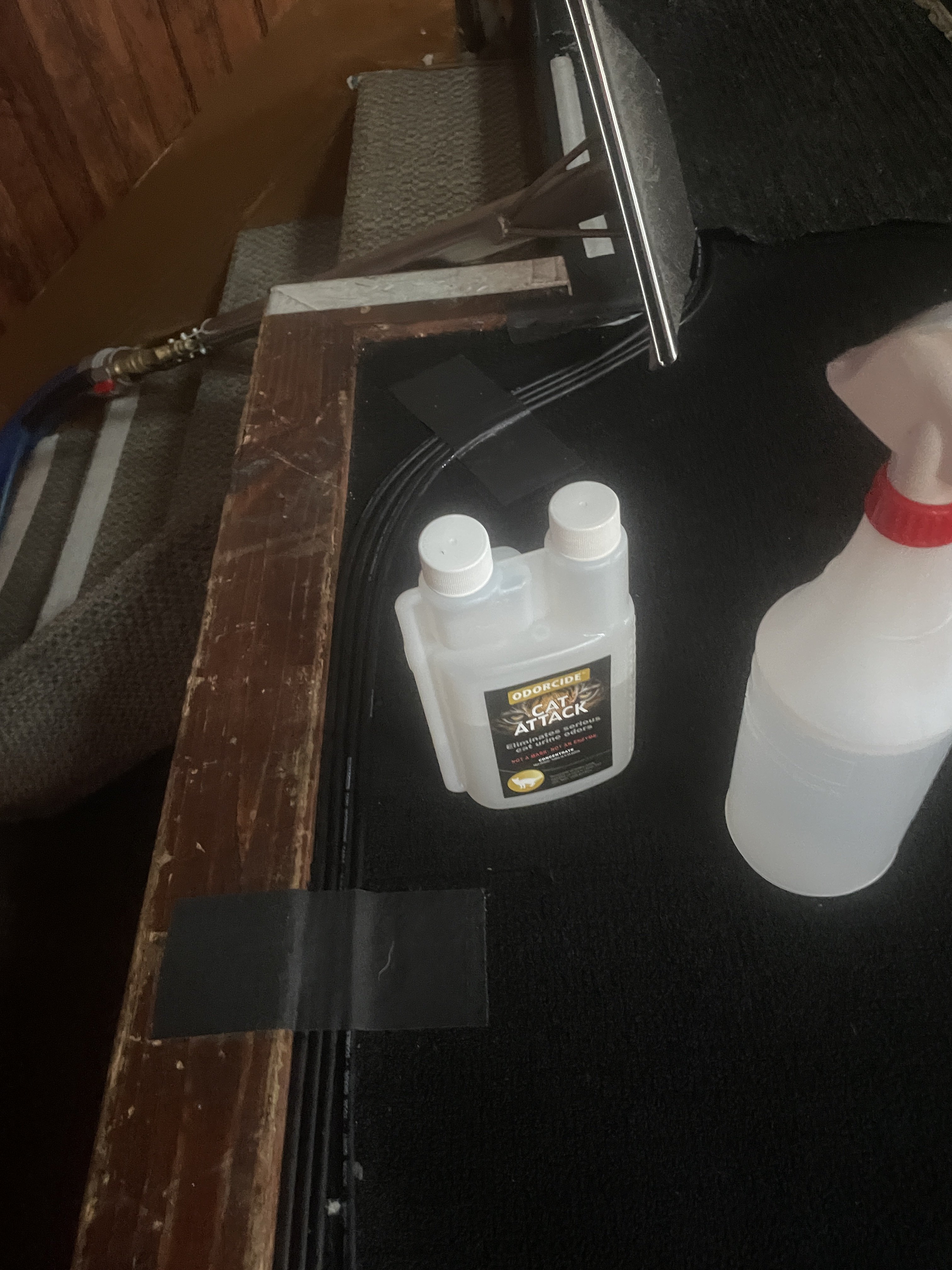

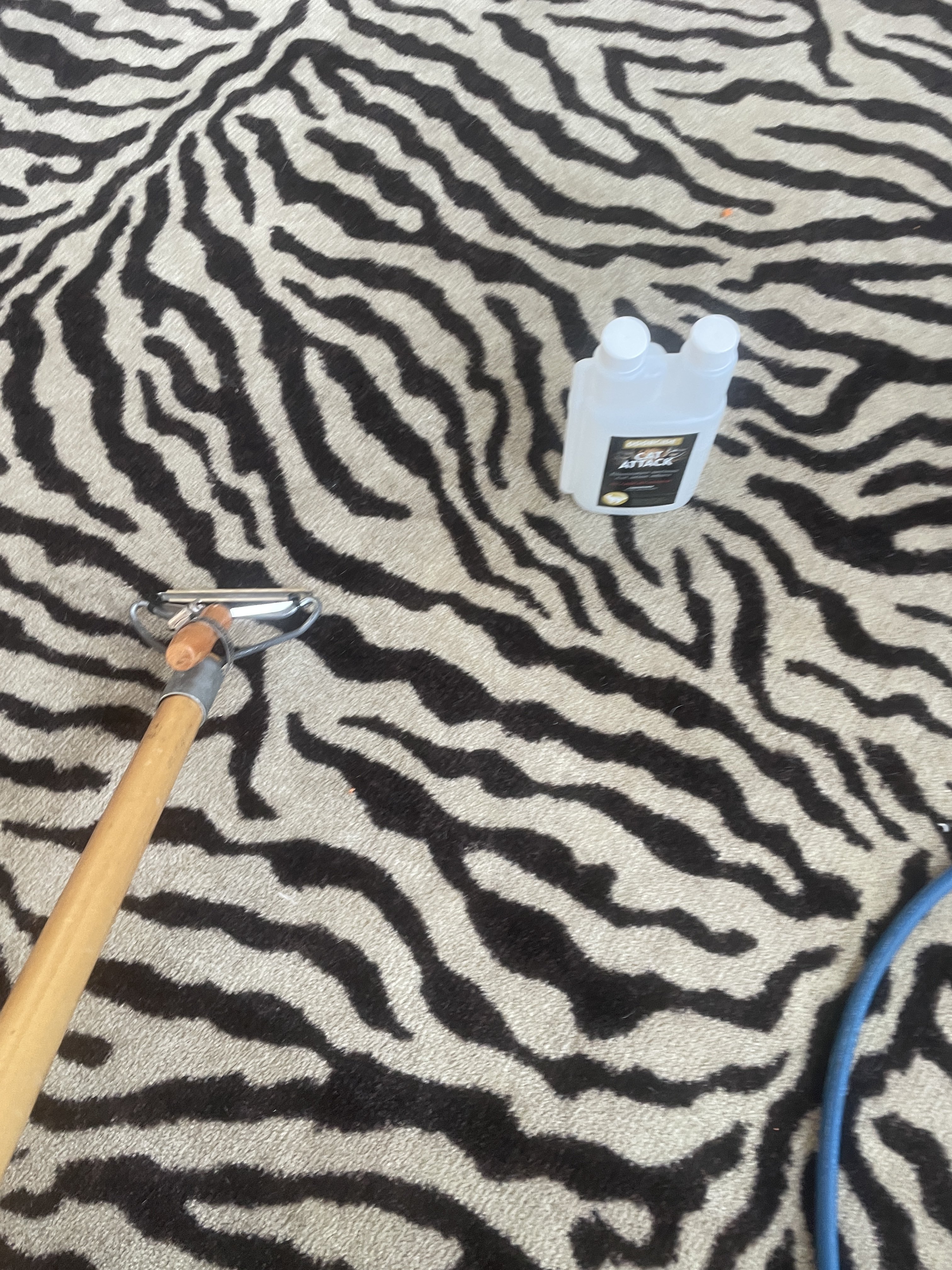

Another rare commercial job. Drink making area for servers to grab and serve. Rotten stinking nasty alcohol saturated and stank.
Used HWE, and VLM, and @Odorcide Cat Attack. It did the trick. Perfect timing for the sample. The next job was a house that had 2 Great Danes and a 19 year old (small dog). The call was for the odor.
They were also very happy.

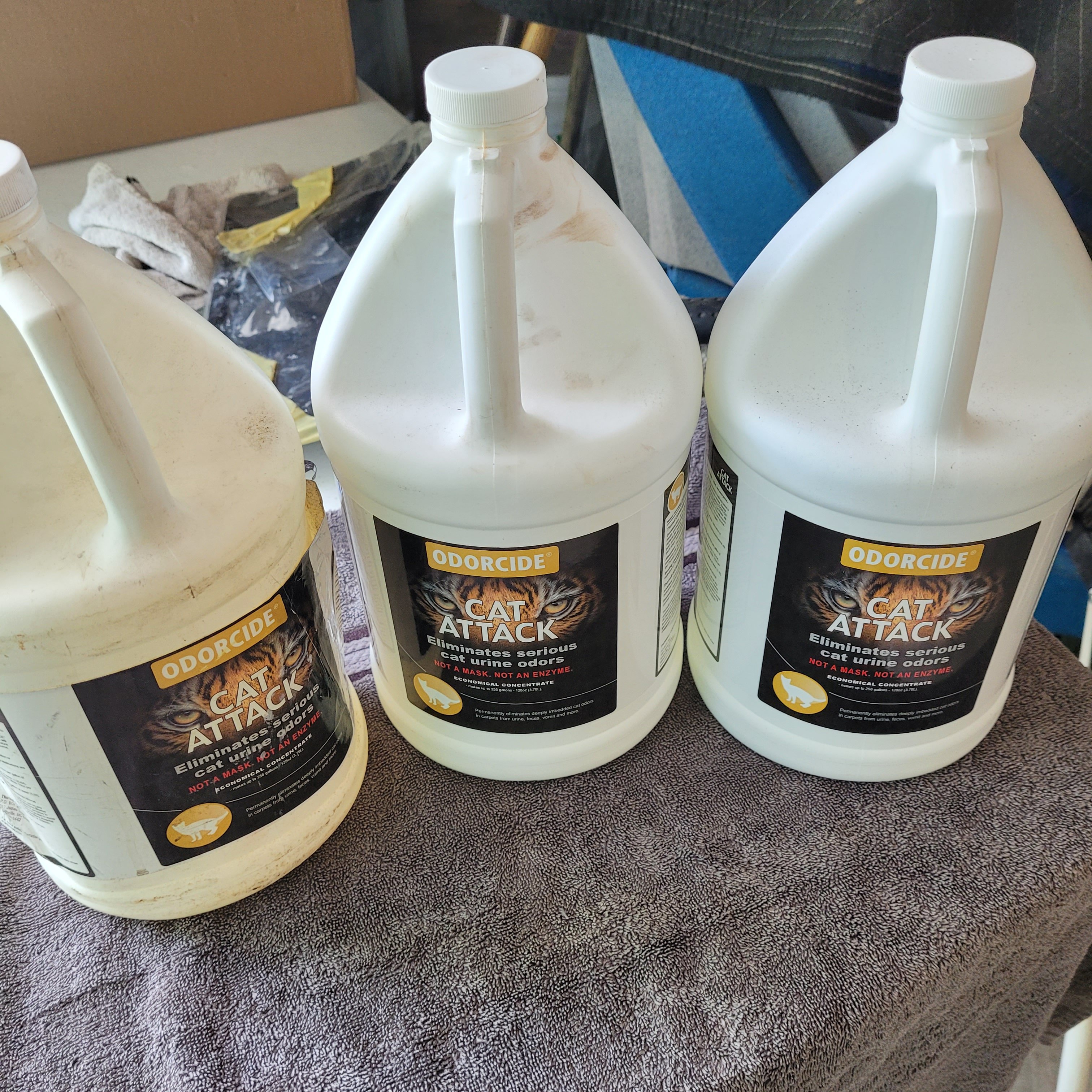

Jan 19, 2023
328
Mario
Odorcide Cat Attack can be used as a urine treatment or odor modifier for any surface. To break away from the citrus scent I add a few drops to a pre-spray, to a waste tank, or vacuum hoses. It helps to break the
scent in the house developed over the years, especially in cases when exotic spices are heavily used. I have a small hand pump ready for a Cat attack when I'm exiting the customer's house. It's always nice to leave a whiff of green apple/peach behind.
I have " only " three jugs left 👈
