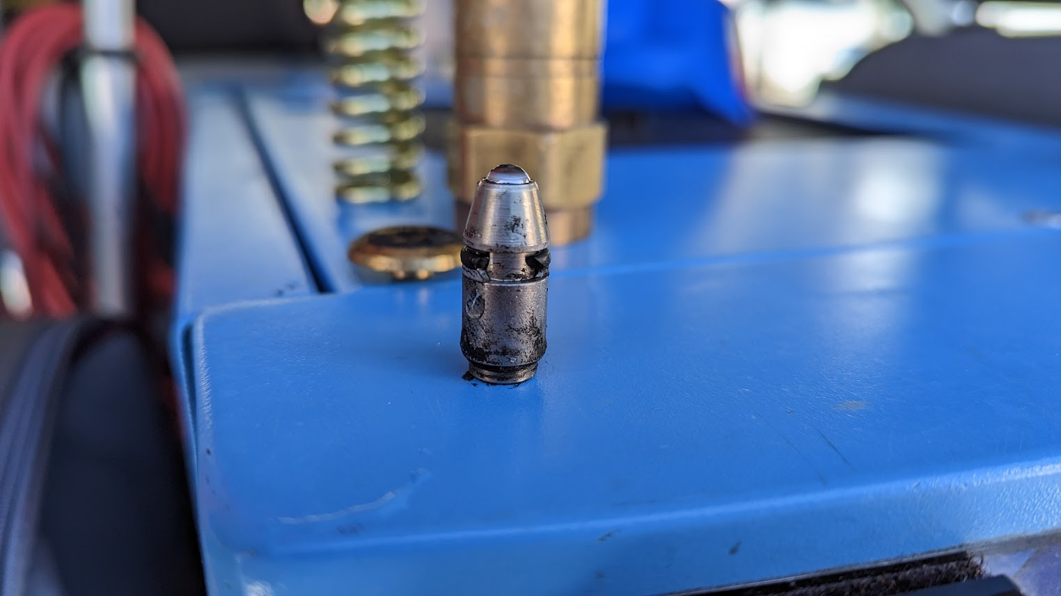

It's amazing how much can freeze in 2 hours exposed to those temperatures...
Everything we use will be froze in 30 minutes in those temps. might be different if the ground hasn’t froze yet. What’s wrong with your “thingy” there. All I can think of is tip to huge ballpoint pen.
117,010
O ring and and spacer blew apart..
Reactions: Jim Morrison
12,778
Usually you lose your pressure guage first, but that is a fairly exposed part of your system on the front panel.
