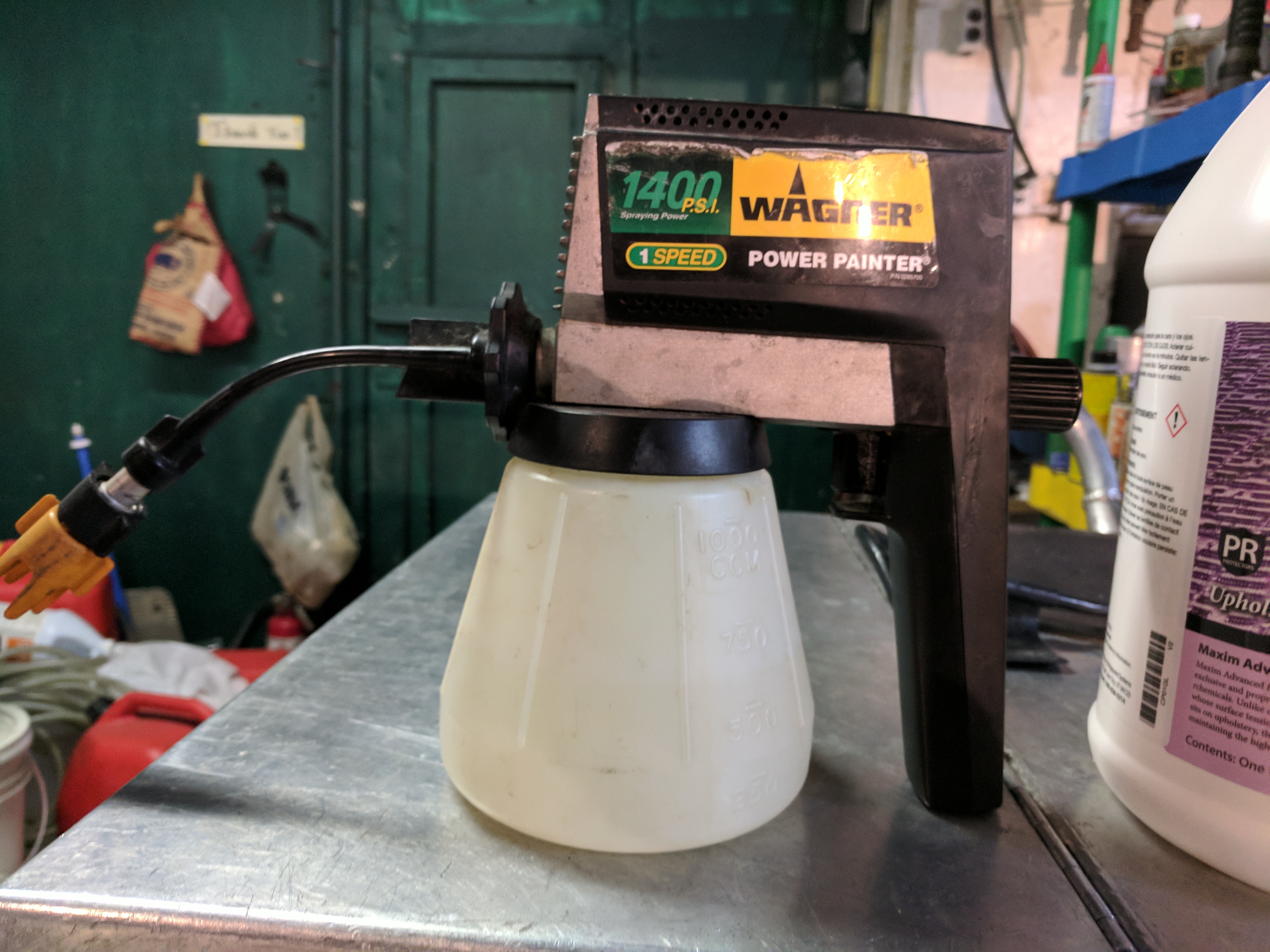

$10-20 per linear foot. Depending on fabric and complexity of job. I like the handheld electric airless sprayers because they put out a finer spray (adjustable) than an electric pump but don't create as much mist in the air as compressed air. Easy to use and good coverage. I have an extended flexible tube with a fine tip.

Here it is. Probably same as what you had. To avoid clogging, rinse after use. After water based product, just blow some water through it. For solvent based products, blow some oms through it. This one is at least 5 years old, still works great. You can buy different tips for it.
Paint sprayer, correct? Thats good idea

Have to be careful not to over wet natural fabrics, especially if you have just cleaned them and are still damp. You should wear a respirator every time you apply any protector. You don't want to be breathing it. The electric multi sprayers are great for synthetic fibres and carpets but you will need a small jet for natural fabrics.
Here it is. Probably same as what you had. To avoid clogging, rinse after use. After water based product, just blow some water through it. For solvent based products, blow some oms through it. This one is at least 5 years old, still works great. You can buy different tips for it.View attachment 77084
