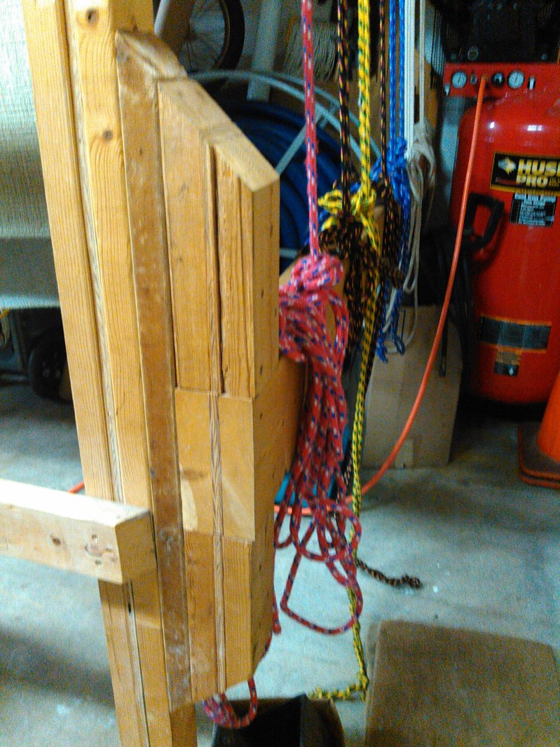

This is my home built rug rack. The standard rope and pulley lets me raise most everything with one man. The front pole has a block and tackle for the really heavy ones.

Yes Rick, knot heds we be. I do a wrap and cinch with the rope before tying it, the knot does not carry the load.
And yes Louis, I have dreamed of using a few cheepo winches to do the job.
Martin, If you hit pause a few times you will see how I constructed this fine rug rack. Rather simple, screws, glue, wood, carriage bolts, pulleys, rope, ect. Any specific questions just ask.
This is the only detail you can not clearly see in the video. The tie off bar is set back for pole clearance and blocked in place for added strength.
