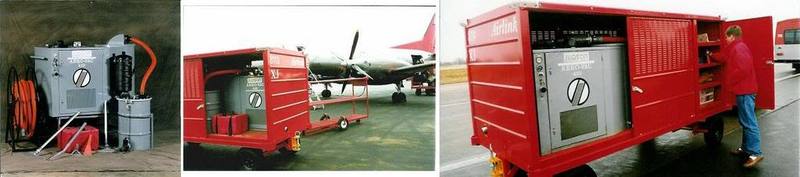

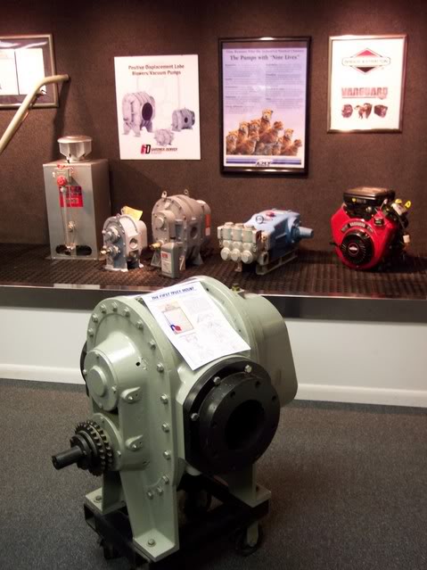

Judson has been involved with Gardner Denver since 1965 when we had a custom-built number 8 blower made for us at that time. Through the years Judson has helped Gardner Denver with issues not only in carpet cleaning applications but also in industrial vacuum systems. In all cases where I have assisted Gardner Denver with issues, the problem has always been application. Eventually we always find out that there is something that is causing an issue with a blower. As long as a blower is being operated within the performance limitations and it is properly maintained on a regular interval, there are no issues.

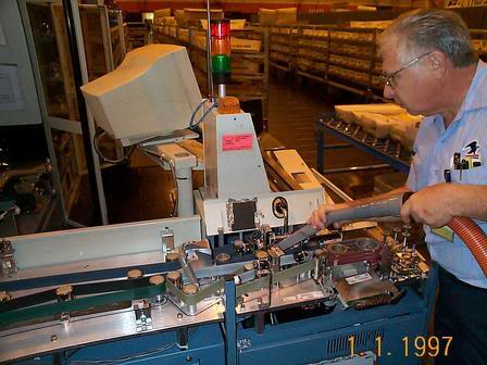

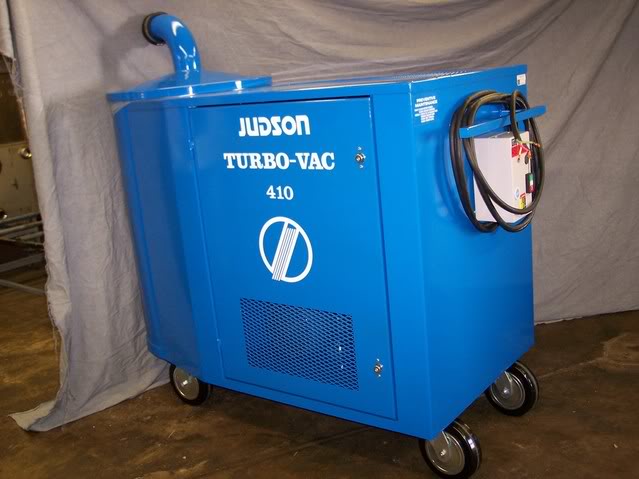

Judson is probably more experienced with blowers in the carpet cleaning industry than any other manufacturer due to the fact that we use positive displacement blowers for industrial vacuum systems. These industrial vacuum systems that we manufacture run 24 hours a day, 7 days per week. They are electric motor driven with 20 HP, 575 volt motors. We have hundreds of blowers that are still in operation that were put in service in 1980 and actually have that many hours on them.

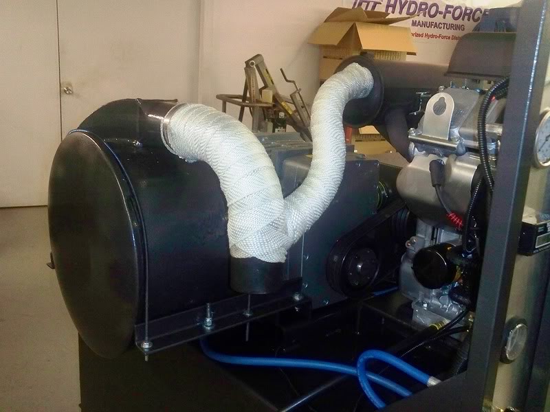

Another thing people should take a look at is HOW Judson gets such longevity out of our systems? There is a reason. When Judson designs a carpet cleaner or an industrial vacuum we always run below the maximum limitations of a blower. In other words, if a blower is capable of running 16” of mercury, we operate it at 15” of mercury. One of the most important things when it comes to adding life to a blower is having the LEAST amount of RESISTANCE on it possible. What this does is allow the blower to produce the true CFM that the specs say it will produce by maintaining the CFM without resistance. When Judson gives a performance number of airflow for our systems, carpet cleaning or industrial, we are giving the number at the point where the vacuum hose is being connected to the machine. The most important thing about running a low-resistance system is that the blower maintains a lower operating temperature. This is what really adds life to the unit. All Judson truckmounts even from day one have been MINIMUM RESISTANCE systems. Even the new C4 has virtually zero resistance on the blower due to our new custom-made silencing system.
