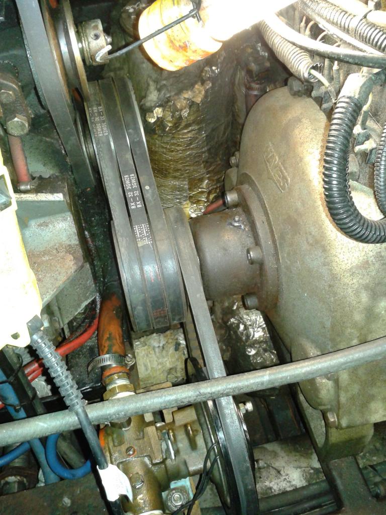

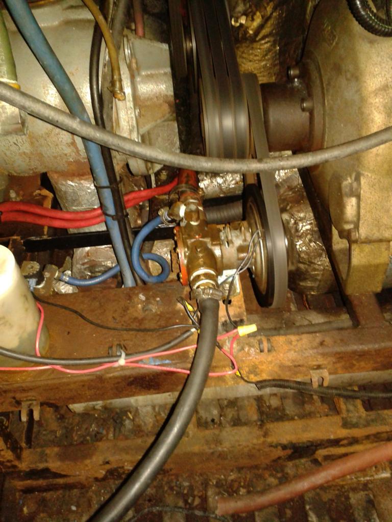

Well.......if it's a Ford engine, it's a 2003 or earlier model. I bought the last Ford powered Genny in 03. If it hasn't been beat to death, it would be a nice machine for back up or everyday use. I still use mine daily, and some jobs run to 6 hours non-stop cleaning and running. I've had to change out the drive plate in the Hayes converter, swap out a couple sets of belts, change out the APO, and just general maintanence. Oh, and a few internal hoses. If it has the electric diverter system, it may need some attention. Send some pics.

The biggest thing to watch would be the diverter system, to make sure it is functioning properly. Make sure it closes all the way, or you could get an overheat shutdown (300*). Make sure you have water supply to the APO before actuating. It needs a prime to keep the impeller lubed. If not, you'll be changing out impellers often. And they can be had at any boat supply store that sells Jabsco bilge pumps. And if you run in a hot, humid climate, get lot's of ventiation to the belts and out the back door.

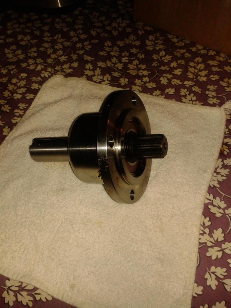

Steve.....no, not really. Garanteed Cleaning out of chicago should have anything you need. The old Powerclean builder and the sales guy run it. Jim Napes and Larry White. Also, Express Distributors in Zoar Ohio might have parts left. I have the Hayes drive system on mine, and had to replace the drive shaft a few years back. I called Hayes and they shipped me what I needed. Most of the other parts can be found just doing an internet search.
