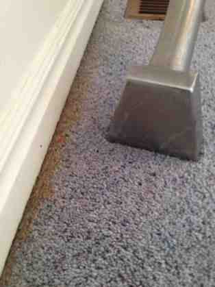

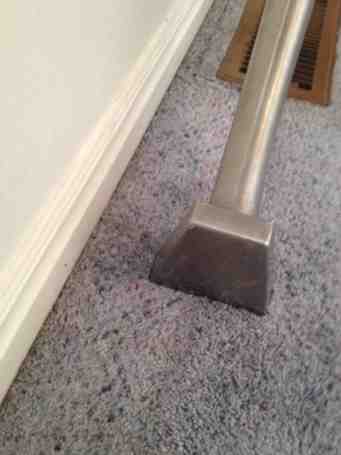

Pita Crevice wand along basboards and hinge side of door corners right after I use my hydroforce then run out turn up the truck and wand it out. Crevice wand used to pull carpet off the tack till I figured it out. If they made a glide for a pmf crevice wand I'd buy one in a second.
114,150
http://pmftools.com/prodStair39.php
114,150
On the phone with PMF now..
They are going to make "us" a custom version with that glide (replaceable and made from Acetyl) specifically angled just for carpet/baseboard edging. As it is it's set up for Grout work.
It will also have the better V800 trigger
Olson will have them for sale once I've fine tuned it.

I've owned both edge tools. I prefer this one. It works well. It sounds like a jet engine when hook it up though.

how come you guys don clean FACING the baseboard
cracking the wand up at the edge to create a vortex of air suck
to suck that edge clean?

I Do, But I leave the towel on the floor and use my tile/grout brush to push it around...
