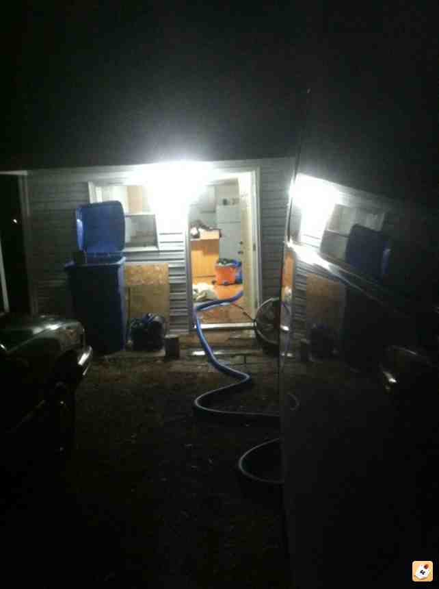

Or I woulda been chiseling the agua outta this lil hut : )
Guessing 230gal between shop vacs and the mount. Betcha that hillsides slick tonight : )
Outta pocket expenses : )

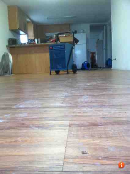

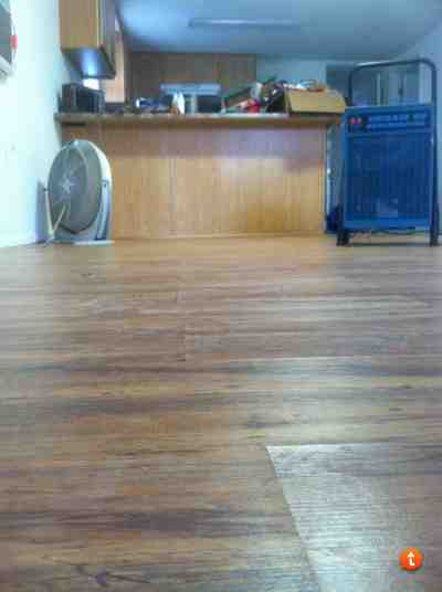

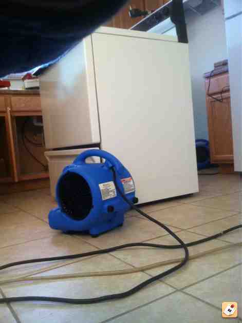

Day 2, 3 rd rearrange : )
We figured the floor would be a total loss. Rentable he says : )

Is that Laminate Floor? Kind of looks like It in the pics.
There has to be water under there if it is with the amount of water you are describing. I would be telling them it needs to come out....or sign here please......and then hope they still don't sue when things go bad later....LOL

You're right about the floor, it's only going to get worse and buckle. I missed that entirely! :redface:

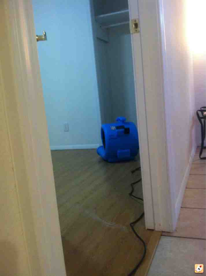

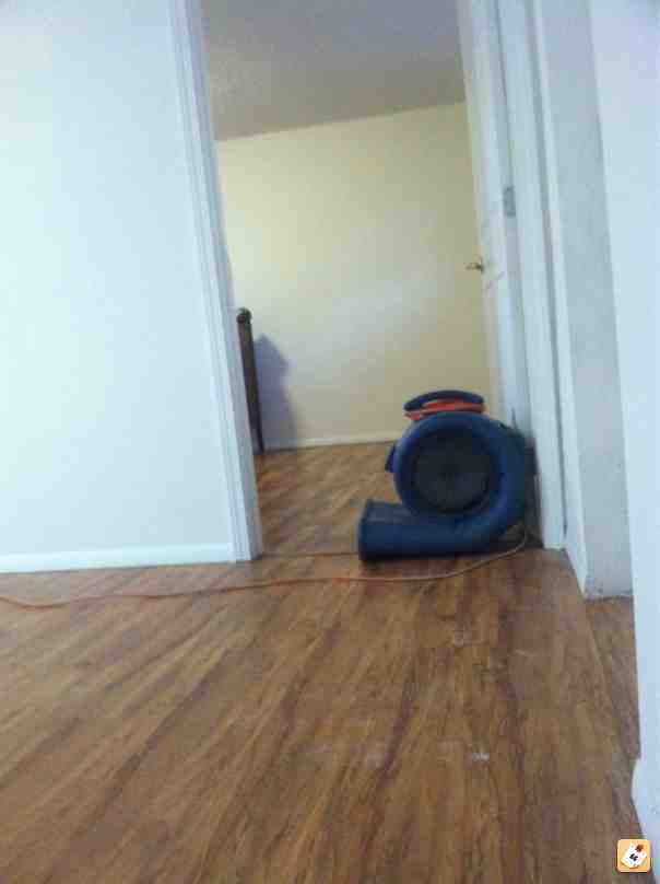

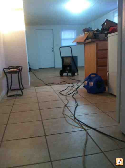

I read up on the resto info to when it buzzes bye. Really NICE : ) gaps around the walls on this one. Massive air flow throughout. Plus atleast something to remove the h2o from the air. Wish I could have dried it faster but it sat for awhile.
Customers happy and another door is opening because of it.
Laminate snap poo of some sort. He said 3 something a foot so ??
I honestly expected it to be much worse than it is on the buckling.

Getting Rough !
He figured it would be a loss. I was sorta hoping to get lucky and win for his sake.
It only gets worse until it dries. The water/moisture gets trapped beneath and can't escape and will eventually buckle if there is enough beneath. Get a crow bar and just snap her out of there. Comes out easy once you get a start on it.

Rip out that floor, base, shoemoldings, and that's just a start.
G
GCCLee
Really?
HO did not want it on Ins.
This is a rental unit so it was OOP expenses.
My job is complete and HO is very happy.
My speculation would be this: next time it happens someones renters ins will replace it. That is where the Racket starts and where I go suk rugs : )

They all are different, that being a rental dry is good enough. If it were his own house he might have you tear it all out. Your services can adjust to level they desire as long as you cover your butt.
