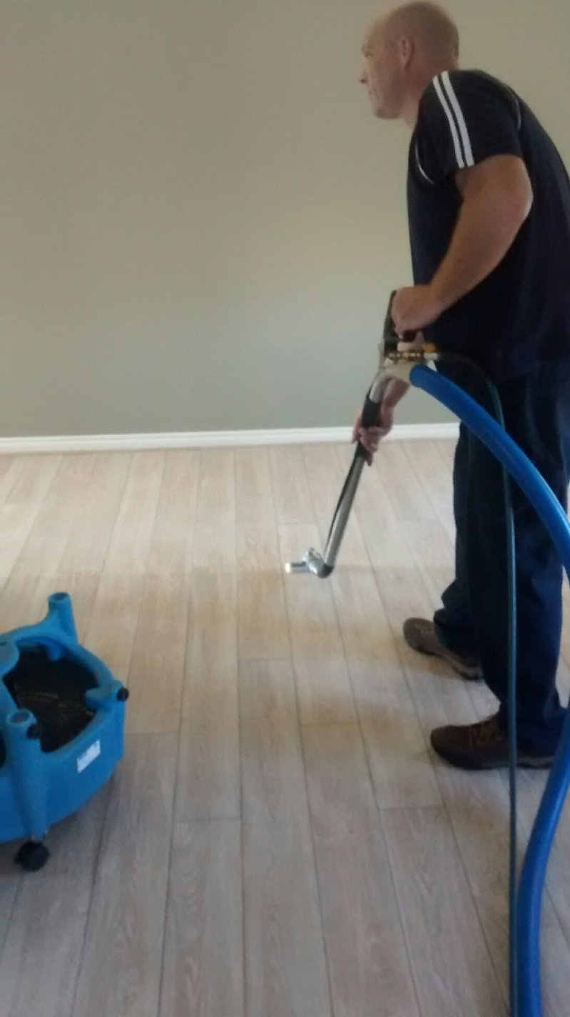

glued down/ textured vinyl plank flooring, incase anyone wanted to see how to clean

1000psi no rinse agent, flex with citrus solve, rinse thoroughly, speed dry, do not dwell on one spot. And if its really bad scrub with brush pro 20 before you extract, dwell time is 15 min putting the flex down hot.

this floor was filfthy
