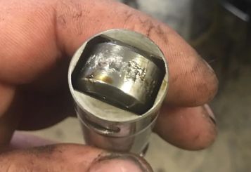

After buying lots of GM vans over the years and having very few problems, it seems they changed something. The dealer won't talk about it, but it appears that the lifters can collapse across the whole GM range of V-8 engines. The engine will run badly and generate a P0300 code (random misfire), then the collapsed lifter will eat the camshaft, followed by metal fragments destroying the main bearings. We've had two 2017s with less than 30k get a new engine at GM's expense, but my concern is that all of the 2017s are going to need engine replacements, and the replacement engines will use the same bad parts.
If you hear ticking sounds or the engine runs/idles/stumbles it needs to be checked right away. Unless GM gets sued, at this point if you're outside of warranty you will have to pay.
This is supposed to be limited to engines that shut down cylinders to save fuel. Ours don't have that feature but still have the problem. GM issued a service bulletin about it, but the dealership won't talk.

This may be the result of an active fuel management (AFM) lifter that is mechanically collapsed and/or stuck all of the time.
This may be the result of internal locking pin damage in the lifter, due to oil aeration.
This may be the result of a lifter that has collapsed and is stuck in the lifter bore.
