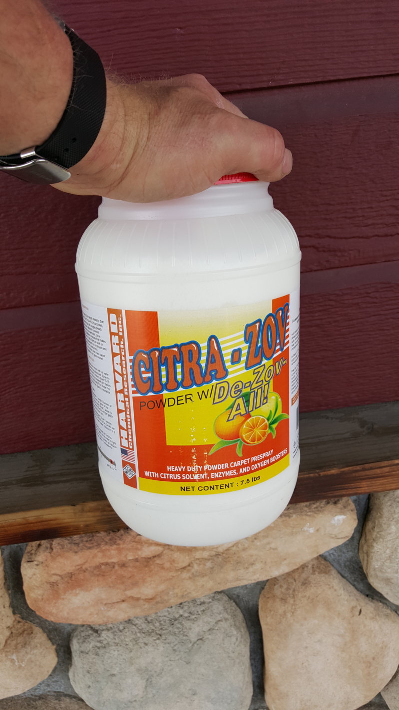

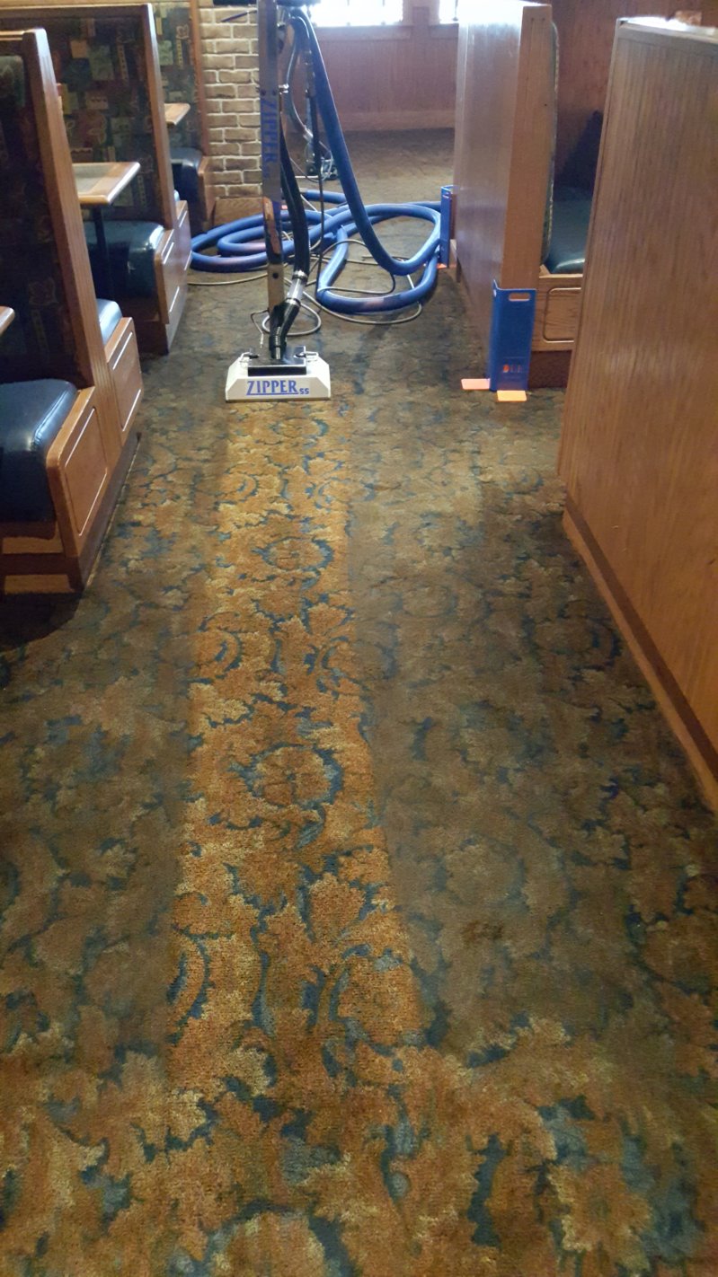

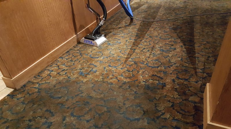

Hope they are able to tell I was there today...
CitraZov Powder and Zipper SS Super Spinner :rockon:

Mark, looks great. Did you have to use a detailing tool or wand to deal with edges?
Also, if I may be so bold, did you use a CRB pre-extraction with the Zipper SS?

So I'll guess that a red pad, liquid deelimO and a standard Zipper may have done as well
Actually regular zipper with no agitation was doing great too....just a little slower....but it was doing great as well
So, a lot of times a regular Zipper can keep up somewhat to the Super Spinner.
Just sometimes I see the Super Spinner digging out some other soils a bit better.
