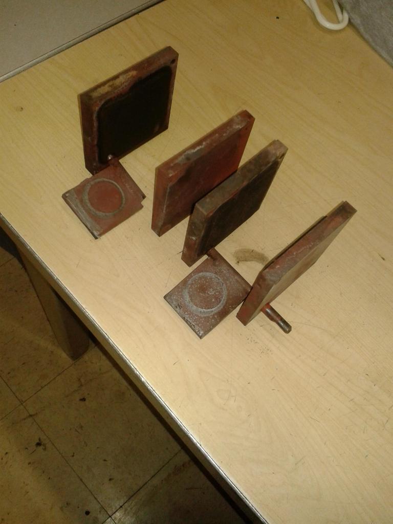

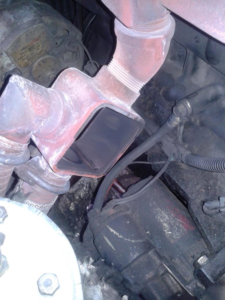

About every 2000 hours or so, the dreaded " Genesis Flapper Fiasco" occurs. Usually during a busy day or week. About 1-2 hours to repair, if you have the spare parts. I had one. Oh, and you have to let it cool down for an hour or so before even touching.
Broken flapper on the left.

Can't use a larger diameter, and more heat resistant shaft material?
One of the key design faults of most diverter systems is placement of the diverter in the HOTTEST part of the system.
Sapphire is the only major that finally addressed that.

That happened to mine early on, it had the electric solenoid actuator. That one slammed open and close. 2700 hrs on the current one with the vacuum actuator, it closes nice and easy.
