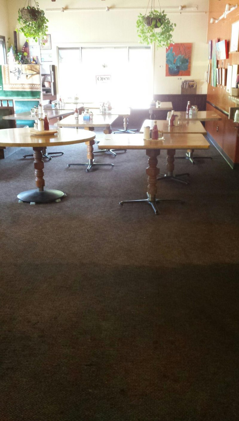

First time I've prescrubbed with a cimex. Flex. Prescrub RX.
