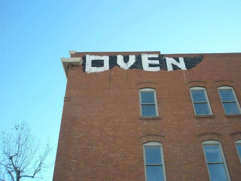

From the top of a 3 story building about 40 feet up 4 feet by about 30 long but there are splatter marks down that span. How much to charge? This is a historic building so there are alot of hoops to jump through. By the way its a brick building.
Nov 8, 2006
3,373
Albuquerque
Ron lippold
black paint on red brick building looks like it was put on with a roller. 40 feet up. i plan on renting a lift and using a soy stripper and the minni spinner 1200 psi should blast this off real easy. No one wants this job not even the city grafiti removal team.

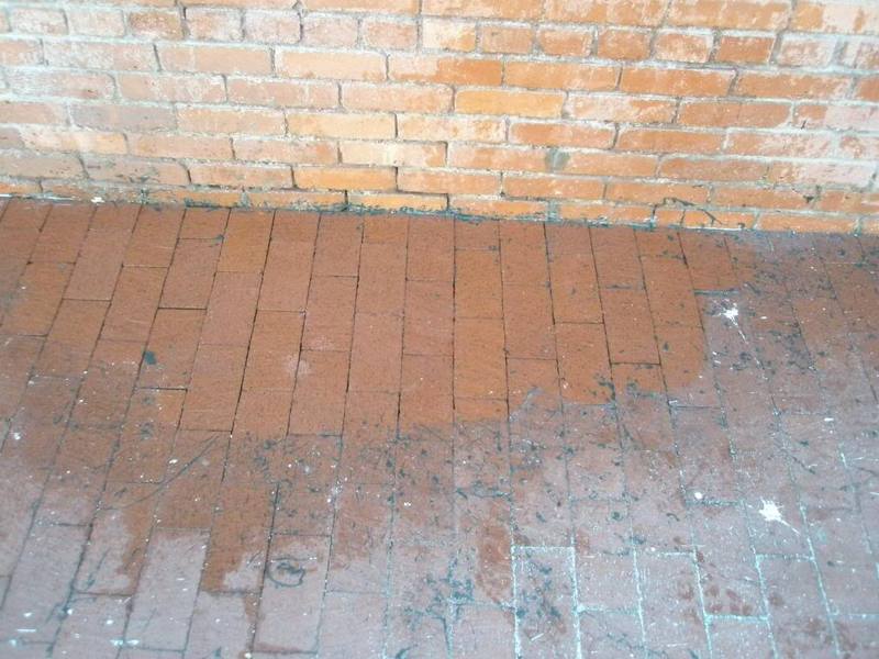

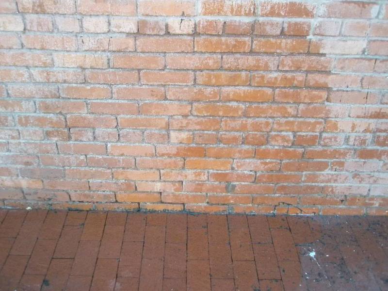

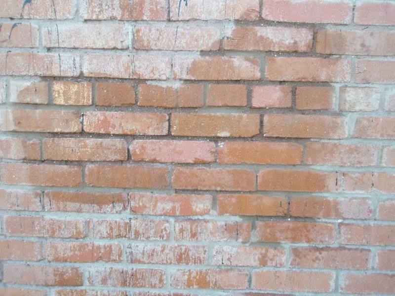

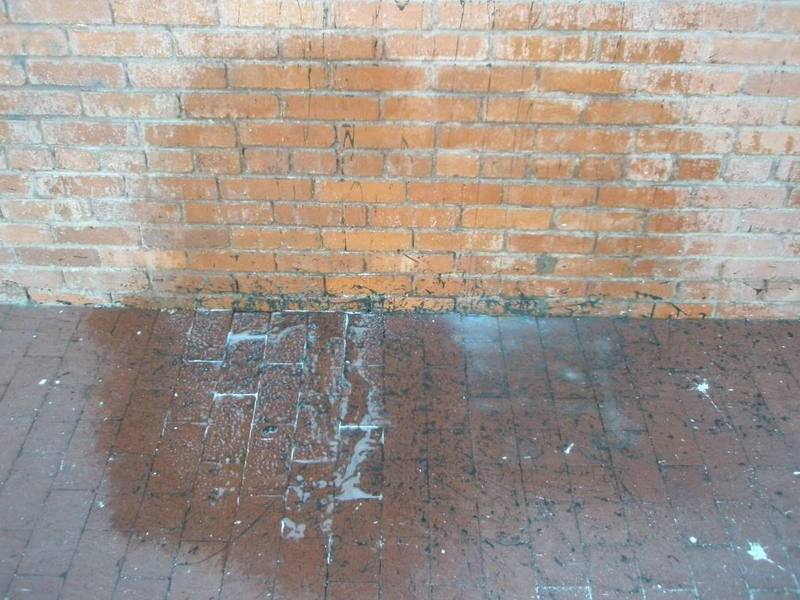

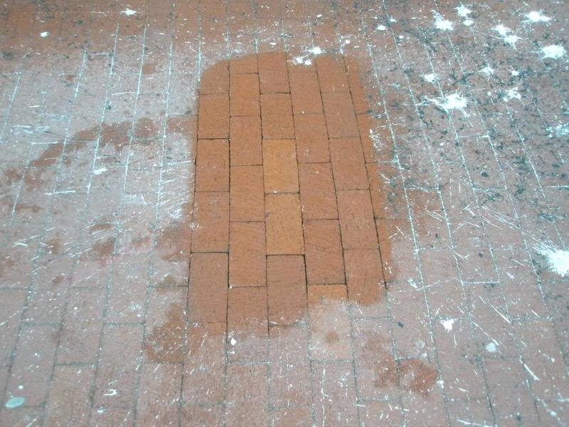

old brick 60 years plus soft paint and i think 5-7000 could get it off in one afternoon. but i think the rest of the surface would need to be cleaned to match. But that would be a whole nother story. Im putting a bid on this this afternoon. i will take pictures.
Nov 8, 2006
3,373
Albuquerque
Ron lippold
some before and afters. should not be to tough.

floor stripper i could not believe it :shock:
looks right fine indeed, Ronald
good job
sell 'em on washing the whole side, cause I'm sure you're right, the area you fix will be be noticeable
not unlike trying the spot clean a carpet that hasn't been cleaned in years

Hey lets get a full on after shot of where "oven" was PLZ!!!!!

Man, I'd be shitting myself up that high....literally!! :mrgreen:
No way could I get up there and concentrate on the work, especially while putting my almighty death grip on the lift!!
Scissor lift with cage around it, you're be good. Just bring it down lower before you move to the next spot.
