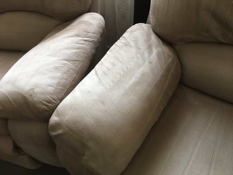

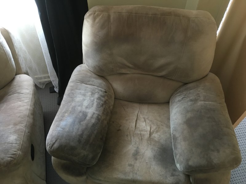

Wow........best before & after I've seen in a long time on Upholestry......what pre spray did you use?
Also did you agitate before extracting?

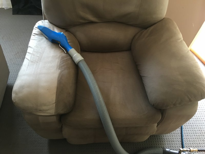

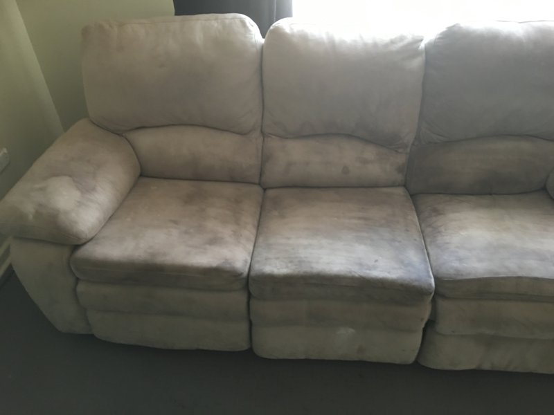

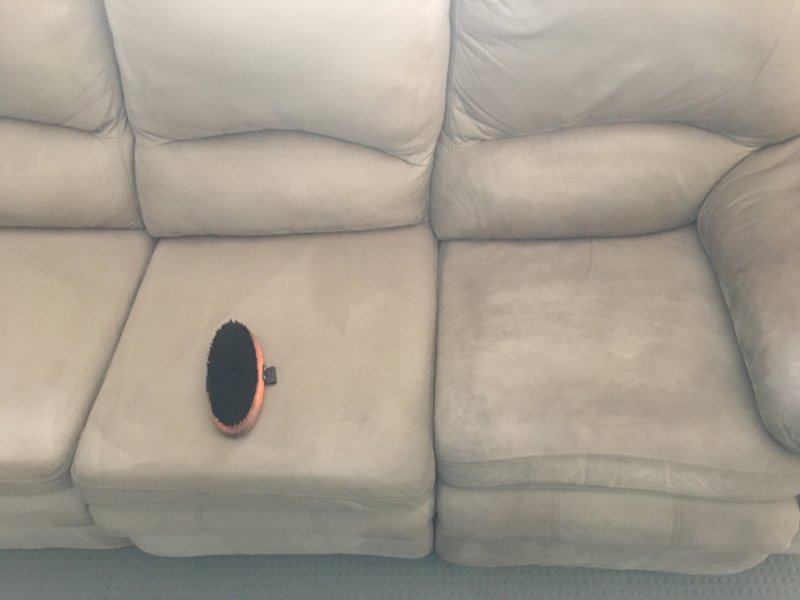

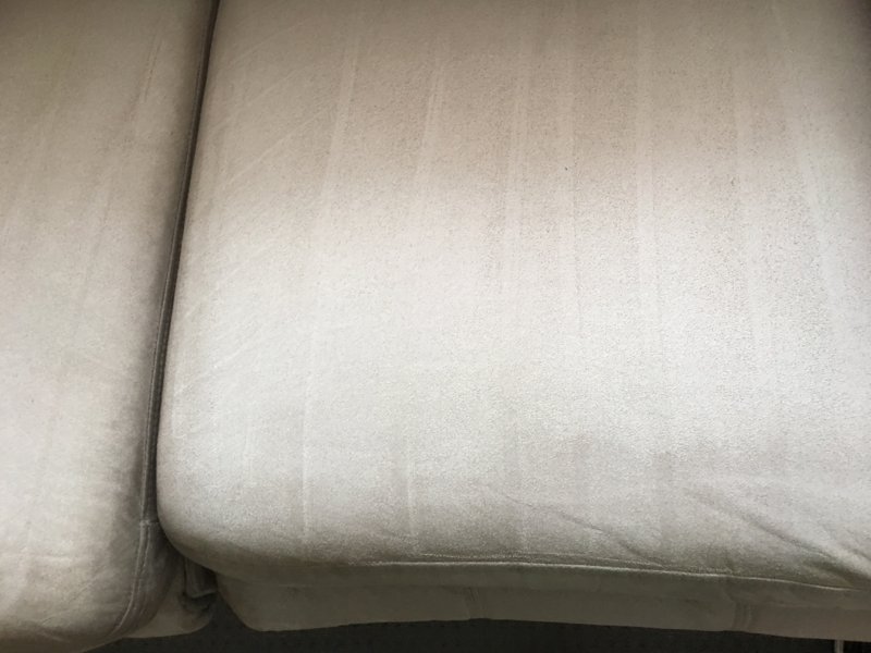

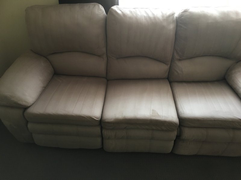

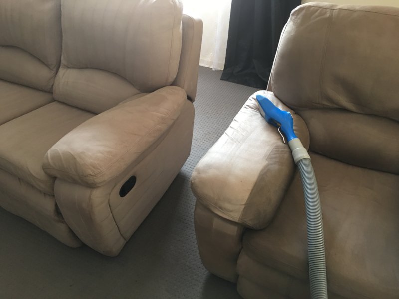

Hi everybody
Thanks for the thumbs up. I used an Australian made pre-spray called Up and Out. It's a pH 9.0 enzyme pre-spray.
I also used Sensation which is an ammonia spotter for blood removal and the like. It's very similar to glass cleaner. It has a pH of 12 but self cancels being ammoniated.
Agitation was with a horse grooming brush.
Extraction was just water.
