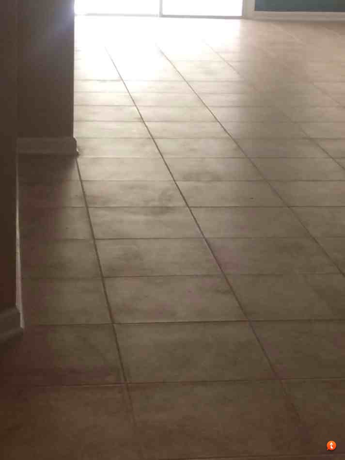

Brand new floor
So we cleaned and gave a acid bath with home run
Then clear sealed it
Next day the grout gaze was still there. After clean it looked great

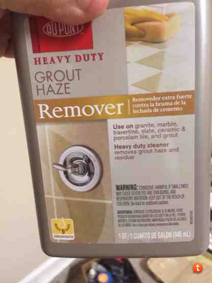

Cust used some grout haze removed that seems to be working ok
It's 1000 sqft of tile so I'm looking for a better way lol
Can I put a 175 in it and buff it out or what's my best bet

if it really is grout haze, Cobbs acid and a new black pad should do the trick.
Im guessing from your shitty photos that it's ceramic/porcelain so that weak stuff from Dupont is a waste of time.
and yes, you can try going at it dry with a Hog's Hair or maybe even a red/blue pad to see if just buffing may work

Yea the sun coming in from the back door was making pics fun..
It's ceramic tile..sorry
Can't confirm for sure grout but assume it was regular..homeowner bought home after it was done
I scraped with razor and got no residue or grout at all..couldn't even see where I scraped it..kind of surprised me to be honest
Dwell on home run was 10 mins or so max.

You mentioned it looked good when you finished.
Are you sure its grout haze and not sealer haze?
Probably would follow mikeys advice but then you have to reseal too :hopeless:

home run is plenty strong enough.....what was your dilutution.
should come off easy peasy 16/gal

Don't know exactly why but I use alcaline rinse heavier the better.....also alcaline. Cleaner...very little scrubbing amd safer...
Either cobs citrus stuff or flex powder w citrus works great.......
I haven't had any serious haze problem since....
But I used to when I used the acid cleaner..
