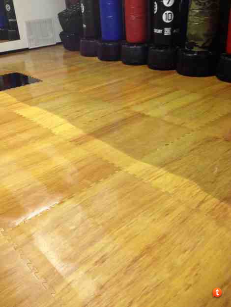

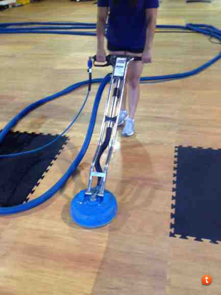

I have had good luck in this little niche. Those interlocking foam squares look amazing with a turbo hybrid. Once you do one it spreads. Just curious who else has done them?

What pressure you running at Justin?
And does the TH really suk hard enough to get up the water also would a mopper chasing ya help any?
Glad someone is finally getting to this topic.
How do you distinguish between a workable and non workable floor?
more show us more : )
J
JS41035
750. Or less.
A mop might be helpful but the main thing is not letting any water pool at the seams. I use the brush ring on the turbo and make sure to get the water up as you go.
As far as a non workable floor. I would say if the top I peeling or bubbling I would stay away. Or just use a gecko turned down to 400. I'm sure I have some more pics I'll dig up.
