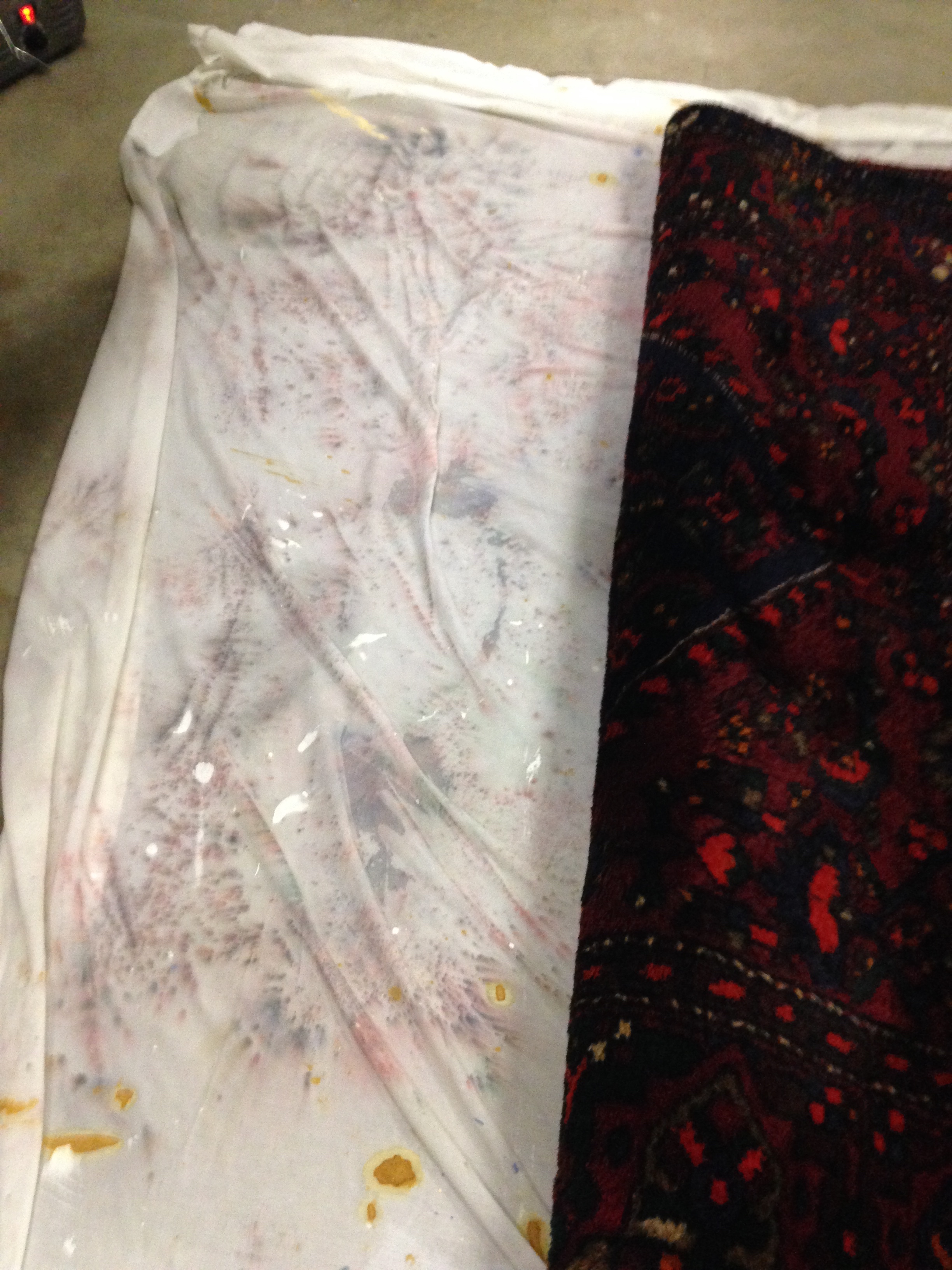

I started on the 19 rugs we took in just before Thanksgiving and the first one I pull out was a bleeder big time. Pucker factor was pretty high on this one but all turned out well. It had cat piss in it so it had to be soaked and flushed. All I have is some dye on one end of the fringe that I'll take out tomorrow withy some "magic" dye removal. I dried it face down on an old sheet and there was a lot of dye transfer on to the sheet .

Glad your rug business is working out for you. How did you go about the training?
David did it just transfer dye or did it migrate into other fields-the white?

Was away with two of my employees in Nashville doing some system training. So to answer your question Marty I went through Lisa Wagner training and did one of those rugtours. Way back in the day I did a few days training with General Tom Tsoa
Richard no dye stayed on the rug all transferred to sheet while drying

So no worries. Maybe a lil over dyed. But if it don't migrate into dye ports your fine.
