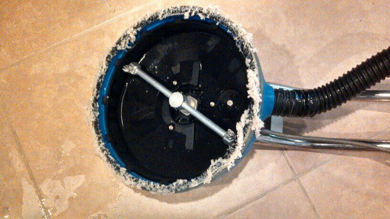

John Olson
Ok the following advice can be dangerous to your equipment. The best way to get it ALL OUT is to use your truckmount and Turbo Hybrid. Lay your stripper down as normal and scrub the grout lines then re-apply the stripper making sure to keep it wet for at least 10 minutes. Set your TM for 1000-1200 PSI. Make absolutely sure to run de-doamer through your hose and in your waste tank. Make absolutely sure your waste tank shut off float works. Run your turbo as normal and you will pull all the wax out. You DO NOT want your waste tank to over flow into your blower or suck foam through it. The wax will shellac the lobes. Also you must run clean hot water through the hoses immediate upon completion and rinse your waste tank. This cannot wait until tomorrow. You will be amazed how easy it comes out of the grout lines. This information is coming from, John the cleaner not Superior Cleaning Solutions. I have done this process myself before I came to the supply side and have helped several times since but you absolutely must not let anything go through your blower. Defoamer is cheap do not be afraid to use it.
