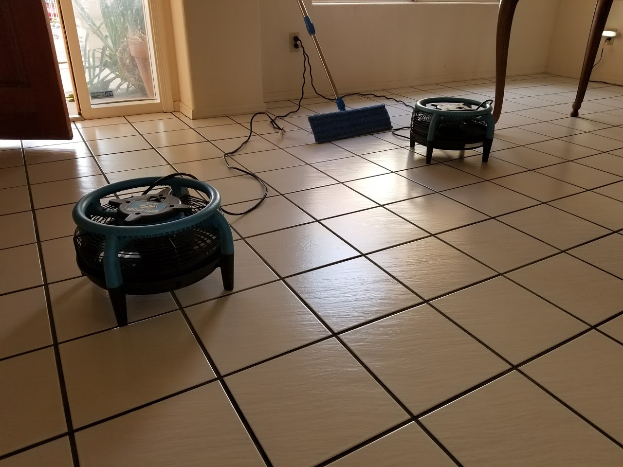

Yes...I do it that way every job no matter what the color is...if you go to fast then the water will puddle under the tool and it will not have time to vacuum it all up and your just smearing it...more so if it is sucking down to hard and not allowing the airflow under the tool to suck up...on mine I can adjust the relief..from just cracking it open ..to opening it all the way.....do you use a brush head or the Teflon ....
either way..it is always good practice to clean once and rinse twice...it just good assurance that you removed everything...another thing that is really helpful is to always set fans around and use a microfiber mop and speed dry the surface...then you can see if you are having any problems anywhere that may need looking at before you leave...also leaves the floor spot free and no one will slip and fall....
