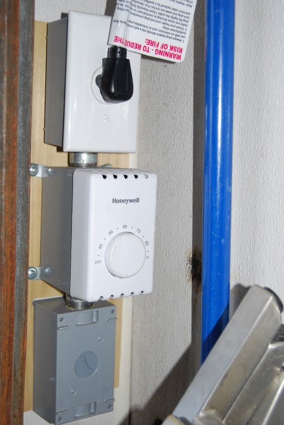

I set the thermostat for the heater in my truck for 70 degrees
