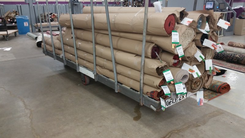

I'm looking for a HEAVY DUTY steel platform cart 8' long and 3-3.5 ft wide to carry rugs.
Haven't found anything of that size. I'm tired of repairing our old wooden cart.

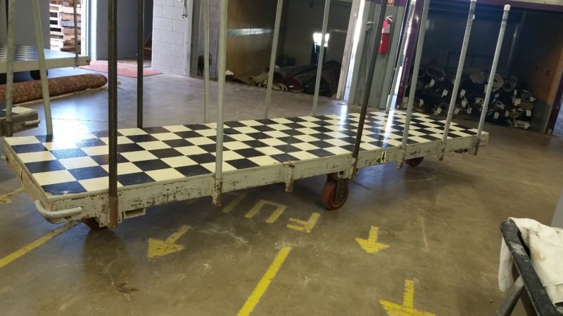

Something like this?
We have (12) of these 3' x 12' dollies and 3 smaller ones. We custom make them ourselves. I can get you plans if you are interested.

YES!!
That's perfect. What's the wheel system look like?

I'll get my guys to draw it out and get it to you tomorrow.
The wheels basically are: one wheel on each end that pivot, two wheels in the center that are slightly lower then the ends. This way the weight is always on the middle wheels and on one end or the other. The roll and pivot very easily!!
