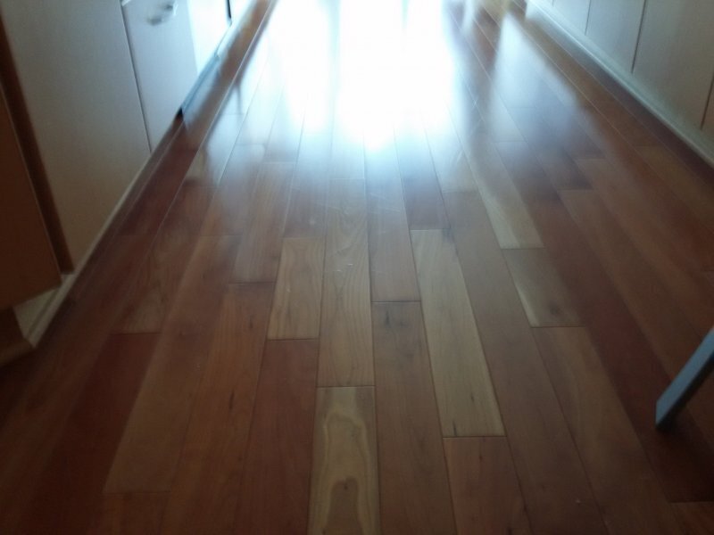

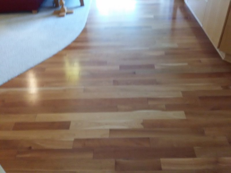

Customer has a Mirage Classic Wood Floor. Has scratches from German Shepard pretty bad. I'm not into sanding nor really have urge to.
Who has experience with chemically stripping?? With steel wool pads??? And maybe a Stripping gel???
She wants scratches gone and re finished. Doesn't necessarily want to sand or change stain color.

Call the manufacturer and question them first. Are the scratches in the finish or have they gone deeper? This might be one to hand over to a floor re finisher. Some of these guys do a good job at a price I wouldn't touch it at. BE CAREFUL this might be one you have to live with until they shoot the dog.
If you do as Ray suggest I would use a square scrub or rent one at home Depot ( Clark Square Buff Floor Sander) and use the maroon pad as it won't leave funky swirl marks.

If this is just in the finish the Hydro-Force wood floor maintenance and finish will work great. If the scratches go down into the wood, it is a job for a wood expert.
If you want to see videos of wood floor scratches being removed, it is on this page - http://interlinksupply.com/index.php?item_num=CW025GL
There is a chemical and extraction method as well as a mechanical method.

I'm NOT an "expert" but know enough about wood and refinishing to tell you It's not something you learn "over the phone" .
and Mrs Phiff's home ain't no place to "practice"
I'd suggest you partner with a pro refinisher in your area ...or you might be in real trubble on those floors if you start sanding/screening and applying finishes ..
in particular on that floor..cause it doesn't look too bad from the pics...be different if it was an old beat to hell, worn to chit rental they were just looking for "improvement" on the cheap
