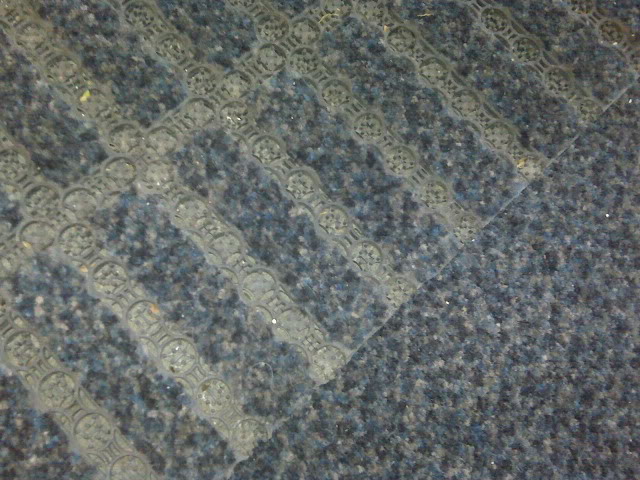

HELP - tricks to get commercial entry mat clean - see pic

I will post the picture in a follow up post to this one. It makes it easier when doing this on a blackberry. The problem:
I have an installed rubber and carpet mat in a building I clean regularly. The carpet always looks great but the mat keeps getting dingey. I can't form any sort of suction seal really, and was wondering how to get these clean. Does anybody have any easy ideas? They don't want me to take it up. (Its removeable carpet tiles). Lemmenowhachuthinkin. I'm at the biulding right now. Will have to clean that in another four hours.

It's a carpet tile system. The "mat" is aprox. 20X8 and installed... Not installed permanently, but not an easy task to take it out. As you can see from the picture, it is installed right in the middle of a large entry wall to wall carpet tile style carpet. The rubber is recessed and the carpet sits up a bit. The squares of carpet in these tiles are aprox 1 1/2 inches by 5 inches or so. Nothing you can really get a good seal on, nothing you can really spend the night prying up with a flathead screwdriver and cleaning tile by tile and then re-installing.
I figured I should just agitate the crap out of it before I clean it with the brush, but was unsure because of the uneven surface. I'll grab some more pictures for you guys next time I'm there. I won't take the picture with my phone either. Then you'll be able to tell what I'm talking about. Thank you all so much for the help. We are going to pick another day to deep clean that mat. We just did the best we could with what we had. We were having trouble keeping the van at a good temp. It was either too cold and frosting up or too hot and overheating and choking out with too much exhaust getting in the van. I couldn't find the right balance all night. This was a 12 hour job and it took 14 because of all the screwing with the truck... we simply didn't have the time when all was said and done.

You mean the turbo tile machine? How do you get it to form a seal on something so bumpy? Whatever I do, it has to be done in the middle of the carpeted floor.

Because its INSTALLED in the entry as the first thing people see in a prominant building that I ADVERTISE that I clean.
