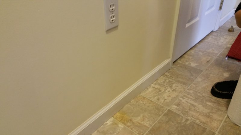

A day after we cleaned carpets & upholstery for this repeat customer (which they were very happy with), I get a text that says "Brian - please don't take this the wrong way! But is there anything you guys use to clean carpets that would eat through a a linoleum floor? I noticed a spot on the floor that's never been there before? Call when u have a second"
Hmmm, strange I know. We didn't even clean this entry hallway except to flat mop it on the way out the door when finished. I ask her to send me some pics.
The only chemicals used in this house was Bridgepoint Flex, POG Remover, Maxim Advanced and Avenge Prespray used on the furniture cleaning.
Now I know from experience none of these would harm or melt a linoleum floor.
So I stopped by on Sunday afternoon to check it out.

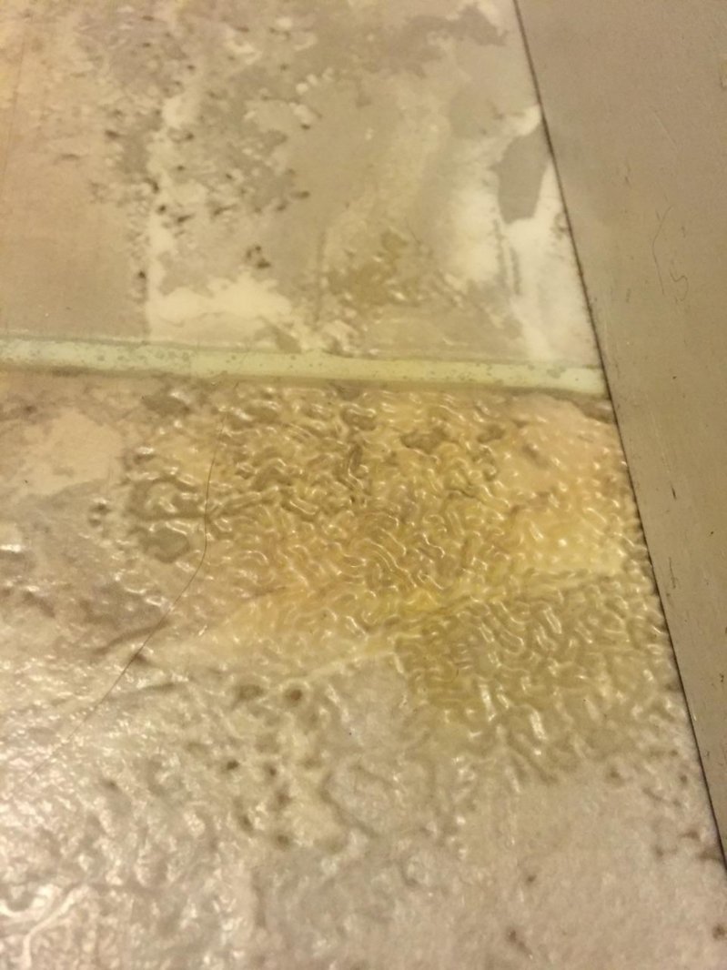

The spot smelled fruity compared to the rest of the floor. When touched, the top surface felt very rubbery and you could actually move it. A PH test on the spot was mild alkaline.
She says she cleans this floor very often and never noticed this discoloration before until after we cleaned the carpets. Her 5-6 year old son "out of the blue" says mommy remember this was here before they came. I had to chuckle but you know how young children are. Who knows.
The spot is directly under a wall outlet as you will see.
To help her understand our chemicals would not do this, I poured each chemical on the floor directly and let dwell for several minutes - no change which is what I thought would be the case.
She's not accusing me but in her opinion its rather odd that all of sudden she noticed this after we did the work.
I have a thought to what caused this but I want to hear from you. I'm pretty confident someone here has seen this situation before.
What do you think caused this?
I told her I would post this to the board and let her know the response from yinz all!

Does she use plug in deodorizers? The location of the spot under an outlet is a clue.
A spill from the perfume oil could account for both the odor and the color, though I'm not certain about the damage.
A well meaning (or guilty) housecleaner or family member could have attempted to clean up the perfume oil spill with "GKW"* and caused the damage, either because of strength of the cleaner, or the fact that it was left unrinsed on the surface.

i agree with Jim, I've seen discoloration like this under outlets on linoleum. but not the wrinkling. but i know some oils can degrade plastic and make them feel rubbery.

Yes !!!!!!! The min u said under wall outlet - I knew exactly what it was !! I was going to say it before I read Jims comment/suggestion !! He's got it !! I had a plug in deodorizer that dripped on my linoleum floor and it was dissolving it - made it bumpy, stretchy, gooie and discolored !! Listen to the kid .. It was there before !!

The plug in Scentsy candles can do that too. They are easily knocked sideways and I see it all the time on carpet too.
I would take a close look at the wall and top of that baseboard. Look to see if it was cleaned or if there is the deodorizer or candle on or even behind it.

Have seen it many times and it is a 100 percent a plug in heat deodorize unit, as Jim stated.
It has been there for a long time to get wrinkled like that.
They probably just noticed as their envirment was just changed by you cleaning and NOW they are noticing all the defects or imperfections throughout the house as they have a new expectation or realization of how their home should be.
They really probably never have noticed it until now, so to the homeowners "it just appeared" because of the change of consciousness as a result of your cleaning.

Without even reading any of the responses I thought right away: it's gotta be one them smelly-goody plug in products.
I see this all the time...and I have repeat customers with the same damage on carpets and so far nothing has worked on "getting it out".
I don't want to say they're lying about it being there because often they see things "stick out" a little bit more after the service is done. People tend to look more -for things- to make sure "the guys didn't miss anything".

"Before you were coming to clean I noticed a plug in sittin on the fish tank... Empty and not plugged into the wall! I never thought anything of it - I had one in the downstairs bathroom that I noticed is no longer there. I asked Matt (husband) and Trent (6 or 7 year old son) but they both said they didn't take it so??? I bet thats what happened. Apologize to the boys for me too. Thank You Brian - I gotta say I agree now (with the responses from Mikeys Board).....I wonder if Trent (son) accidentally did it and didn't tell me that one of the days surrounding you guys coming. Thank you for your help, Bryan."
Whew! The win here is that together we all saved a customer relationship from going sour. Kuddos to the MB Gang here! Thank you all!
