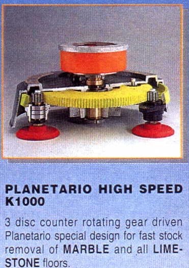

It's an attachment for a 175rpm buffer that has 3 4" heads similiar to a cimex or other stone machines. Though I intend to use for stone restoration, it can also be used for encapping. Thinking about 16 inch total.

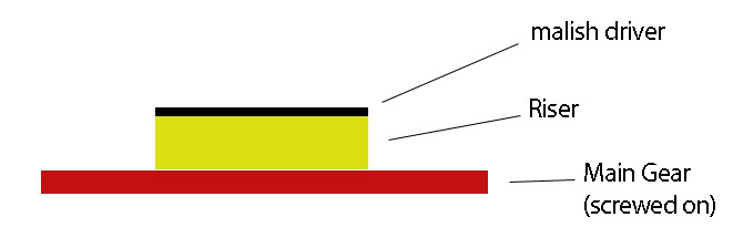

This pic is for one that's about 1000 rpm. Looking for something about 1-4 or 5. No idea what the best tooth angle and number of teeth would be. The middle gear can be some kind of plastic otherwise it may bog a regular 1 1/2 hp machine. I figure I can just screw the regular adapter to the gear with a plate and shaft in the middle. For this one maybe a 10" gear in the middle and 3 2".

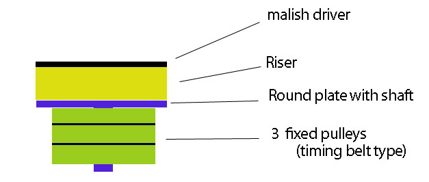

Here's one that I have in the 20" version. Sorry the pic is in the pdf file on the second p;age. Basically it has a fixed triple pulley in the middle with 3 belts.
http://www.onfloor.com/PDF/OF16INSERT.pdf
