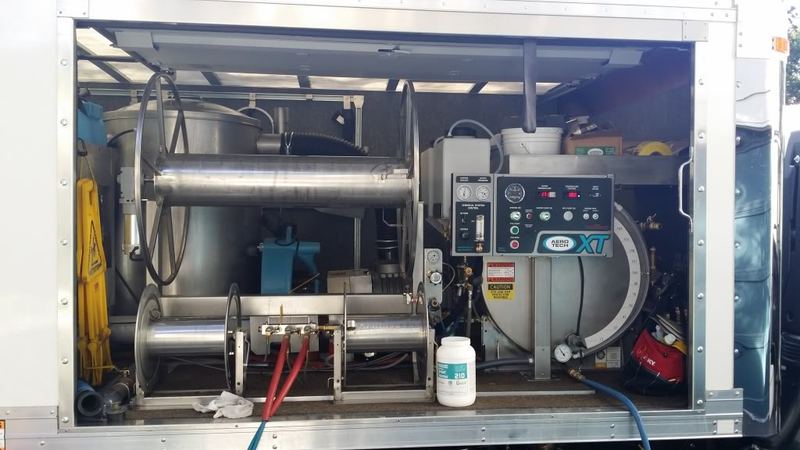

114,150
As you can see we don't over use our rinse.
One jug has the Magic Wand neutral and the other jug has the BP encap/acid rinse..
We can get ten or more average jobs from each jug..
