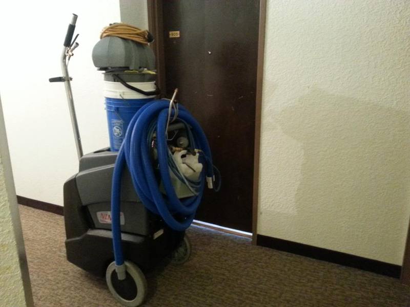

If it's a highrise- Portables.
I charge more than when I can do it with a truck mount, as it takes a lot longer. Though I don't know your pricing structure and what your market will bear.
If you're so inclined you can do the whole horse and pony show like Willy does. At least two vac motors- three stage each + heater etc. However that is very time consuming and requires more electricity.
I skip the heater but use the powerful vacs + pre-spray + high pressure rinnse. Works well for me.

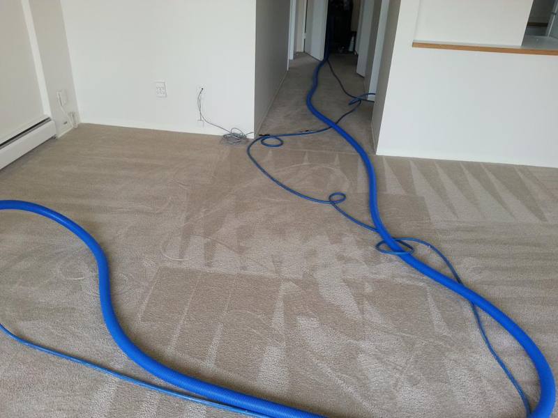

WAAAAAA! Geez, you guys make it sound sooo hard. It isn't.
First step is getting it all in one load. This is a 500 psi dual 3 stage, 35 feet vac, 50 feet pressure, heater, 4 spotters and rinse, hydroforce, and dual cord heater.
Next is finding power- machine cords to kitchen, one to counter other to stove, one heater cord to bathroom plug in, another to a wall. Very rare for me to blow a breaker. In some places I park the machine at the door in the hall and use one of the hall plugs.
Pull your hose away from the machine and get that area in front of it done first. No tripping over hoses or cords.

I agree multiple trips are just a time killer. 1-trip is our goal too but we have 2-techs so its a little easier. Although they aren't quite as motivated to use a portable as Willy is.
I could make a big ole long list of porty issues but I think the two that bother me the most is "Sound" and "altering the indoor environment".
Its loud and very annoying for the operators, can you imagine how the homeowners suffering though it.
Couple it with hot, humid, sometimes funky exhaust air and I'd much rather use OP if that's an option depending soiling level. :errf:

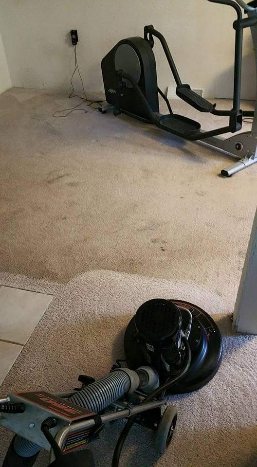

Compliment your porty with a small, lightweight Oreck Orbiter (I love this damn thing), with a pad/bonnet assortment, and you will be delivering great results every time, regardless of the condition.

Not too many units with an integrated hose, and that may only limit your choices.
Only ones I can think of are a few US Products (Those white ones) models that I personally would steer clear of.
Two extension cords and a solution line should be pretty east to attach, especially if the unit has a hose hanger accessory.
It's the placement of a coiled 25-30 foot vac hose that requires the figuring out.
Once you have your machine and the hose section together, it's just a matter of figuring out how to bundle everything together.
The trick is keep everything "thin" enough to slip through most standard lobby doors and to use a standard elevator without getting "hung up".
Entry doors to individual units are usually a tighter squeeze, but I never try to roll right in, but like to stop in the hallways, assess the job, and then bring in and place components individually. There is usually a lot less room to navigate once inside a occupied unit as opposed to common areas, and your less likely to damage anything.
At the end of a job, as each piece broken down, I usually place them out to the hallway one by one, where they are out of the way, and I have ample room to safely and comfortably package everything together and be out.
This can save a lot of time and frustration, and can help maintain at the least a basic level of sanity.
