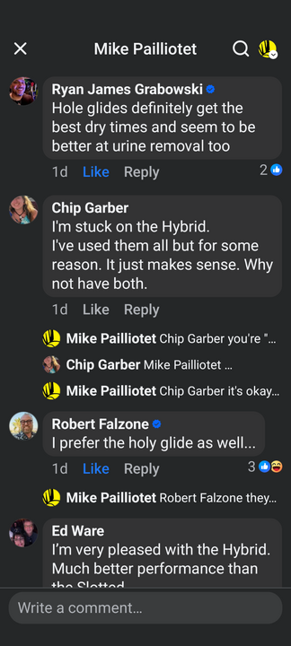

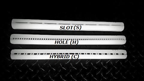

The groove is to prevent lines from the bridges and to create airflow at the end for better edge cleaning and reduce lockdown.
Many cleaners like the little bit of bite that the groove creates. Our grove is less grabby than others..
Try a glideless wand like a Prochem Ti or Quad sometimes, that tiny bit of grab is nothing...
My wand was cleaning great with the older style, had zero issues. Put the new glide on, felt harder to push than without a glide. Was told it would "break in" after 1-2 weeks...nope. Fortunately, was able to get the older style again. But, again...buying a glide should not come with a "little bit of bite", defeats the purpose of a glide completely.
28,275
The only time I notice that grab is on Berber or loop style carpets. Otherwise, it's great.
117,324
Everyone is different, some people prefer a little bit of bite or a lot of bite.
People with lots of wanding experience buy hole Glides if they want no bite, they don't buy the mini slots which you have there.
It's nice to have options but don't assume everyone is like you and their preferences.
