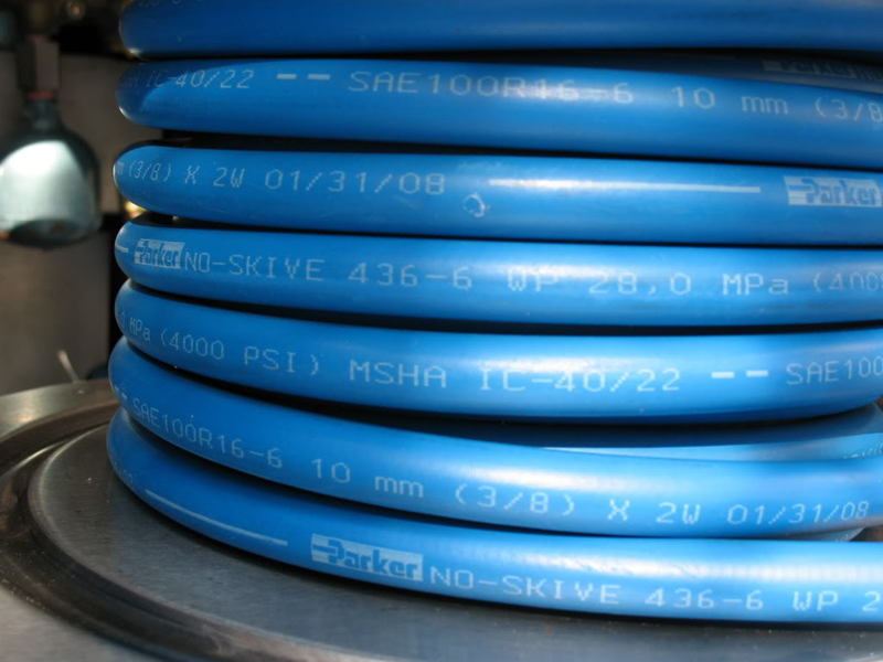

Greenie (well, Lisa really) was kind enough to send me a hose to try for them that was quite an upgrade from the 3/8" goodyear that came with the truck.
Parker 3/8" 4000 psi (a little overkill for a 3000 pump) - no problems at all so far.

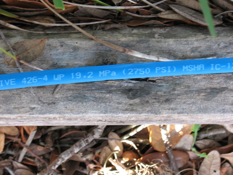

Parker 1/4" 2750 psi and 305 degree rated. Had 200 ft of parflex but I fried it one day when thermostat was at 325 before I realized it. Hose was smoking and not from the steam. Used it the next day and hand dozens of pin hole leaks throughout. It ain't cheap, but it better last.
