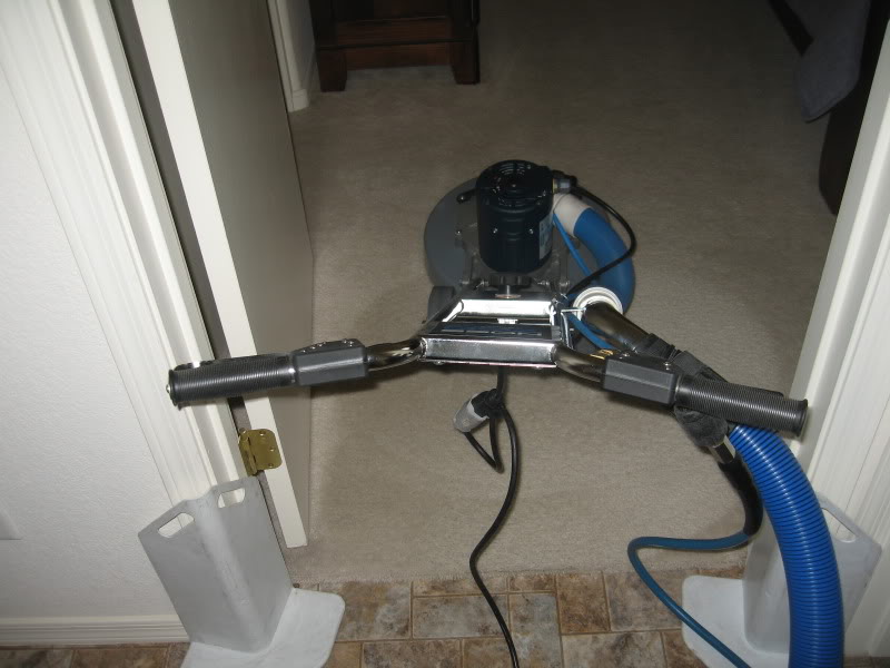

Handles are far too wide
The reason for the wider handle was in line with our concept to make the product easy for first time users. The wider handle is more in line with 175 RPM floor machines, burnishers etc. Since many of todays users come from janitorial businesses, or from institutional cleaning environments, we wanted to make the learning curve as simple as possible. The goal is to make it easy to clean carpet with great results. The HOSS does that even with a novice using it.

So let me get this straight, the handles have not been changed?
I could have sworn the units that Jim Bethel had posted a pic of had narrower ape hangers..

The handles have not been changed. As with all products evolution, who knows what changes a next generation of he HOSS will bring? We do listen extensively to users, and take into consideration the feedback posted here, because the real-world is the real deal. When the design and engineering teams sit down to consider changes for a next generation, whenever that may be, all ideas, input and feedback are considered, just as the current HOSS is what it is, based on "wish list" input from pros, looking at strengths and weaknesses of other rotary extractors on the market, and field tests input from actual users.

Even a Savant can be wrong, sometimes. :icon_redface: I stand corrected on the handle question. Mikey was not hallucinating when he saw Jim Bethel with narrower handles - on a HOSS that is. Of course, I never accused him that. :icon_rolleyes: I've just confirmed that the handle width has been changed. See, we do listen to your "constructive" complaints!

How wide are the new handles compared to the old ones? That was one of my main gripes with the Hoss. It was a huge pain to carry it up tight stairwells to the second floor.

as far as the handles......they are a pain at times to get threw a few door ways..but can be manipulated easy enough.....my problem is the vacuum hose hook up needs to be turned more at a down ward angle.......it makes the hose stick out past the handles..and that is harder to get threw a door then any thing.........I can start the machine and kick it to the right and get in just fine.....but with the hose sticking out so much....it is impossible to kick it to the left with out messing up the door frame........
