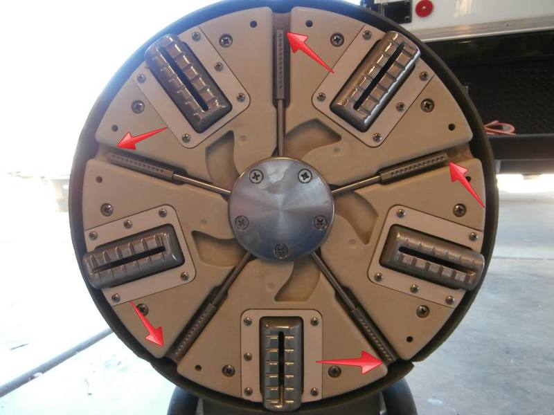

HOSS pros question for you
adamh
1,533
Nampa Idaho
Adam Hale
What disks? What spray bars? How is your set up?
Just picked mine up from Olsen today
Jim Martin
Arizona
Jim Martin
smallest disk..or go with a needle valve and remove the disk altogether...go with the staggered long bars...better coverage at a faster pace.......
adamh
1,533
Nampa Idaho
Adam Hale
I have no disk in and have added a needle valve. So one long bar then one short then one long again? Is that what you mean?
Fort Worth , Texas
We run no disc and all long bars. The newer blue housing and feed pipe Id is so much smaller than the original version that it controls flow just by restriction on itself. When we pull out the hoss it is to flush the carpet though, not just to say we are running a rotary extractor.
